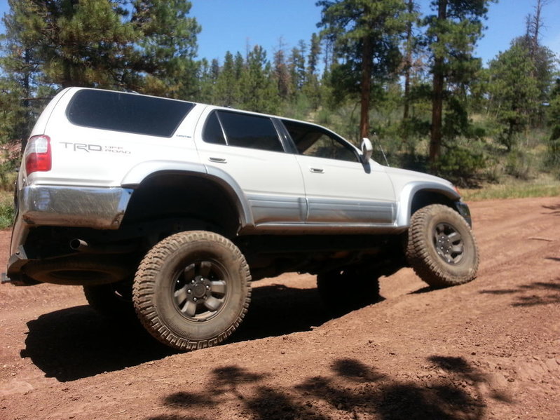

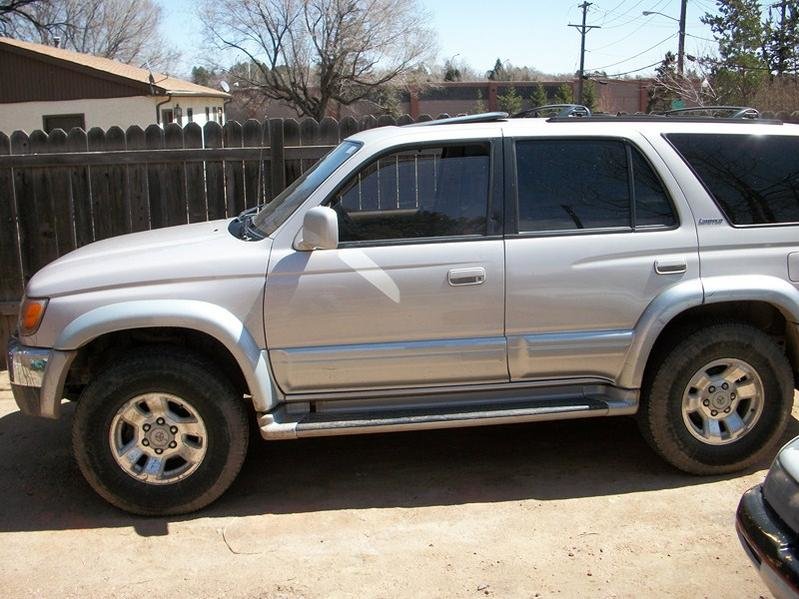

    Well I thought I would post a build of my 3rd gen 4runner. I bought it about 6 years back. Its a 1996 T4R Limited Desert Dune (no diff lock). It had about 186k miles and its over 280k now. It has done me very well so far other than a lower ball joint failure, fuel pump and radiator.
    SUSPENSION
    Front:
    SPC Light Racing Upper Control Arms
    OEM LCA w/ES Polyurethane Bushings
    SPC LCA cam bolts w/plastic sleeves
    OME 881 Coils w/SS 1" Custom Lift sleeves (3" front lift)
    Driver side Toytec 1/4" trim spacer
    OME 90004 Comfort Sport Shocks
    SS Tapered 1.5" Front Diff Drop
    Wabfab front sway bar quick disconnects
    Rear:
    New LC 7.5 wrap coils
    Driver side OME rear 10mm trim spacer
    OEM cone bump stops installed
    Tokico LC Shocks
    SS rear sway bar brackets
    4" Extended SS brake line
    SS Competition Lowered Bump Stops
    SS Adjustable Panhard Bar
    2nd gen Moog sway bar links
    TIRES/RIMS/BRAKES
    285/75r16 Treadwright Wardens
    1.5" Front Spidertrax Spacers
    OEM Satin Black 6 lug rims
    231mm 2006 Tundra brakes, OEM pads/shim kit, OEM rotors, Napa reman 13wl Calipers
    MISC.
    Custom 3" Short Ram Intake w/cone filter
    Evo 9 Lancer denso 190lph FP
    1.5" 4crawler body lift w/steering spacer, front bumper spacer, custom radiator bracket
    New Toyota Steering Rack and Pinion
    New Koyo A1998 Radiator
    Polyurethane rack and pinion bushings
    Removed front sway bar
    Replaced LBJ's, UBJ's, Inner/Outer tie rods, rear axle seals, f/r brakes, belts, hose, vacuum lines, xcase/tranny/rear oils
    JVC double din mp3 cd deck w/kenwood speakers throughout
    Satin Black Painted, grill, rear spoiler
    Satin black hood
    Pinch weld mod w/ trimmed flares

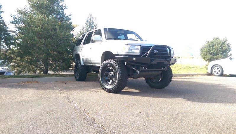

    Addicted Offroad Front Hybrid Plate/Tube bumper w/LED turn signals
    2x ebay 4" Cree LED spot lights
    9500lb Tiger Superwinch w/steel line
    FUTURE MODS
    HX35 turbo, cxracing manifold, downpipe, fmic, e85 fuel, standalone EMS
    Addicted offroad rear bumpers and sliders
    Rear Aussie locker
    New Rims
    Under armor
    Before and After pics follow.

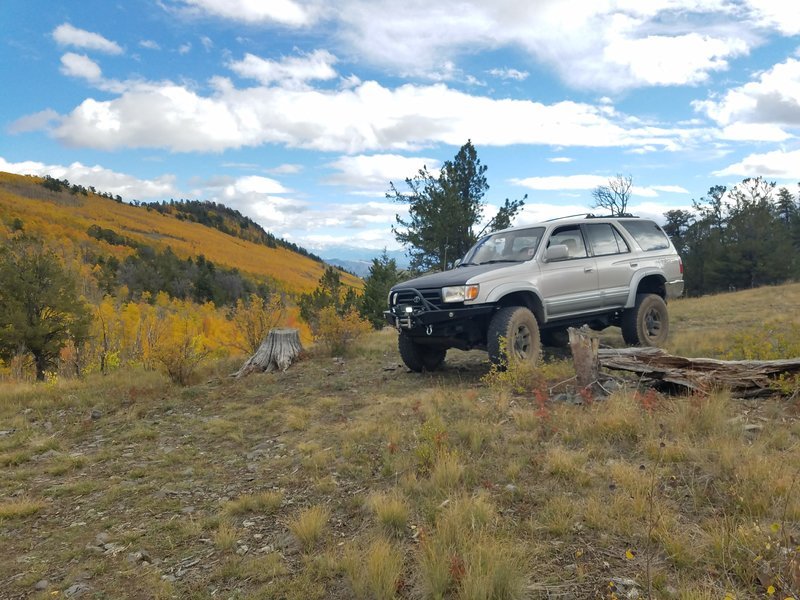

    Nice articulation & it looks good.

    Thanks. It does well on the trails.
