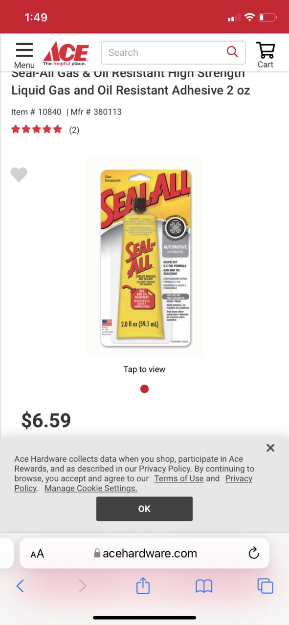

    I used this once to seal up a small pinhole in a diesel tank. Takes forever to dry if it’s cold out. I put some on the tank and found a scrap piece of plastic and glued it on over the hole. It held up for few months until we could get a new tank installed
