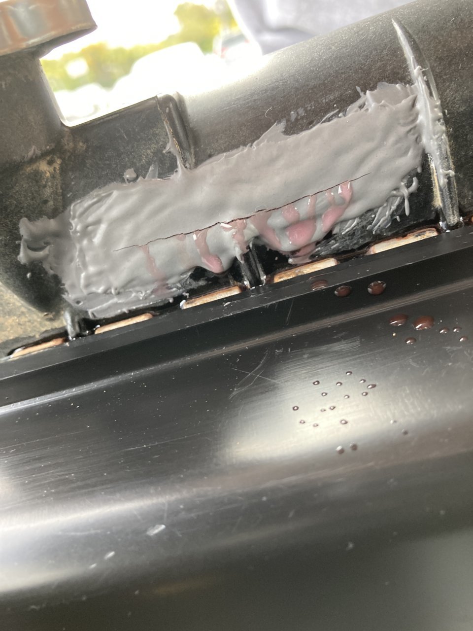

    Lol, this experiment is over already. Not sure if I mixed it wrong, using brake cleaner on plastic (even if I put on a paper towel first) or maybe something else, but it didn't work for me :(. Failed after the first trip. Looks like I'll be ordering a new rad since I don't want to mess with it anymore lol

    Usually with epoxy it’s better to do multiple thin layers and prep in between - look up surf board repair. Looks like you might have too much hardener or not enough.

    Yeah I think I put too much hardener in. I should have been more meticulous with mixing it. I didn't think I was THAT far off on the ratio. Could also be the white balance on the camera :notsure:

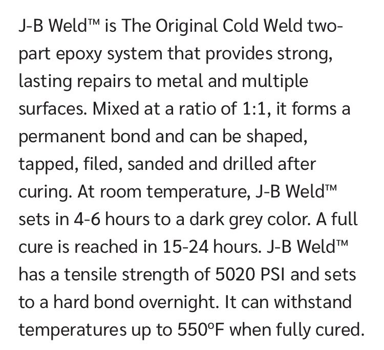

    It's not that we are worried about the JB weld going, most of us (definitely I) know that JB weld is rather for pressure ratings that far exceed 16 psi, it's that we are worried about the spot of the crack expanding further after the fix.
    It's a crapshoot on if it (the radiator, not the JB weld) will hold long after the repairs or not.

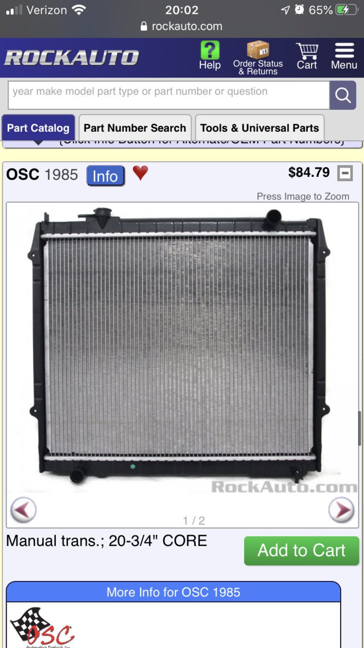

    I'm just now starting my search but it appears that the factory part is either way too expensive and/or discontinued, I'll try rockauto

    #17473
    10,042
    Mitchell
    Nashville
    1ST GEN OR GTFO
    Toyota NERD
    Got the OSC part off eBay for $96 total, we'll see how it goes
