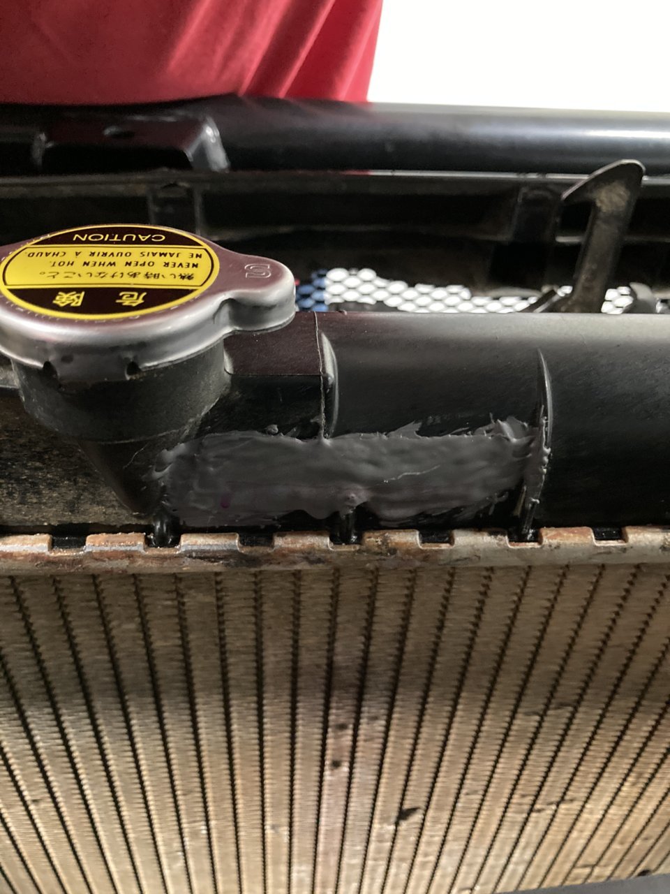

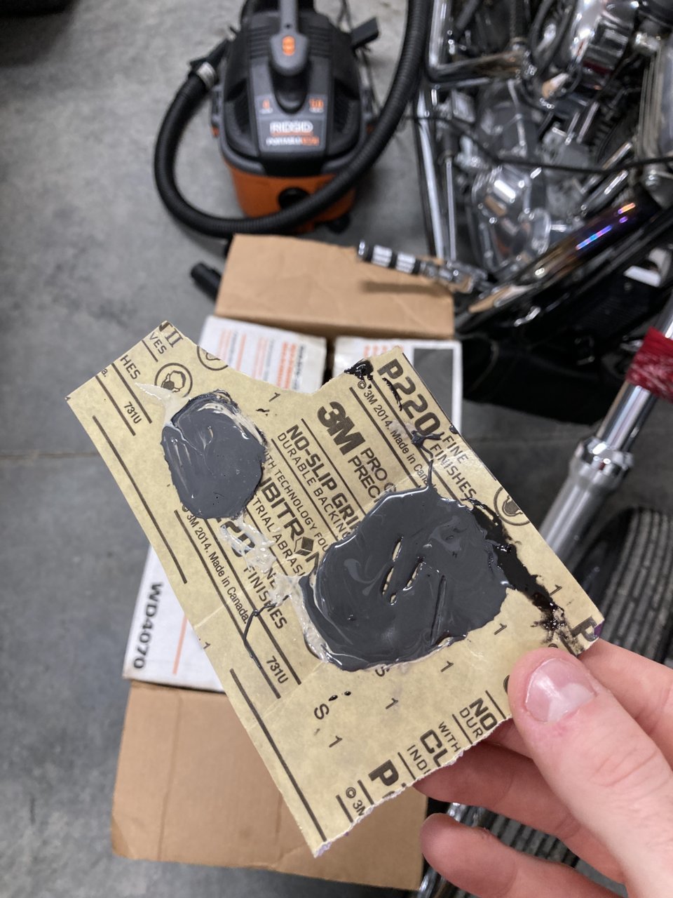

    That doesn't look like jb weld. It should be a dark gray when mixed.

    The white balance on my camera is fooling y'all.

    Yeah color can't always make for good inspections over digital screens. The consistency looks too chunky and too much like fudge which made me think your mixture wasn't the proper ratio that looks more liquid when properly mixed.

    I was also using a plastic butter knife so take that for what it's worth :anonymous:

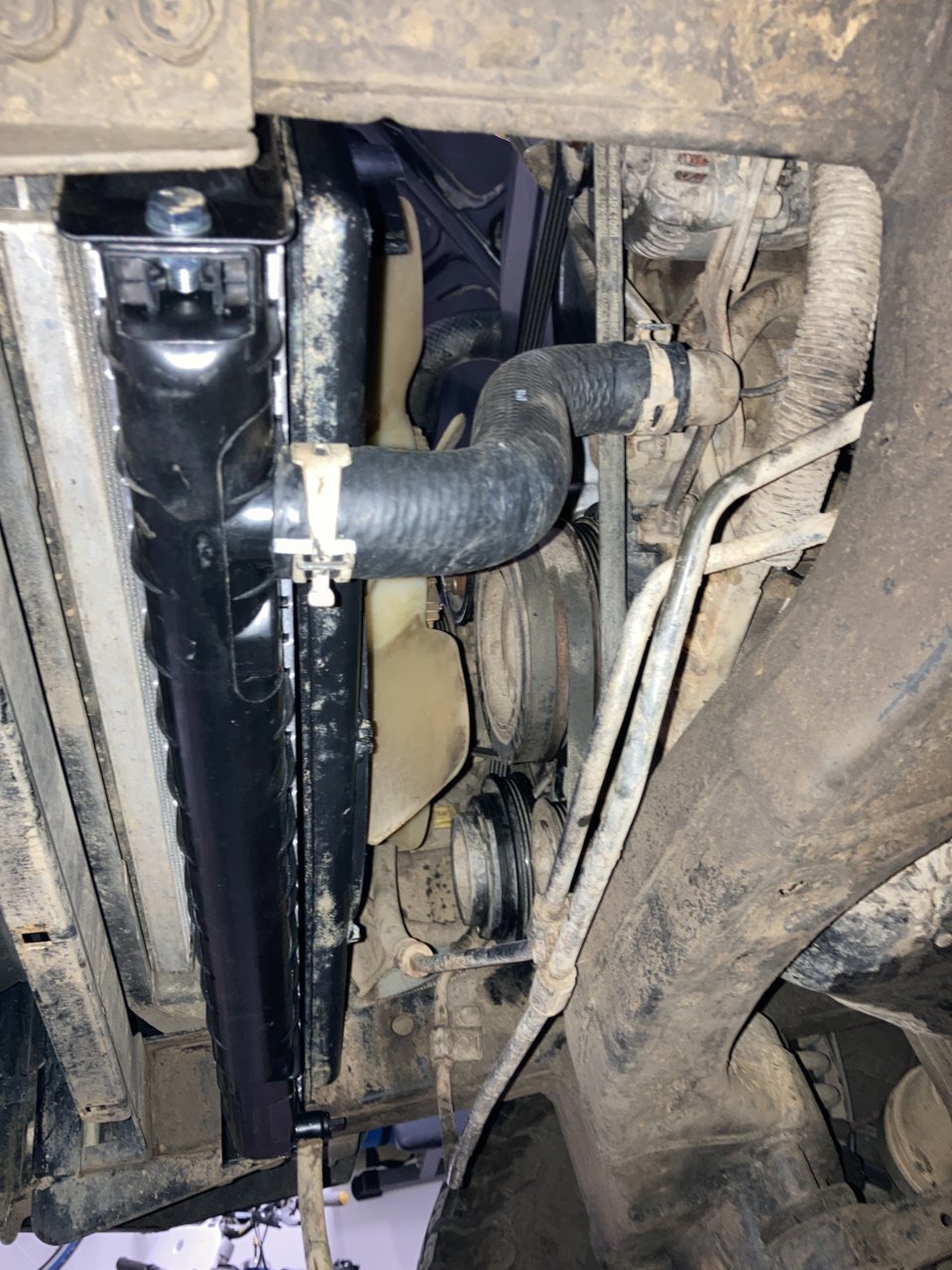

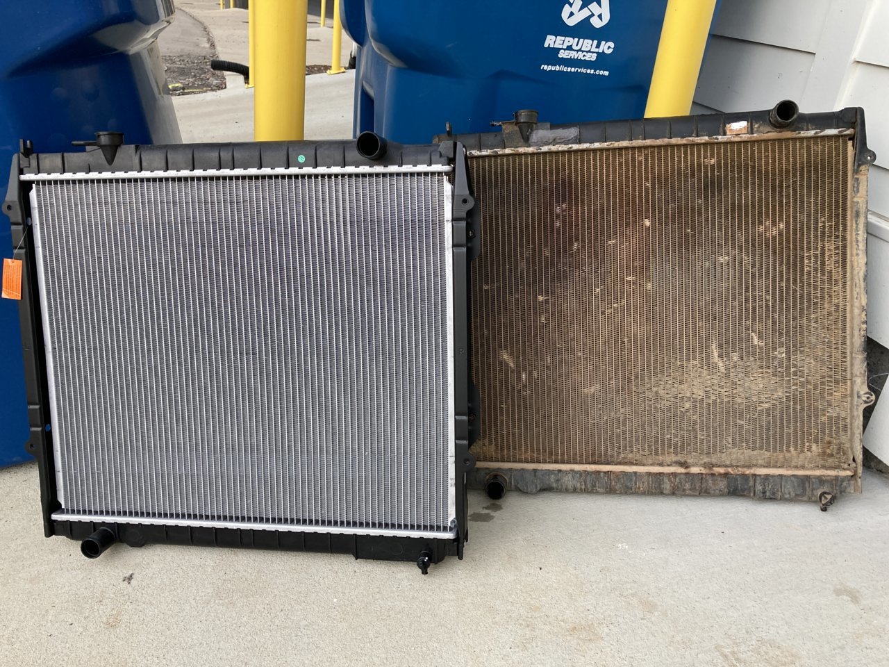

    all fixed up! Bought a new lower rad hose while I was at it. The upper hose is still fairly new.

    it's so crazy hearing stories like this but in my situation is was a very quick fail. Yeah I'm glad I replaced it, all in all, the whole swap cost me maybe $190 (new rad, new coolant, distilled water, lower rad hose)
