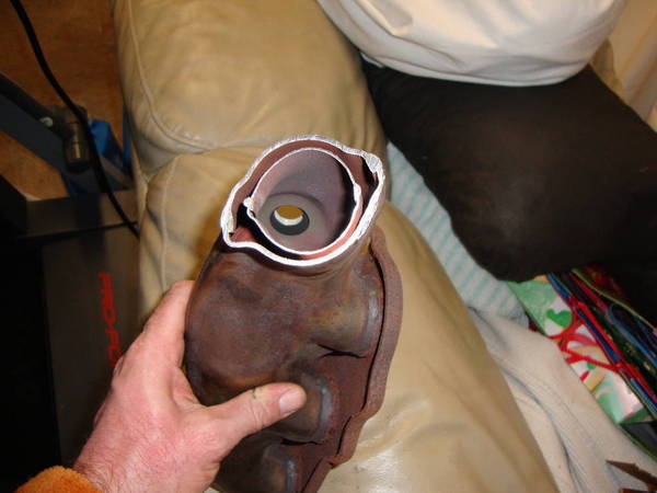

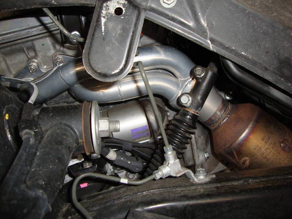

    As you can see the header welded to the cat
    It's also in the JBA instructions, which you can download from the JBA website. I would have them fix what they did. Did they give you your old cats back? If not they totally screwed you over.
    Not sure on the HP, but your set up seems like it's already loud. You will have some gains in HP.
    The outside pipe on the stock manifold is 2 1/4" and the inner is 1 7/8", so you'll have less flow restriction if you get a good fabricator to do the work. The pipe going into the cat is 1 7/8" and the JBA headers are 2 1/4". Big difference in fitment.
