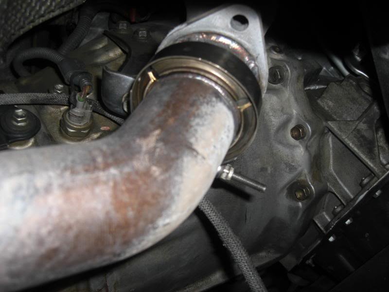

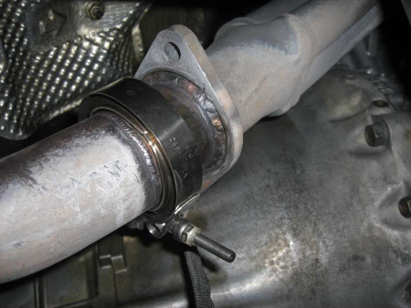

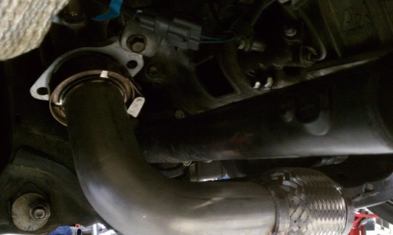

    Here is a link to V-band flanges. For the header to y-pipe connection, you will need the 2.25" diameter v-band flanges.
    http://www.dezod.com/pd_stainless_steel_vband.cfm Tell Paul that Torspd sent you, if you decide to go that route.
    They will be $74 for each flange assembly. The assembly is one male, one female, and a clamp.
    They will have to be welded in. I can post up some pics of mine, in a short while.
  8. Jun 15, 2012 at 7:27 AM
    Torspd
    Torspd Tor-nication
    Sep 18, 2009
    #22958
    26,446
    Tor
    The Great America!
    MMVI 4.4L 4x4 Access Cab
    Torspd Custom Turbo kit [] Borg Warner 9180EFR Turbo [] Haltech Elite 2500 [] TiAL Q BOV [] TiAL V44 Wastegate @ 15psi [] CP Pistons [] CP Carrillo Rods [] ARP Head studs [] ARP Main Studs [] ARP Header - Head Studs [] Ported Heads w/ 1mm oversized valves intake/exhaust [] Brian Crower Forged Stroker Crank [] Darton M.I.D. Sleeved Block [] Kelford Camshafts [] Torspd 160* T-stat mod [] APR Large Fuel Rail [] Walbro 460 LPH E85 Fuel Pump [] FueLab FPR [] APR T56 Conversion Kit [] KP RACING Built T56 [] McLeod Racing Custom Twin Disk Clutch [] One Piece Aluminum Driveshaft [] MGW Shifter [] Custom lowering kit [] Ohlins Front Coilovers [] QA1rear shocks [] Custom Ron Davis Radiator [] Dual SPAL Electric Fans []
    Here are a few pics of how I had my V-Band flanges installed.
