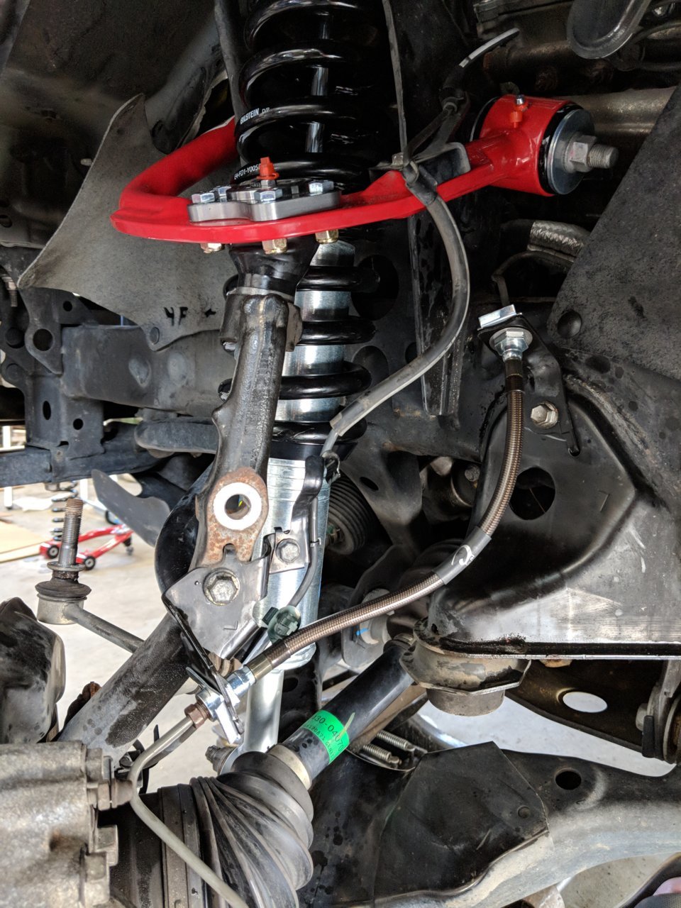

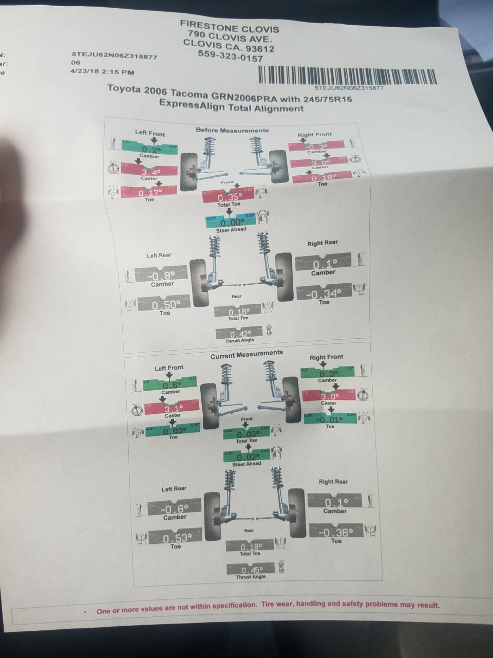

    After i got my jbas on i Did a self alignment at home but wanted to double check and make sure I was right, did pretty good for just using a digital angle finder and a peice of metal20180423_144639.jpg

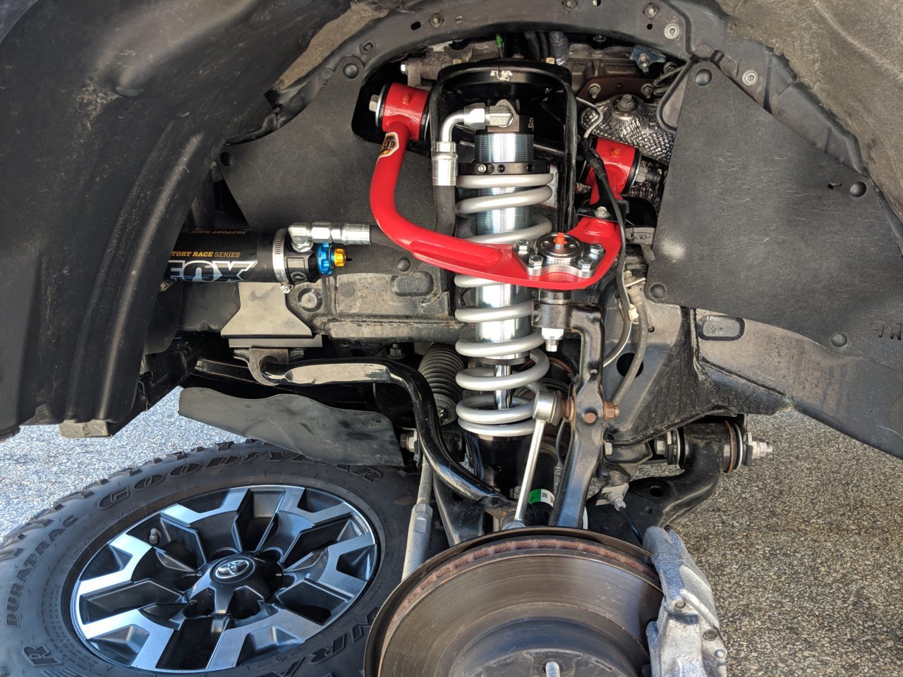

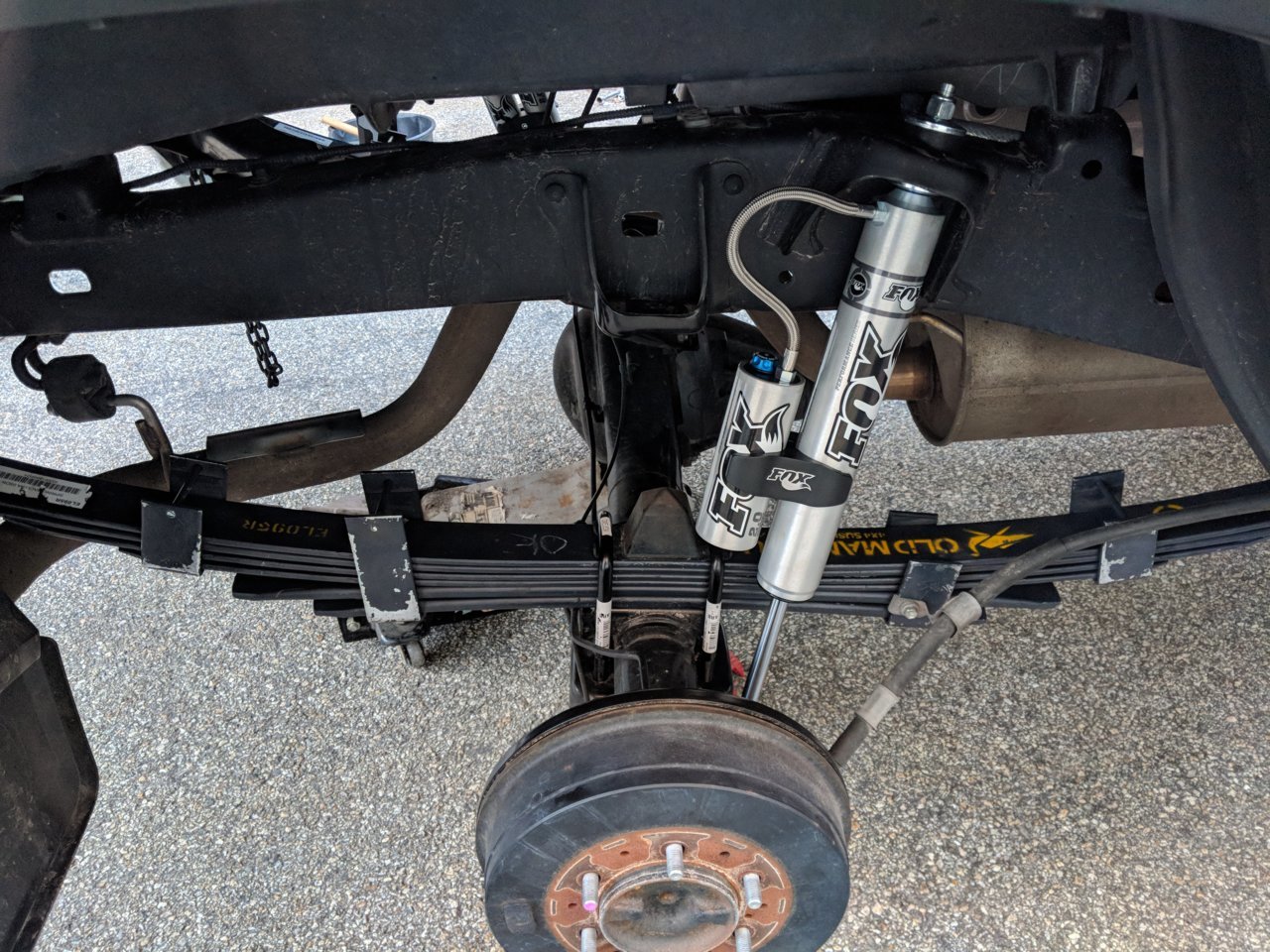

    Did you grind off some of your rear shock mount? If you didn't, you need to or that hose will break the first time you wheel it.
    Also get rid of your sway bar! Good looking setup

    Looks like the main body could be rotated outwards while leaving the resi in the same spot and that would make it clear

    Nope, tried it, it turned right back and snapped lol. Fox is literally rebuilding my shocks right now because of this dumbass design.

    Well that's dumb! So they're asking you to grind the mount as well?

    Apparently. I had to fight with them to get any of it warrantied too. They ended up paying for half of the rebuild and the return shipping. I asked if they could put the 90 degree connectors from their 2.5 rears on which would solve the problem, but they said that would make the shocks a 'custom product' and they wouldn't be able to pay any of the warranty.
    Pretty stupid.

    Thanks for the heads up. I'll probably just make a split clamp with a keeper tab instead of cutting.

    @Jibbs any issue with the hose roated out to the shallowest point in the bucket ?

    I'll have to pull a few leafs and check it out. I'm thinking I'll rotate the fitting out but still have the reservoir inline with the frame and just take a tube clamp to index the body of the shock to the bucket to prevent any accidental rotation.
    Thanks for the heads up guys. I've read about it before and had forgotten about the issue.
