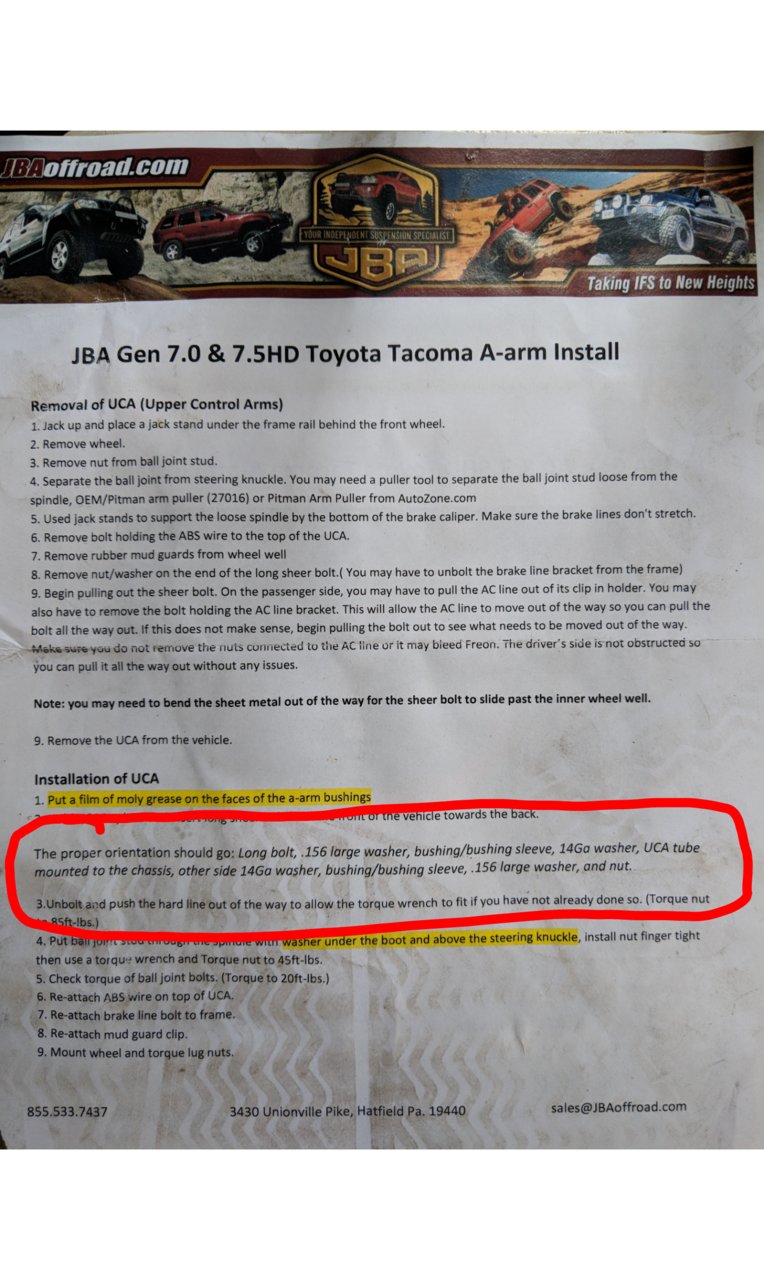

    Mine were tight too using the thin washers in the middle. We ended up using a pry bar to make it easier and everything went together easy but with 2 people. I could see where one person would have a hard time with it. Also I've read the different ways for the washers and I used the thin ones in the middle and the thick ones on the outside. I didn't reuse the factory ones on the outside. That's how I took it from the instructions.

    The instructions have a fairly clear layout of the washers, skinny inside-fat outside.

    In the Navy they taught me skinny outside, fat inside. Forever stuck in my brain.

    Deff took me a flathead I use to spread 300lb flanges, a fulcrum, and a second set of hands to get mine in as well. Had to pry to even get the first one in.
    She good now though.
    Blackout14 likes this.

    Haha literally first post that shows a different washer set up.
    When in doubt though most do follow the instructions I'd assume.

    Alright TW. I messed up, put the thicker washers on the inside instead if outside... took some serious prying but got them all mounted. Will this cause a problem? Should i reinstall with the "thicker" washer on the outside and "thinner" washer on the inside? I agree wording should be changed but i own my mistake.
    Also, whats up with the nylock balljoint nut eith no hole for a cotter pin at minimum. Is this really safe if torqued correctly? I have never seen a balljoint nut non castle style.

    Welp, I just fixed it anyway... no worries. Did some research on nulock nuts... case closed.

    So me and a friend put these on my tacoma about 3 months ago. We tried tried to get the inner washers in and there just wasn’t room so I only have the factory washers on the outside. Seems fine so far I’ve even driven across the country like that but I just want to make sure this isn’t going to actually be a huge problem in the future? Safety or wear on the uca
