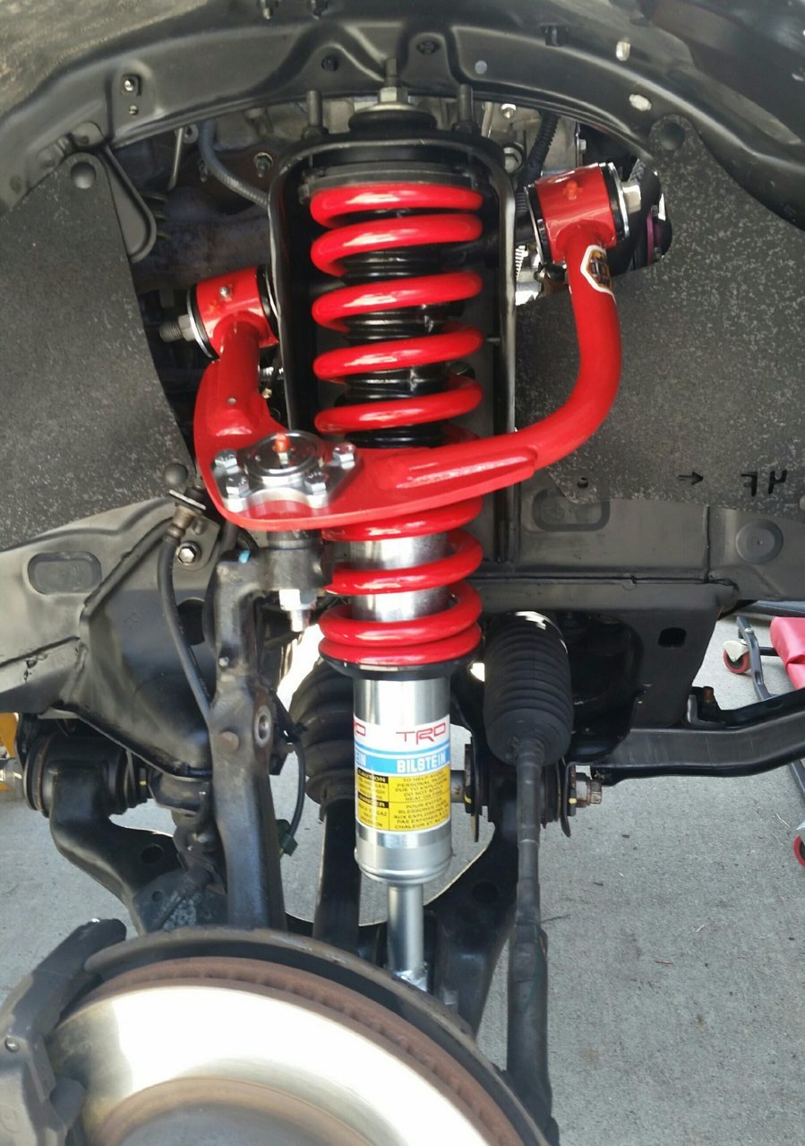

    Front suspension tear-down was a success! JBAs sitting pretty. That UCA bolt was a pita, but there's a finesse to it. Anyway, I was able to get everything installed however I was not able to add any grease with my grease gun, every time I tried to get a firm seal, the grease would just push out the side. Anyone else have trouble? I think it might just be my 20$ gun.

    All that red looks great!
