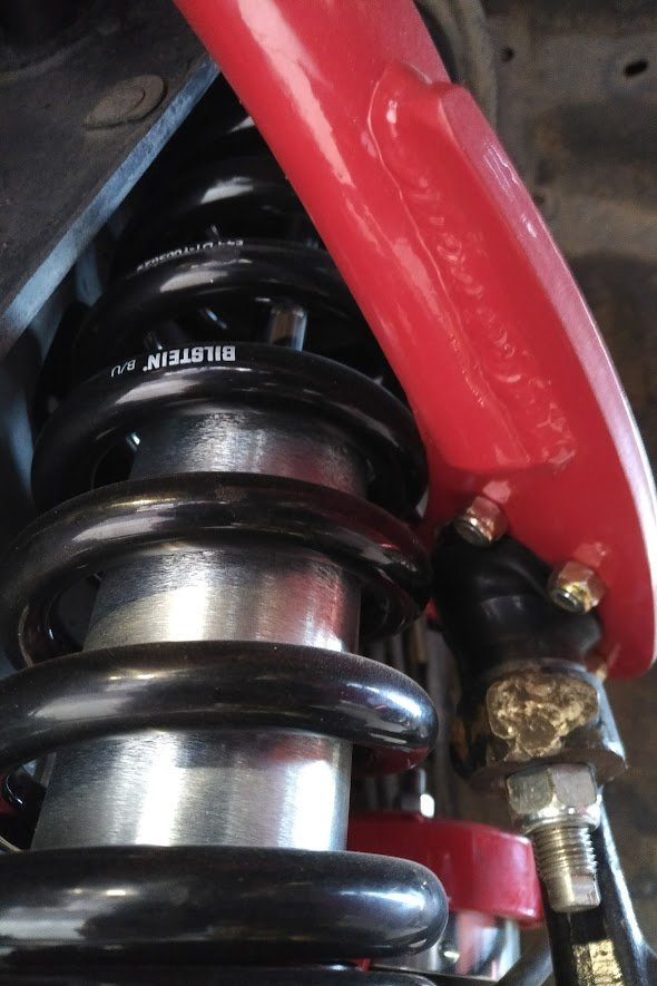

    Anyone else with 6112's having coil contact on the jba ball joint? I need a pretty quick solution and would like to give them a try. Currently sitting on a set of True Travel Dynamics uca's that are junk

    I have no issues with that. :thumbsup: I am 2nd gen., but I don't think it would be much different for a 3rd.

    I'm running the Baja kit which is pretty much the same as the 6112's on a 3rd gen and ave no issues.

    I have the TRD pro kit, which is the same also as the 6112s with JBAs and have encountered no issues since install. I'd try cycling the suspension for droop to see where you'll end up in terms of UCA travel. There are a couple scenarios to think about, 1) if your ball joint runs out of angle before hitting the coil, 2) you droop out the suspension and the UCA contacts the coil. In either of these scenarios, limit straps are necessary to solve the problem.

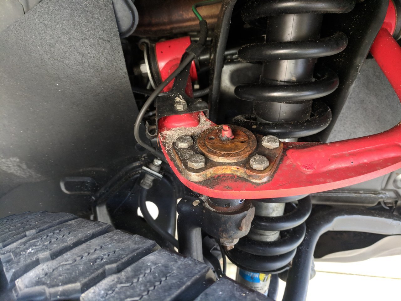

    Yep, sand is always sitting on them after my beach trips. This was after a 3 day trip before she got hosed down. Once they started to rust I bought some oil based under carriage protectant that seems to work well but it was too late at that point.

    I'm hoping neither of those cases, but I don't know until I get them and installed. Really not looking to run limit straps on a bilstein shock. Have them set on the 5th notch and 1/4" spacer on driver. Gonna pull the trigger tomorrow regardless just to have them by the weekend for install
