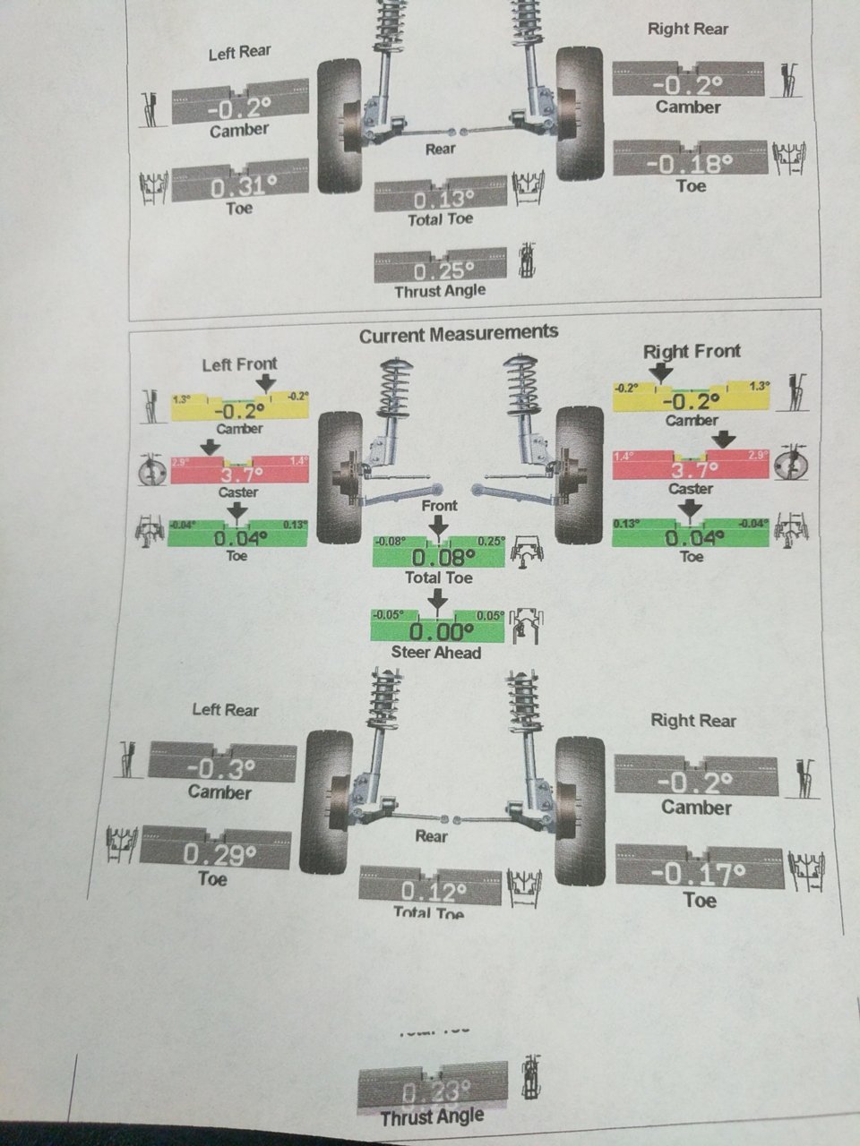

    Seems low. Back to rubbing at lock in reverse.... But the professionals know best, right!?

    It is low, needs to be at least a degree higher on caster

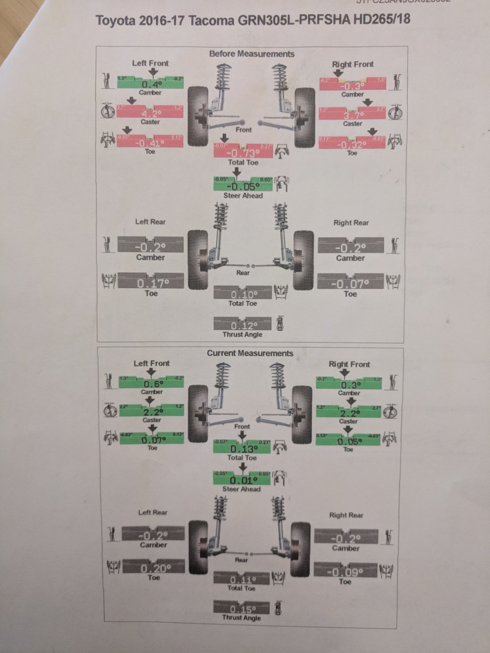

    Took it back to Firestone. They did better this time.
