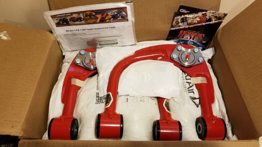

    That purity sir!

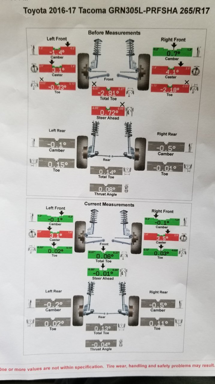

    I had mine installed on Saturday along with rest of the suspension. :bananadance:
    I'm still trying to figure out the right ride height... for now I had to take care of the alignment, and those are my numbers:

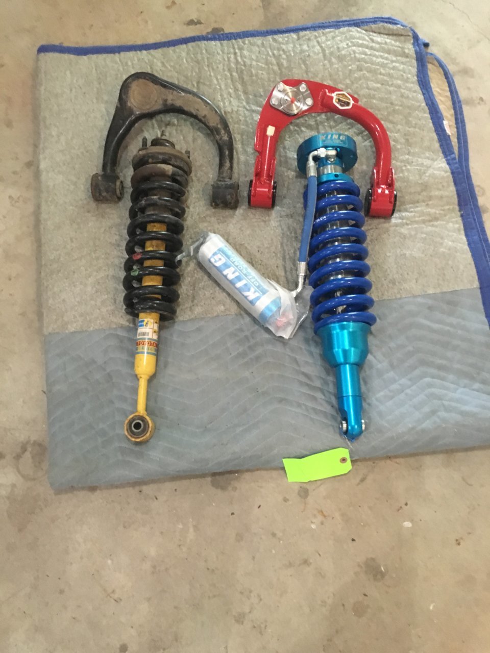

    Sorry if this has already been asked but I'm not looking through the whole tread. Does anyone have a picture of the JBA's and OEM side by side on the ground so I can see if you gain any room behind the oem ball joint. Admittedly I run a lot of lift, more than folks on here are open to, never the less with my current setup the oem ball joint is actually sitting on the coil and limiting down travel as well as killing ride quality. CV angles are acceptable so I'm not worried about that and I need to be at the height I am to clear my tires but the current situation isn't cutting it.

    Maybe that helps.

    Just going out on a limb, but maybe this is why people don’t run more than 3” lift without going drop bracket or spindle lift.
    Edit: never mind, I just hopped in your build thread. Good luck on your future endeavors.

    Perfect. Looks like there’s definitely some more room back there.

    Yea I do have the drop bracket but even that I’ve stretched out. It’s a 6” kit but it’s up to 9”-9.5” so I’m right back in a bind.
