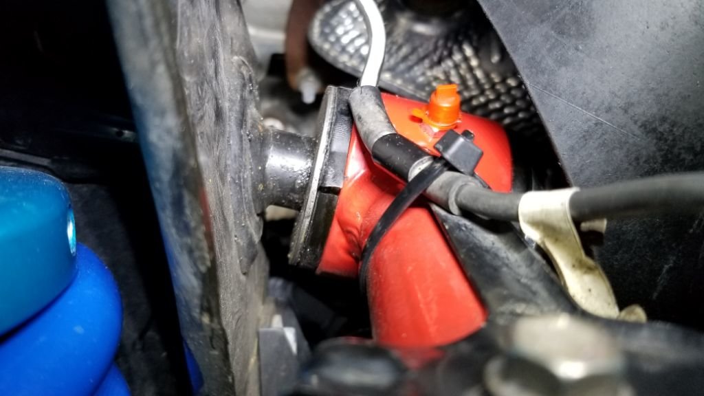

    Now I might have a bigger problem, which I didn't notice a few days ago when I added a few pumps each of grease.... Here:
    One of the bushings is torn. Found it today. Not sure if I broke it adding more grease, which BTW didn't come out the way you said it should..
    Not happy about the situation, but hey, it is what it is.

    I wouldn't worry too much about it. I've heard nothing but good things about him and his service. Poly bushings are affordable worst case scenario. Btw oem poly grease is always superior to pump grease fyi
