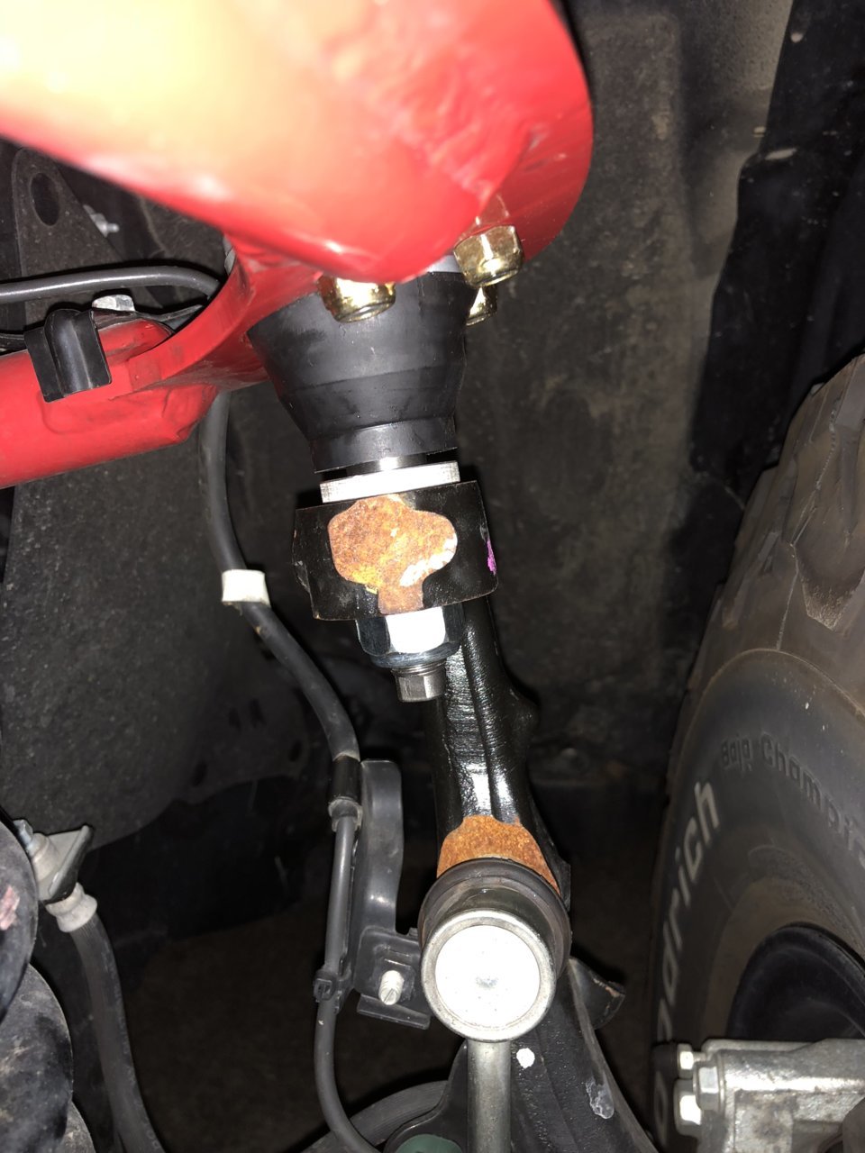

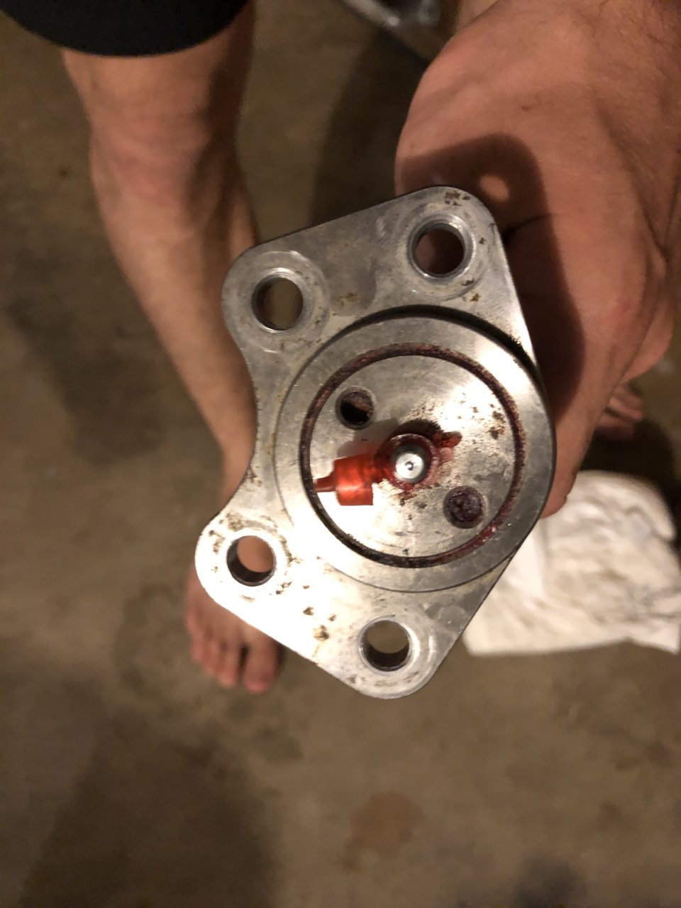

    So I was getting some rush on the ball joint housing of my JBA HD UCAs. They were only a few months old so I contacted Marlin and he set me up with a replacement pair. Normally I would through these on myself but I haven't had the time. I dropped it off at the shop and hour ago and just got a call from the mechanic saying the shaft of the bolt on the new ball joint does not fit through the hole on my spindle. Has anyone had this issue before? I emailed Marlin and am waiting for a response but I figured I would ask here.

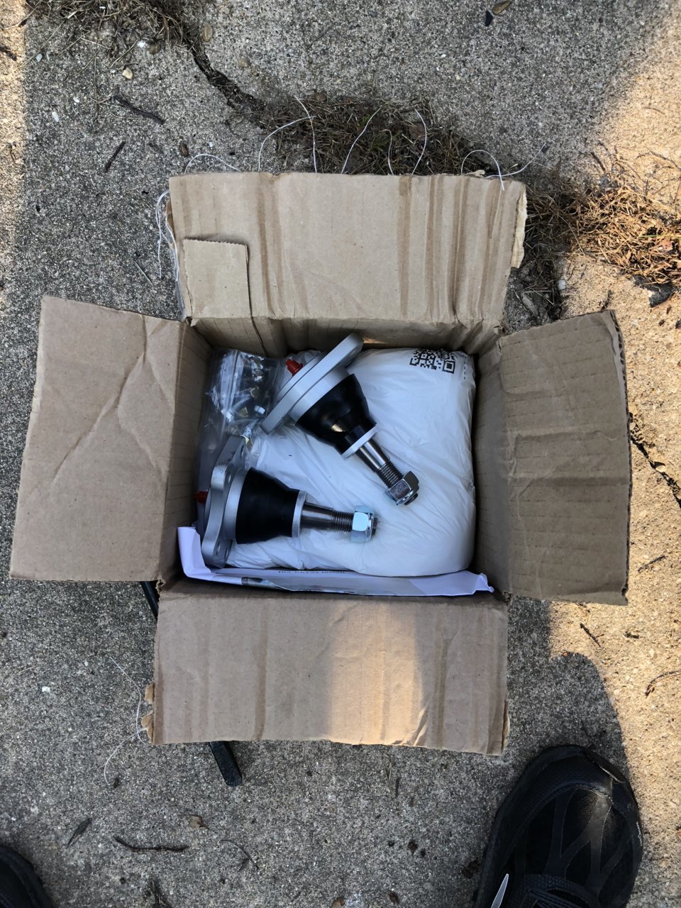

    I talked to Marlin and he is dropping another set in the mail tomorrow. Looks like it might have been just the wrong size stud. I will be putting them on myself this time. Once again outstanding service from JBA.

    Well marlin got me those other ball joints ASAP. Put them on in my driveway in 45 minutes, too easy and convenient. Compared the ones that the mechanics could not install with the old ones on the truck and saw absolutely no difference. So this whole issue was due to the incompetence of some mechanics and probably could have been avoided if I had put them on in my driveway from the beginning. Now I’m out the labor and most likely the other ball joints considering they tore them all up trying to put them on.
    New
    Old ones
    I am guessing the gap the mechanics were talking about is the one between the boot and washer when the boot isn’t pushed down.... as seen below.
