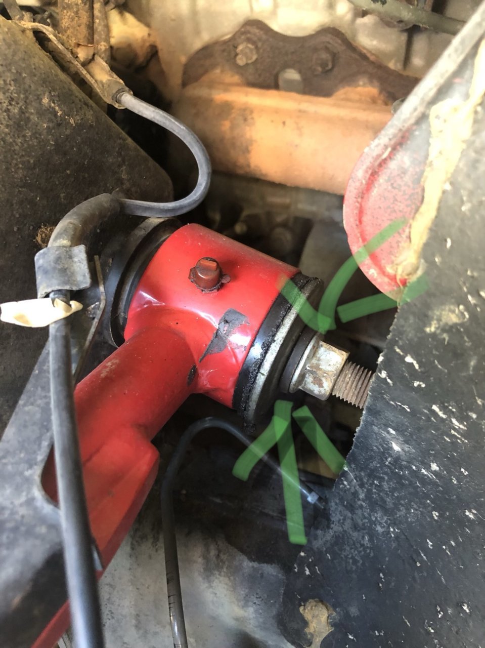

    So I put in the new upper ball joint from JBA. It’s not my problem. There is still play. The play is coming from the long upper control arm mount bolt. Can I buy this bolt?? What’s the best way to approach?

    I don't see a inner washer between the bushing and the center thinga ma Bob .

    Thanks...just went out and found it. Any idea what size washer to get? I can just call Marlin tomorrow.
    The pic is from the good side (no play) with washer.

    Why does it look like there should be a washer holding the bushing in on the insides of the arms closest to the strut tower? What is keeping those inside bushings from coming out?

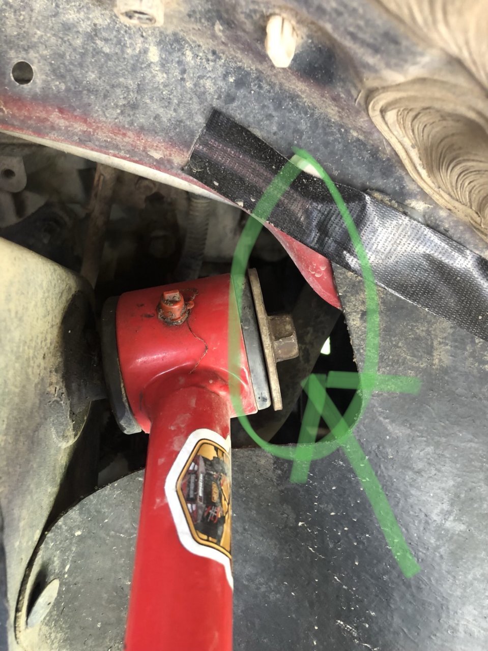

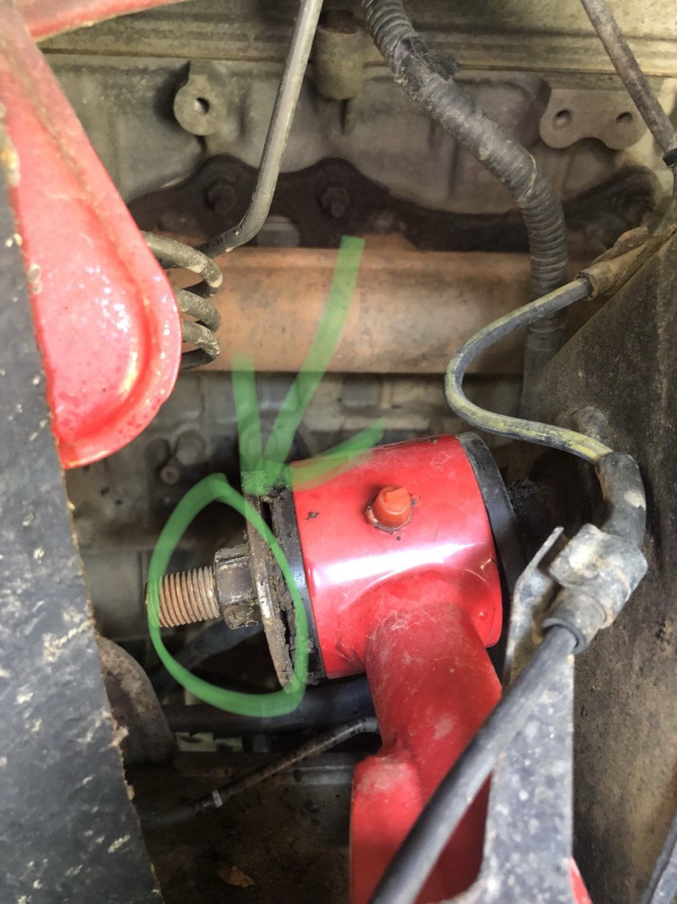

    There should be one. I didn't put one in and my bushing started sliding out20180816_211502.jpg

    :notsure: Mine was never supplied with inner washers so I just went oem style and only have the outer two. No issues yet and I just rechecked the other day.

    Yea, I see the gap.
    So pumping grease in doesn't force the bushing out? And honestly, looking at the photo I'm not sure what would force the washer against the bushing anyway.

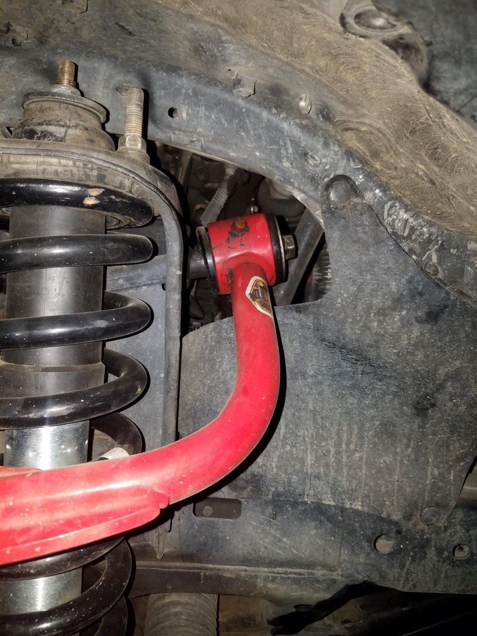

    So what kind of bushing or washer would this be? I want to attempt to fix this today. My inspection is 15 days overdue..so need to get it done.
