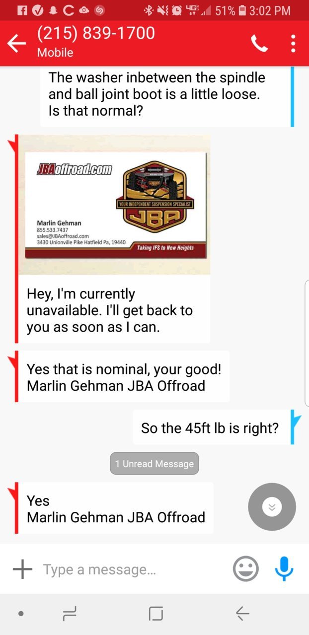

    Np. I was curious as to which one was correct so I contacted them.

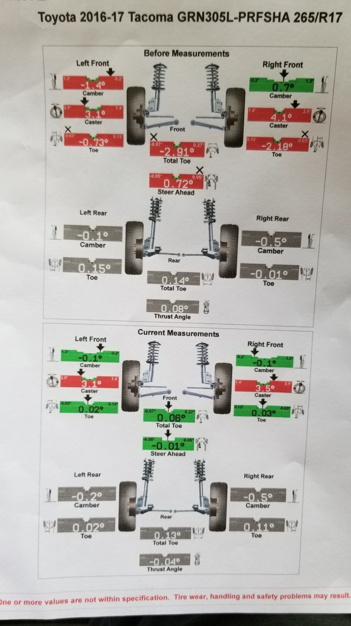

    Not sure if that's going to help you at all, but those are my numbers
    My truck drives quite well, and straight on the highway. Of course ymmv.

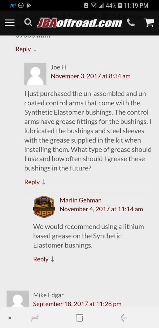

    Going to be installing my uca and lift next week. I know I saw it before, but can't find it now. what grease do I need for the bushings and ball joint?

    According to their website, a Lithium based grease.
    Edit. There is one example in the links at the bottom of the page. People also talked about Red and sticky... (or tacky)
