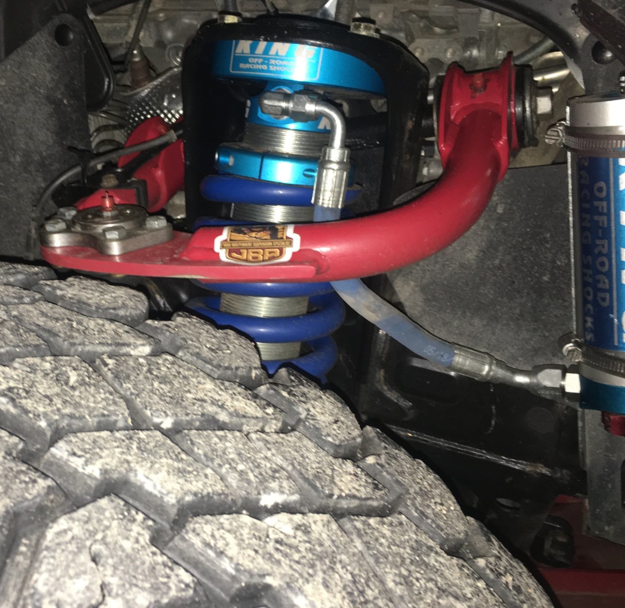

    You can see where youre rubbing on the uca. I was rubbing in the same spot and corrected it with a set of .75 BORA spacers.

    Thanks. Did you have to trim wheel studs with the .75?

    I dont have the jba ucas.... but yes, with the .75" bora spacers, the studs will protrude a lil bit and wont be flush. Go to 1.00"and you will clear. Thats my experience.

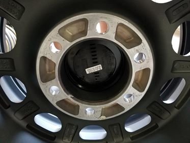

    No I didn't have to do any cutting. My Methods have relief cuts.

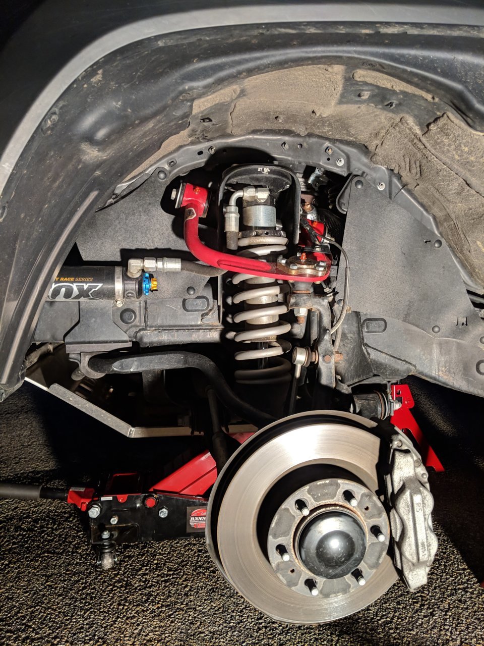

    About halfway done...
    @Hilborn Do you happen to know what backspacing your wheels have?

    4.75

    Excellent, my wheels measure around 4" of backspacing. So I think my 285/75R16 GrabberATX will clear:fingerscrossed:
