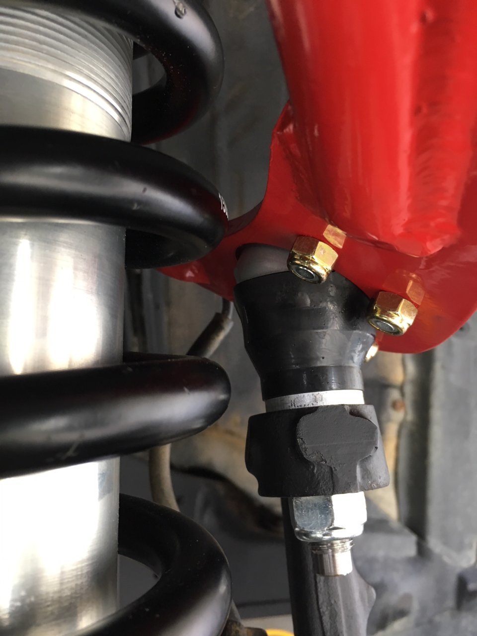

    JBA UCAs OME 2.5 in lift w/ heavy duty dakars. 33" ko2s tc bed stiffeners firestone airbags w/ ride rites cmc/pinchweld rear flushmount leds amazon ditch lights apex sliders 0 degree w/ kickout Coastal Offroad high clearance front bumper w/ full tubing Coastal Offroad high clearance rear bumper w/ tubing and dual swingout 100 AH LiFePO4 Aux battery blue sea fuse panel for aux battery rear diff mod breather Mountain Hatch tailgate insert Smittybilt x2O 10k winch Anytime Camera Mod Front and Rear GPS locator brick BAMF Hangers w/ custom crossbrace 2lo Mod by up2nogood yakima access cab roof bars thule hyper xl cargo box amazon roof basket ARB 1250 awning WaterPort Meso Dual Color Dome Light Durobump Front Bump stops
    is this gap above the rubber boot normal? is it suppose to be covering this?
    i have it torqued to 45 ftlbs.
    RobP62 likes this.

    I am not the person to ask but that looks Abby Normal to me. Hope someone else that knows chimes in. @Blackout14 Brofessor what say yee?

    ok. the instructions say to grease until the boots swell but if i put grease in it, it's just gonna leak out of that gap.
    ill send him a photo.

    Mine is like that too. I don't know looked at it the other day and there was grease seeping out of that opening. I forgot to post about it on here. Did you find out if it is normal or not?

    Yea, I would think that boot is designed to hold grease in and if it is separated then what's worse is contaminants will get in. Please keep us posted, mine go on in a week. Thanks.

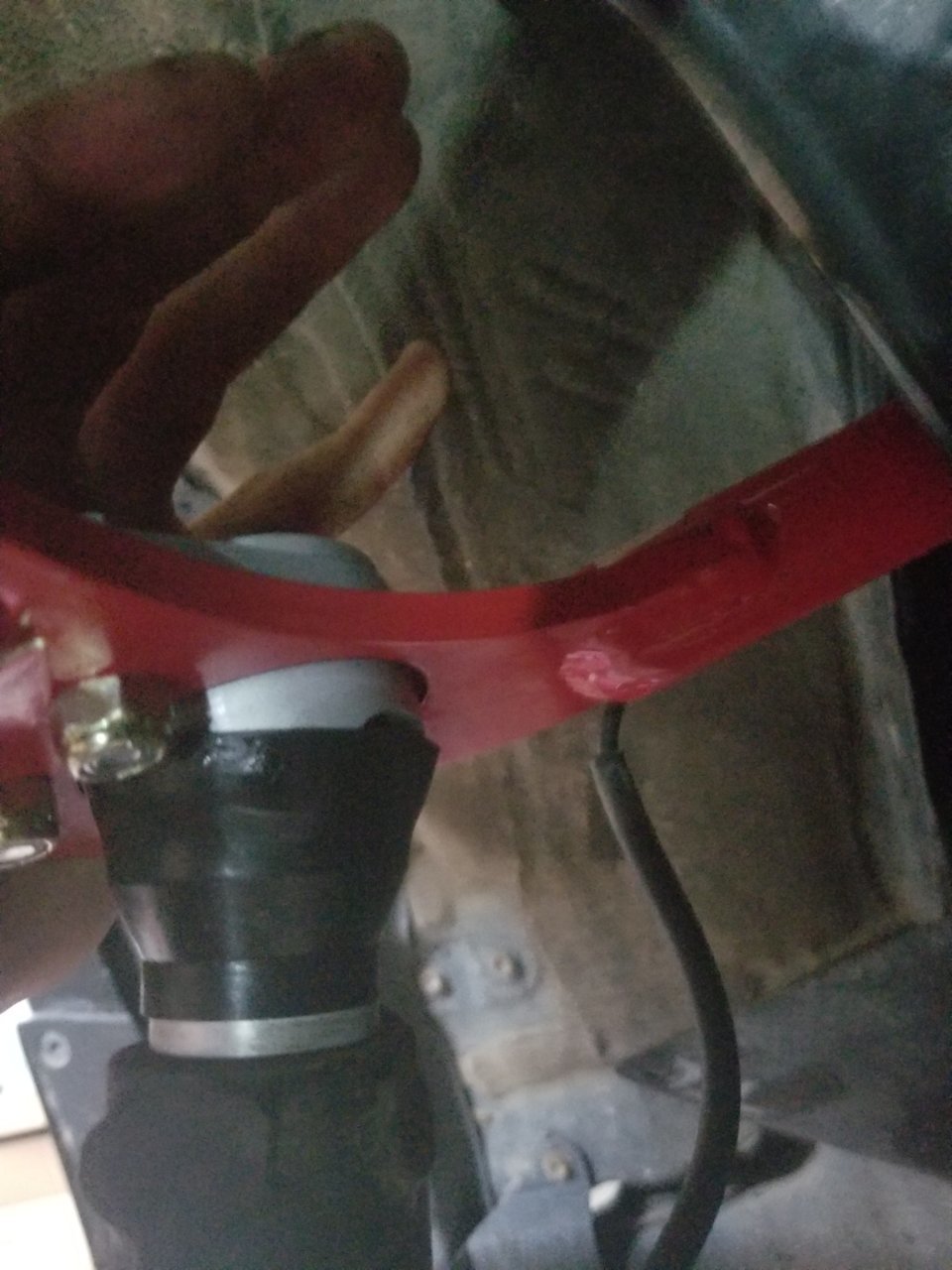

    I have just encountered this gap on my install.... definitely doesn't look right. I'm wondering if you torque the spindle to the Upper ball joint while the lower is disconnected, it will snug it up better. ??? Let me know if you find anything out.

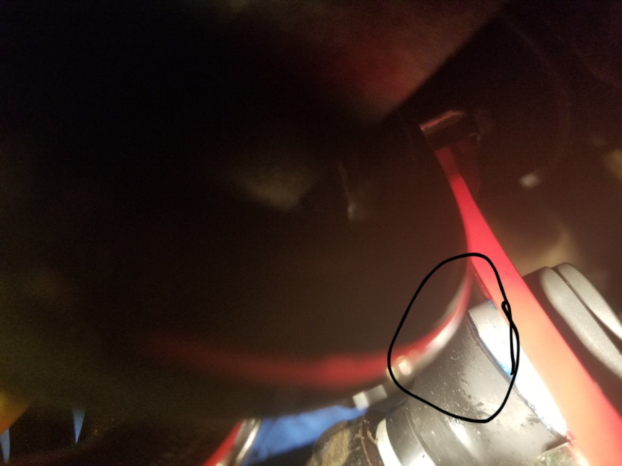

    i have not sent an email, i pumped some grease in them and that gap has basically disappeared. the boot now JUUST covers the gap. ill take a photo later for ya

    interesting.... Is this all on the ground at ride height? If so, as soon as you droop a tiny bit it will probably open up and spit grease out.

    That's what I am wondering. Or is the gap we are seeing at full droop? Either way I am of the belief that it should not be there.

    this is the gap after pumping them with grease. truck is on ground.kind of hard to photograph but i circled it.
    i see your point about it drooping down and opening the gap up more, i was thinking the same. im gonna get it back up on the jack once it is free and see what happens.

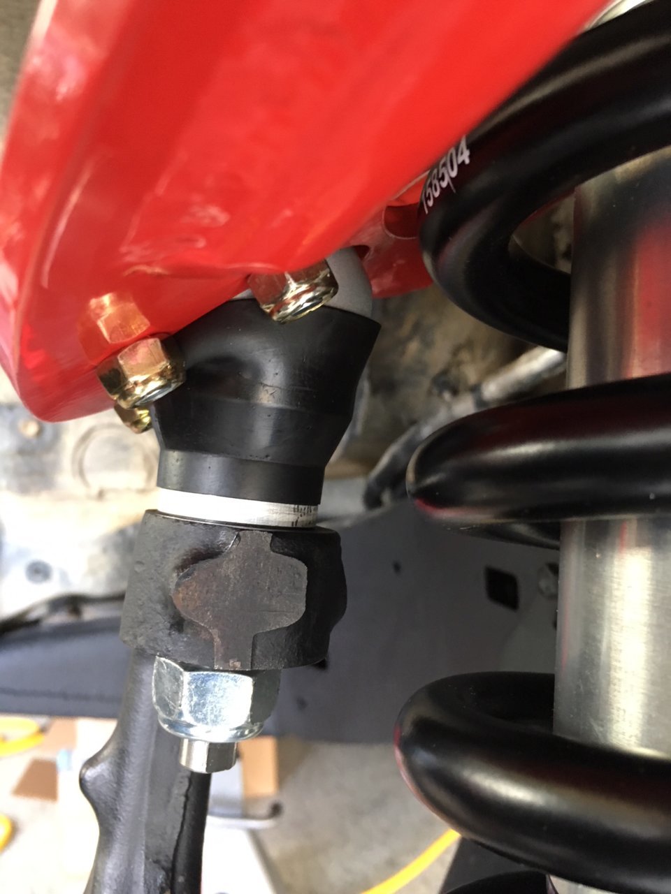

    Here is a picture of mine at full droop. I just went out and dropped the LBJ and then retorqued the UBJ... seemed help a bit but I still feel like the boot should cover more. Also the boot on one side is scrunched up on the outside and the other has slid up into the arm. ??

    Hmmmm, these are all great pics and raise even more questions. While I was on the site I noticed in the parts section that you can buy just the boots. Might be this is all normal and they never really fit up in there all the way which obviously would allow contaminants and ultimately the boots would wear and need to be replaced.........
    Not saying this is a huge deal but for the price........maybe a small deal.........:notsure:
    I tend to overthink the hell outta things though. I'm definitely a worry wart!
