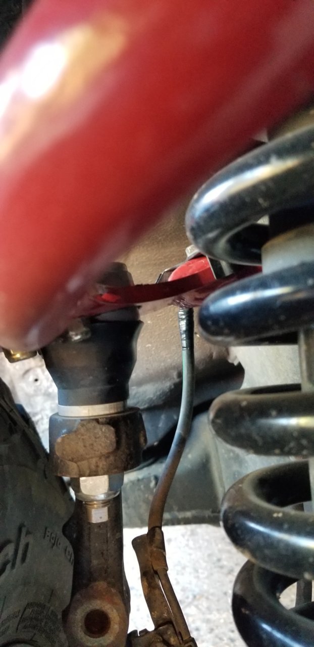

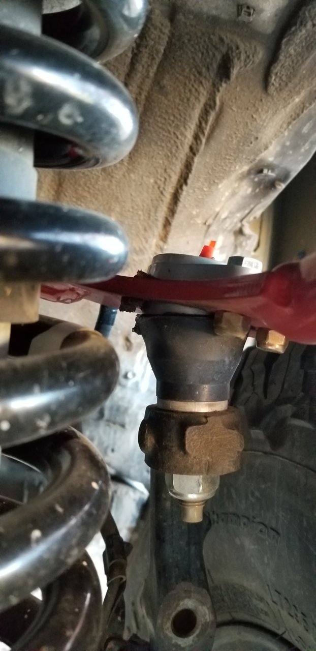

    Looks like mine closed up a bit but there is still a small opening that you can't see in the pictures. First one is the passenger side after I wiped off the grease and the other one was the driver side before wiping. Just noticed that there is grease coming out of the top side of the ball joint on both sides. Anyone seen this before?

    I just did mine this past weekend. Squeezed some extra grease out of it to make room for the boot, drove around , it settled back in. That boot is stiff enough where it slid back in. Guessing it was just from jacking it up.
    For the future though, I'm greasing that zerk on the ground next time, before I put it on the jack to do the rest

    Here is Marlins response in it's entirety:
    Hi Robert,
    The angle is going to vary based on ride height of the vehicle.
    The higher you lift the vehicle the more the angle the arms are on and the ball joint will be on a steeper angle as well.
    Example: This is ride height on my 4runner at 2.0” lift on the front.
    My ball joint frame is about level with the top edge of my ball joint boot. If you take and lift my truck two more inches it would look like the pictures below.
    So vehicles with bigger lifts will see the edge of the boot and the edge of the ball joint housing.
    This is fine and normal for a bigger lift.
    Grease flow:
    The flow of grease is from top of joint to bottom and out the top edge of boot.
    If particles get in the boot they will not flow up in the socket, they will stick in the grease be low the ball and get pushed down from the ball and out over the edge of the boot with the next few pumps of grease.
    I hope this is heplful.
    Thanks
    Marlin Gehman
    K.M. Gehman Inc.
    DBA: JBA Offroad
    3430 Unionville Pike
    Hatfield Pa. 19440
    Ph:1-855-JEEP-IFS 855-533-7437
    Fax: 215-822-7735
    All documents are to be considered proprietary to JBA Offroad and require written permission to be reproduced, unauthorized reproduction will be considered in violation.
    tacocart762, Bastek, Dye22 and 2 others like this.
  20. Sep 28, 2018 at 10:47 AM
    #2480
    RobP62
    RobP62 NVR20LD
    Jun 4, 2017
    #220718
    41,519
    Rob
    Street, Md.
    TTC Member #0125
    So it sounds to me like Marlin is saying that what you all are experiencing is normal and you (we) shouldn't be worried about the potential for failure.
