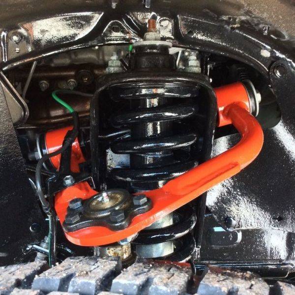

    Bought and installed some standard UCAs, and got em installed on Saturday. No miles yet until alignment, I’m rubbing pretty bad on the cab mount, I need more castor and hopefully it takes care if it. I’ll report back once I get the alignment.

    Hey guys- planning on running 5100s with 887. Which JBA model do I need for UCAs? High castor standard? High castor HD or the standard replacement stock?
    Sorry if I didn't read the whole thread. Trying to buy tonight!

    High castor standard.

    So since I'm lifting about 2"... I want the standard high caster and NOT the standard replacement?
    I'm thinking this one:
    https://jbaoffroad.com/toyota/tacom...ster-upper-a-arms-for-2005-toyota-tacoma.html
