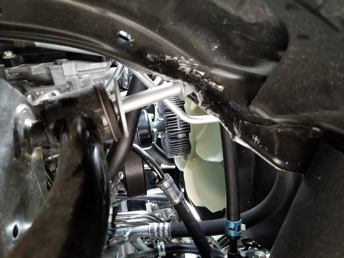

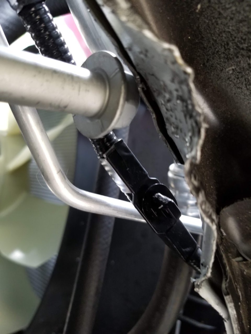

    Man that long bolt was a painful experience. Below you can see the mess I made trying to get the passenger one out. I ended up cutting some of the sheet metal off to get better grip for bending it. Then finally had to use a hammer and punch to get it out. Getting it back in I used a socket on the bolt with an extension along with a breaker bar to use as a lever.
    The inner skinny washers were a huge pain too until I used a crowbar with a thick rubber washer duct-taped to the end (so as not to damage the UCA finish).

    I just used a big 'ol set of channel locks to bend the sheet metal and a screw driver to push the bolt out. Was actually pretty straight forward. Worst part was getting those washers in.

    Is there a flat washer that goes on each bushing end. So 4 total per arm? In your pic it looks like there is only one where the bolt is going in but not one on the other side.

    On the stock UCA there's only one washer on each side, but on the JBA there's a thick outer washer and a thin inner one on each side. There's no way to mistake them because unless you have a hydraulic extender, you're not getting the thicker one in on the inside. The thin one didn't really fit either, but it's thin so I was able to use a crowbar to barely get it in.
    Here you can see the inner and outer washers on the JBA UCA:

    Yeah I used 12" channel locks but the passenger side was just too much interference and the sheet metal has another flap on the side of the engine compartment that was higher up that the channel lock, as big as it was, couldn't reach until I cut the sheet metal. I took about 1/2" off in the area, not too much.
