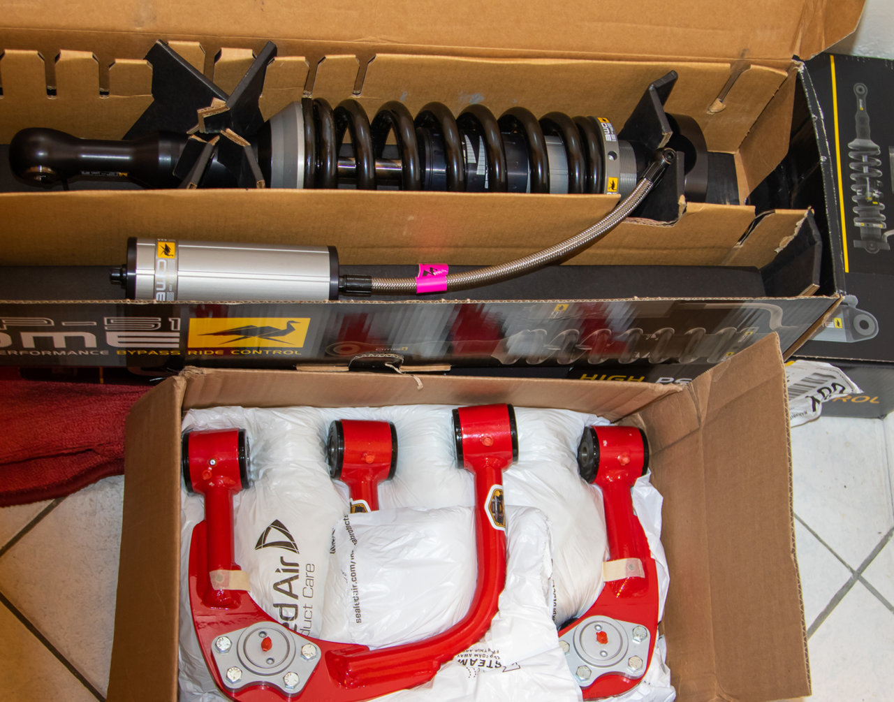

  6. Nov 27, 2018 at 3:36 AM
    #2646
    topaza
    topaza Well-Known Member
    Jan 25, 2018
    #242370
    190
    2013 Black ACLB 4x4 V6
  7. Nov 27, 2018 at 4:01 AM
    #2647
    RobP62
    RobP62 NVR20LD
    Jun 4, 2017
    #220718
    41,519
    Rob
    Street, Md.
    TTC Member #0125
    SWEET!
