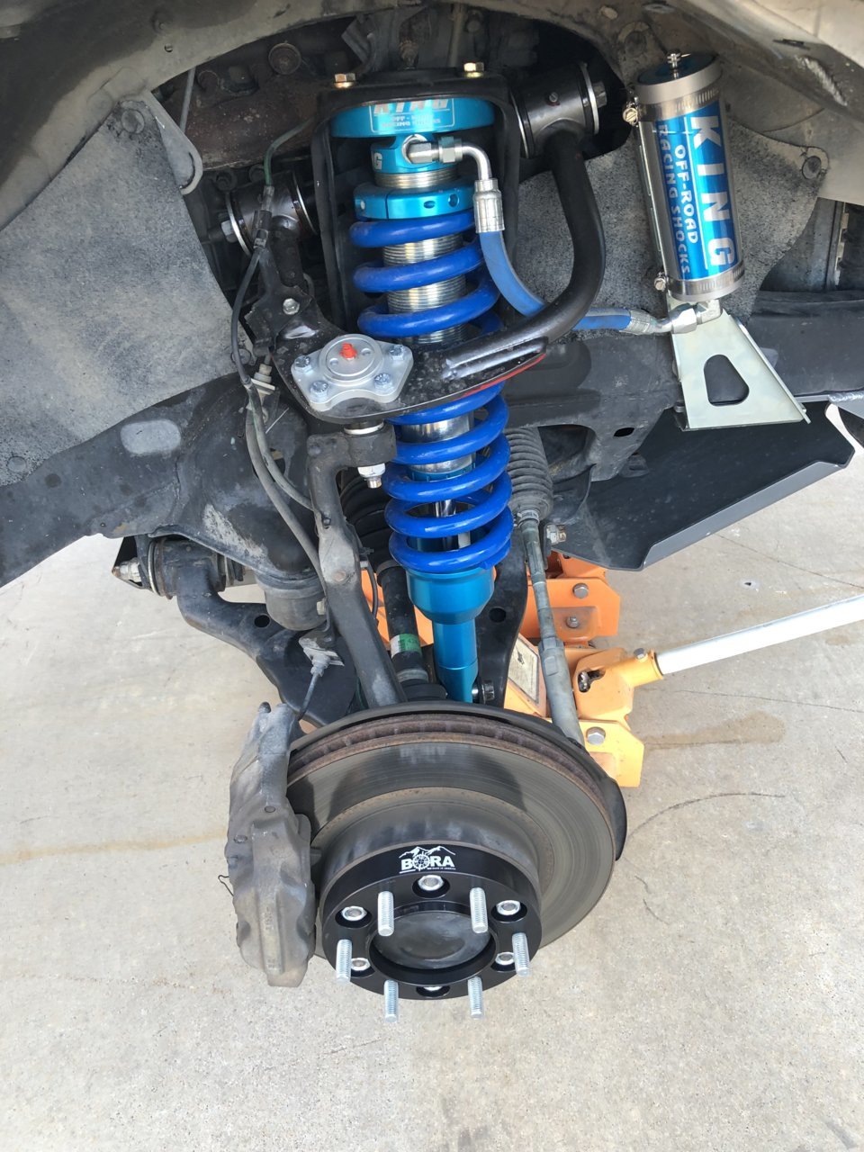

    The JBA’s are an awesome product! I didn’t mind the red color except that it looked horrible with Kings IMO (so I painted them). My tires did rub as you can see in the picture above (repainted them after taking this picture). After adding the 1” bolt on spacer there is no more rubbing.

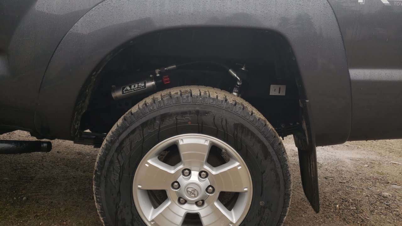

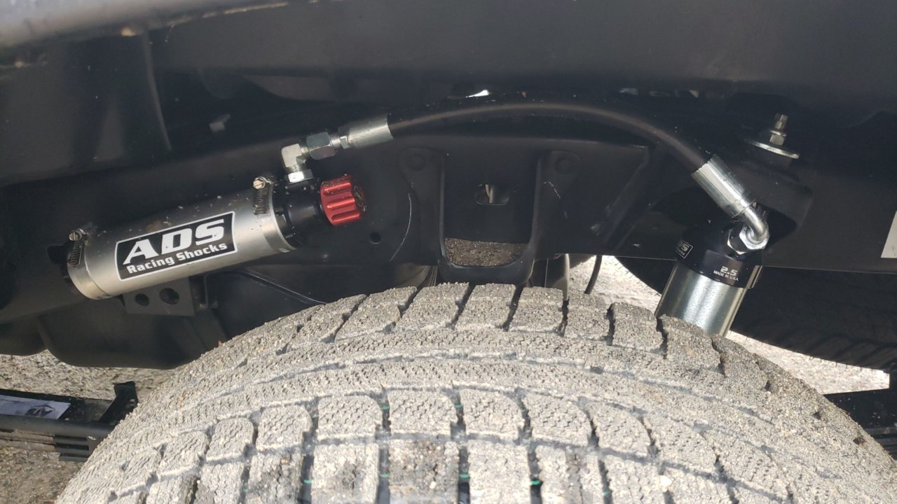

    So I have a 2014 dclb and I just did suspension with ads remote reservoir front and rear with 650lbs springs in front with blackout14? Leaf pack and the jba HD ucas. I still have stock wheels and tires for now (winter hwy driving)I brought it to reputable alignment shop here in town and gave them the printout from jbas website and requested range of numbers . They didnt seem very responsive to the info I provided nor did they have any idea about the esp reset from the jbas website. Here is the printout and specs from the shop and just wanted to see if these look ok and do I need to get the esp reset done at the dealership?
    Also was wondering if I need to add a kit for the driveline if it starts to vibrate or is this lift mild enough not to need it? Lift is about 2.5 front and just over 3 in rear (no weight on truck). Thanks kindly for any input.
