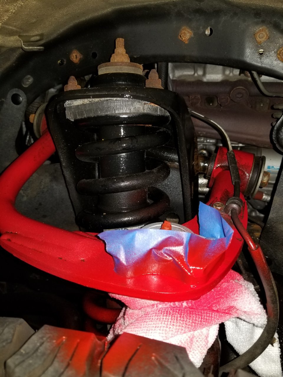

    I have to paint mine, a lot of the red is missing after 3 years

    Sticks well I have hit it with the hose while washing, put some clear Bed Liner over it.

    That works it would look good
