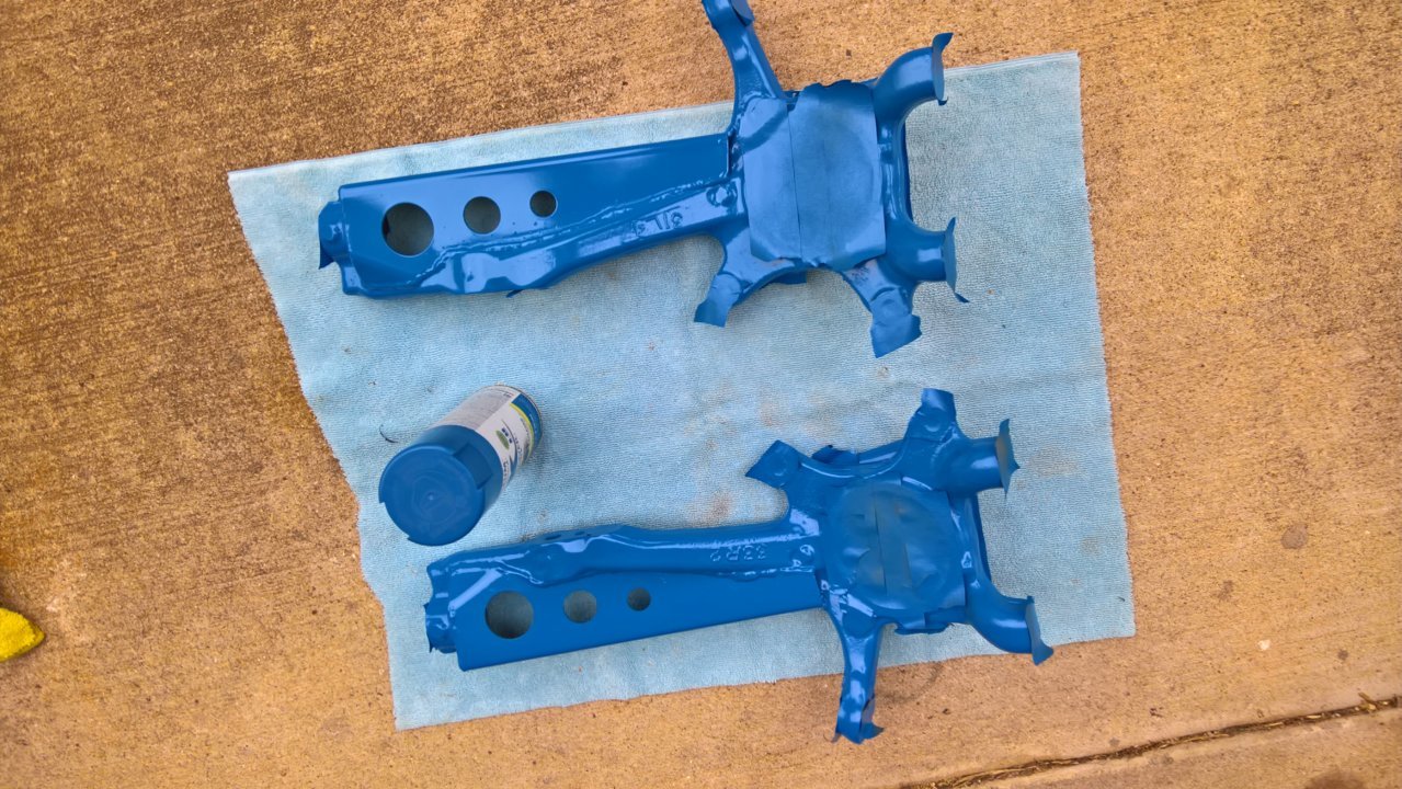

    Nice do you have pics of the arms during that process as well? So you went right over the red Powder coating? What blue is that if I may ask?

    You CAN paint over the powder coat. I would scuff real good and wipe down with a little acetone after. Wipe with tack cloth and spray.
    Here is a cool blue color and its epoxy paint.
    https://www.ebay.com/p/PJ1-Color-Matched-Frame-Paint-98-06-Yamaha-Blue-12-Oz/3021900081

    I wanna say Gloss Radiant Blue, but I can check when I get home. Unfortunately no process pics saved although there may be some in this thread when I did them.

    Epoxy spray paint has a hardner in it to make it more durable. It depends on the manufacturer but some have cans where the resin and hardner mix in the can before it sprays. Im not sure on the exact science of it but Ive used it a ton and it works great, very durable.

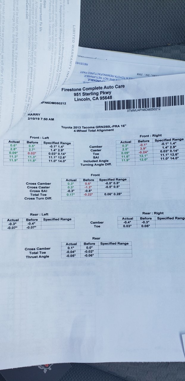

    These numbers are reasonable right? I've had some luck at Firestone and the tech was saying how he has a tundra with fox coilovers and total chaos uca's so he knew about the added caster. Seems to drive good so far, tracks great.

    Those should be fine. I have about the exact same numbers for caster with 285s.

    Yep, those are good
