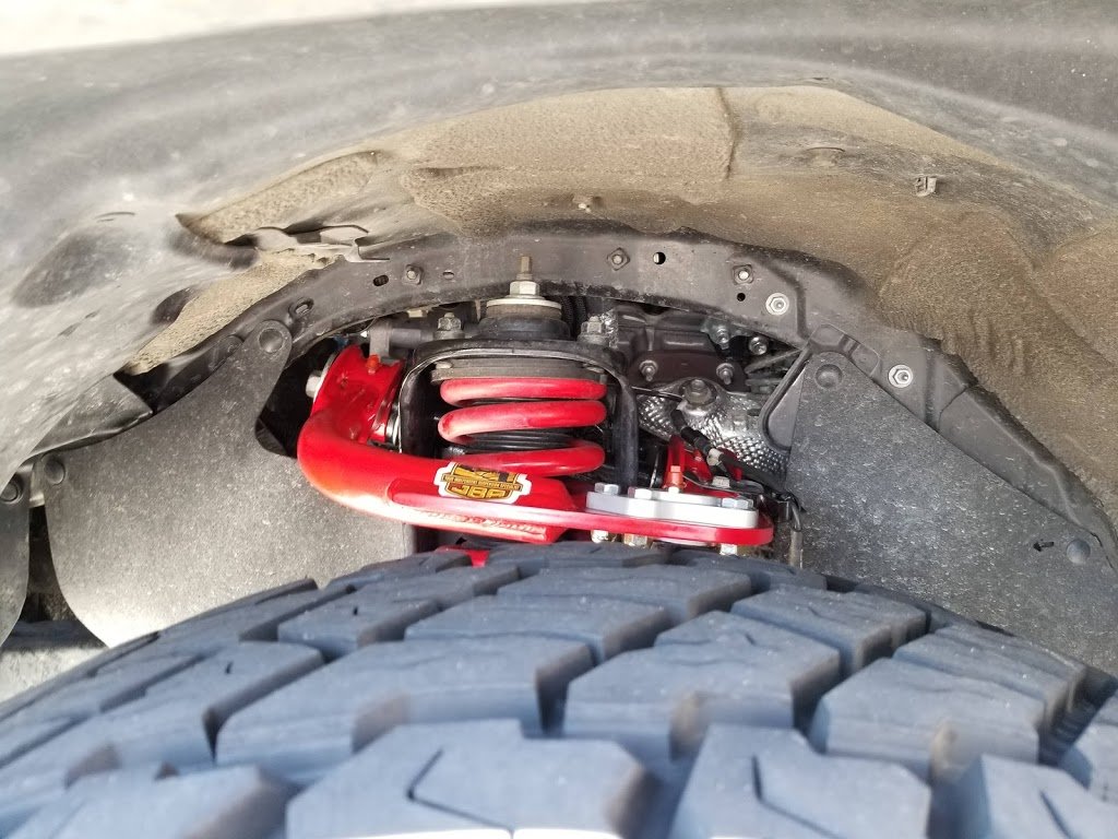

    Finally got around to installing mine today!

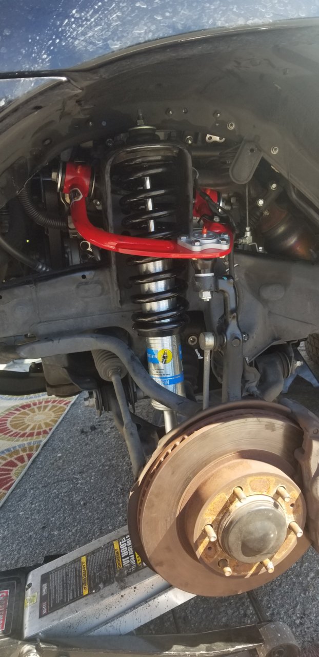

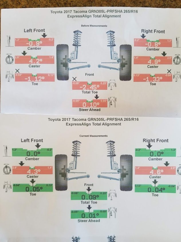

    I spent hours installing the JBA HDs. Those uca bolts are ridiculous to get out.
    Anyhow they're pretty sturdy and alignment came out great.
