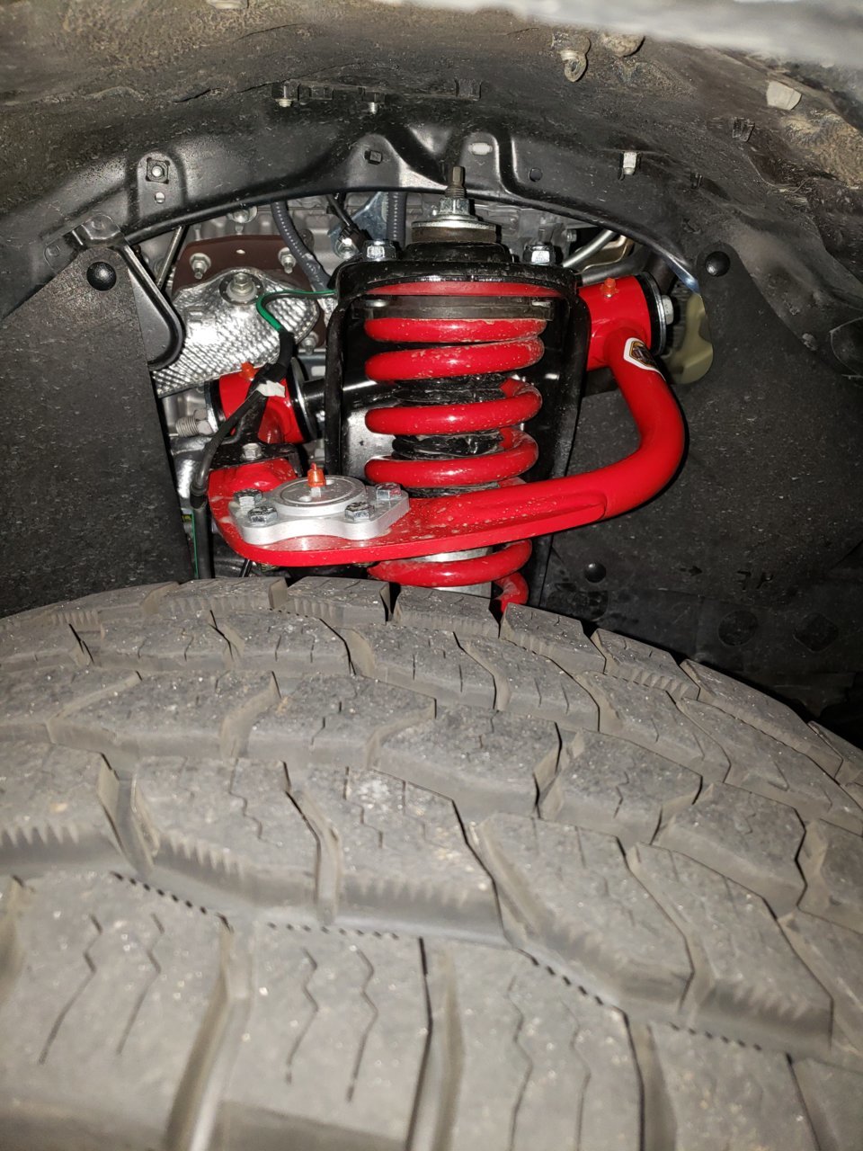

    Checking in to the cool guy club!! I'll update with full details and pics shortly. How do these alignment numbers look to yall?
