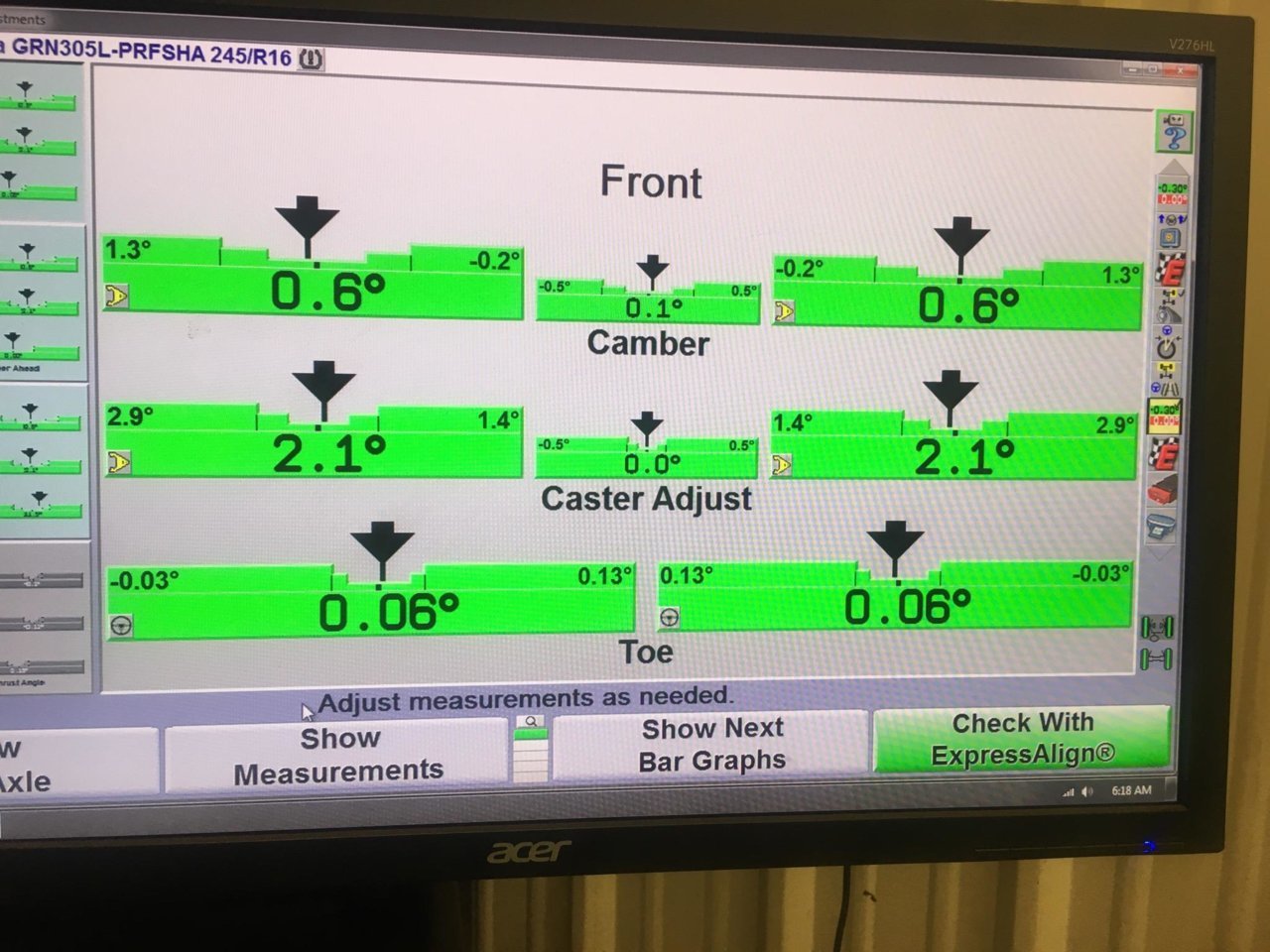

    Any ideas if these are good caster numbers?I emailed jba but haven't heard back yet.

    How much lift? I was able to get 3.5* on both sides at around 0* toe and camber

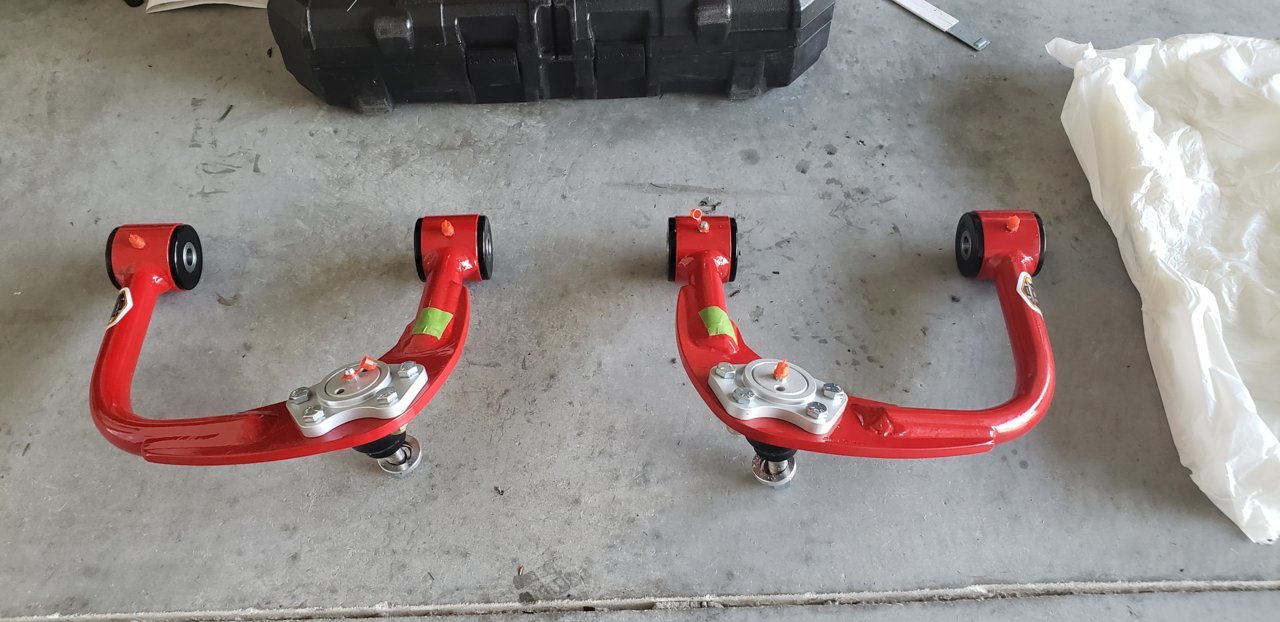

    These will be going on soon hopefully, gota find some spare time, also tempted to buy some toytec boss coilovers to match and just do it all at once. I have a 6in db lift currently with 2.3 caster and feel I need more. 20190314_165101.jpg
    charlieyankee88 and jross20 like this.

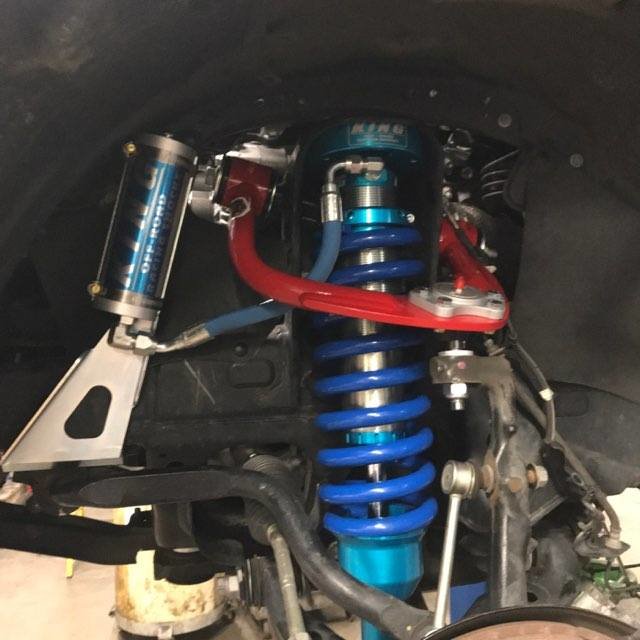

    RADFLO Suspension, JBA HD UCAs, Mobtown low pro bumper, Mobtown bolt-on sliders, Engo SR10s, SCS Stealth 6, AFE CAI, URD Spec U, OV Tuned, Gobi Rack, Softopper, CMC
    Dialing back your caster is unlikely to improve your down travel. If you currently only have .8-.9” of down travel you need to address your suspension set up. Your springs might be too high of a rate for the weight you are running providing too much lift and causing less down travel. The point of running these UCAs is not only increased caster but also increased articulation for down travel. To me it sounds like your shocks are the limiting factor more than your UCAs. Right now, I run JBA HDs on @Radflo Shocks ext travel coil overs and I have 3” of down travel. The ride is solid but I can still top out if I hit large bumps/holes at higher speeds. My caster is currently at 1.5 but I am going in tomorrow to get my numbers closer to 3+* of caster. Checkout the below link for more info on caster and how it impacts driving.
    http://gerstsuspensions.com/tech/
