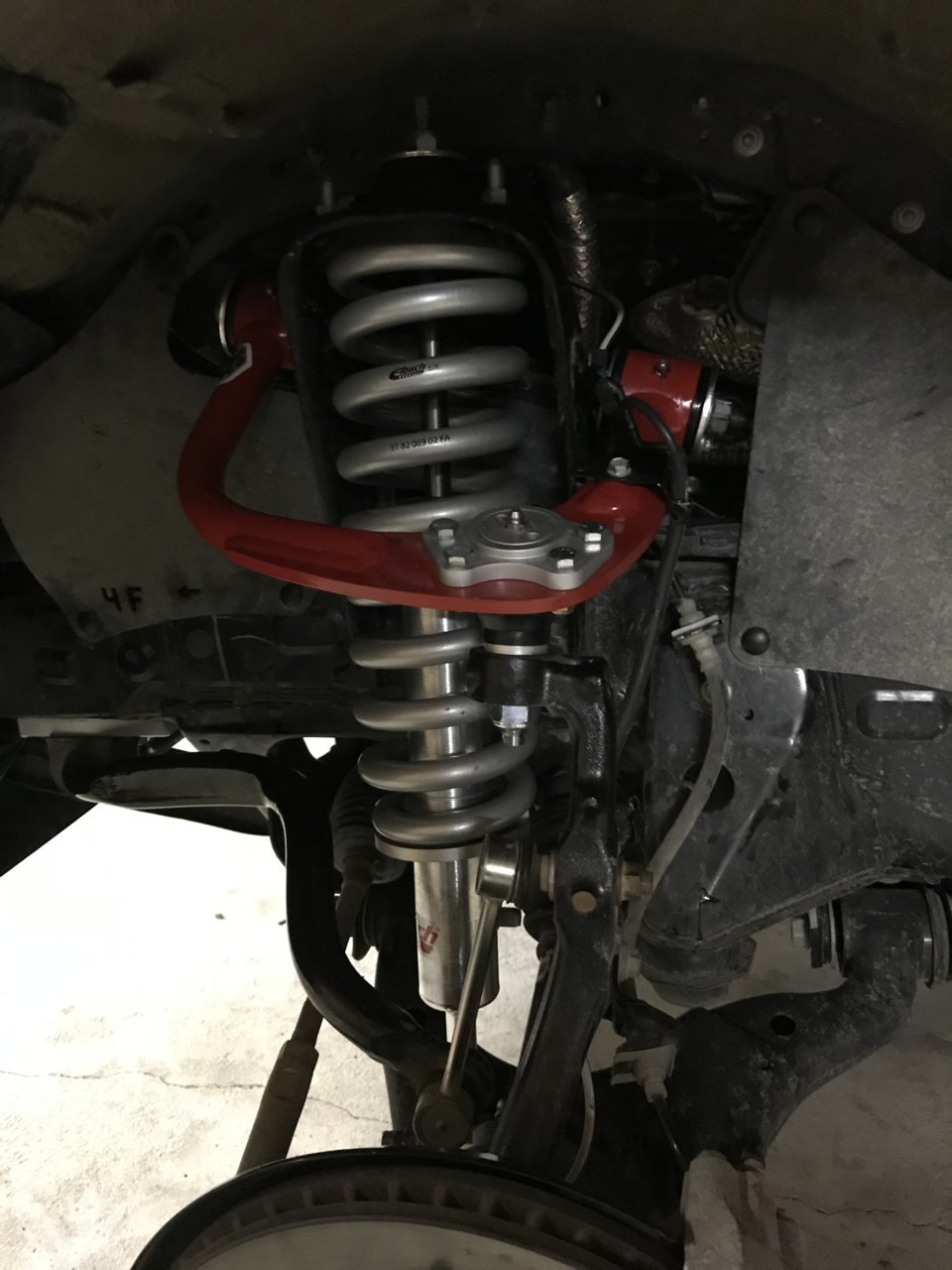

    Just put a set of these on this weekend with a Eibach stage 1 pro lift kit. The bushings where a PIA to get on a pry bar helped a lot 07321DE3-DD4D-4A31-9E23-D54D9B220A54.jpg

    Spring rate and lift?

    Mine is on the 1st clip. Got me 2” of lift. Spring rate I’m not sure.. Best guess 650lbs!! Ride is just a little stiffer than stk No BS

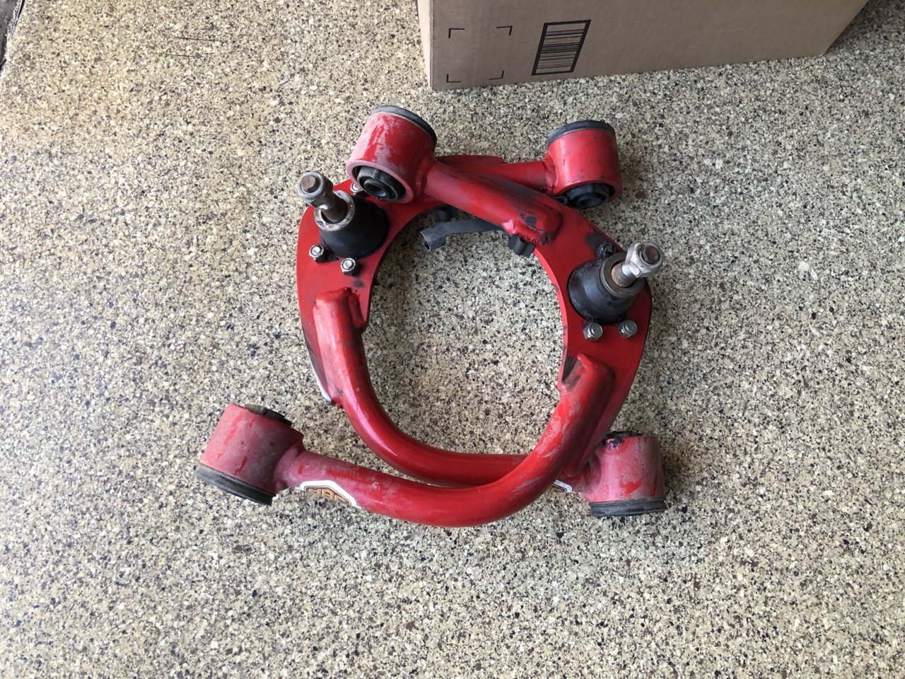

    Are the black boots supposed to cover the entire bottom when the balljoint moves? I'm selling my pair to a friend and when I move the bolt from the bottom, the black cover does not cover the whole bottom

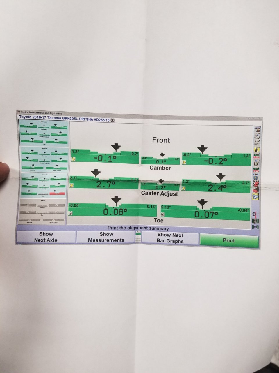

    How does this look for JBA HC, my friend did the alignment and said camber adj is maxed out.

    They don't quite cover the ball at full droop. It was mentioned somewhere in the thread, and maybe even on JBA website, it is normal.
