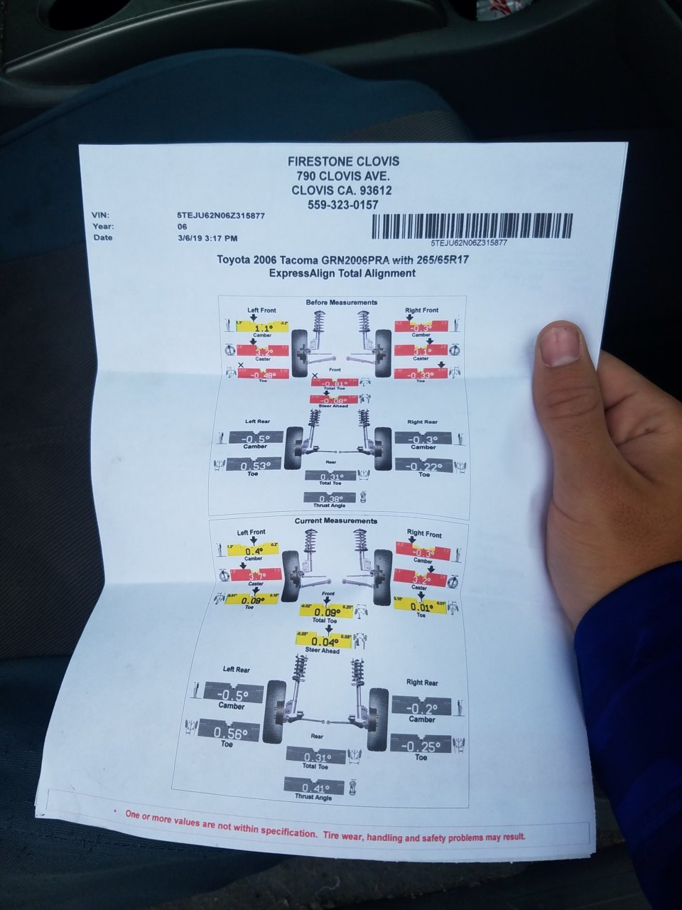

    what size tires you running? and how's it ride with the caster above 3?

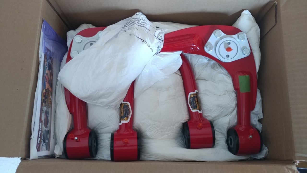

    Just arrived today for the weekend project.

    Nice ! Paint those silver parts !

    Even with the new coating I will have a corrosion problem? If I need to paint I'm thinking maybe a blue to match the Kings.

    I'd just do it as a security measure. They're bad ass UCA. You'll love them. Real easy to get good numbers with .

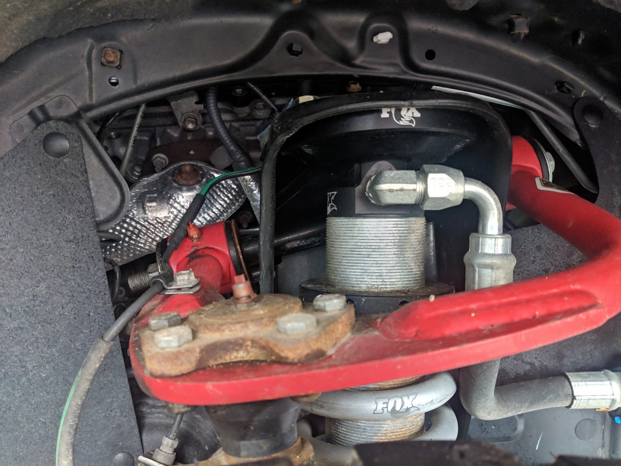

    Yup. I'll brush mine this spring, hit it, and it'll be good as new. The materials themselve are high quality and all that is just light surface stuff. It's come right off and I'll be sealing mine up with clearcoat too. She'll be looking good in no time .
    Also not a bad idea for swapping out the clamp from stock for the line. Doesnt need to be this exact one, but it is the right diameter
    Brake Line Clip Set. Pack of 10. Steel with Rubber Insulation https://www.amazon.com/dp/B01FOKIQ7O/ref=cm_sw_r_cp_apa_i_Y-MTCbGQP6HT4

    Oh for sure That's from my Amazon cart. Just didn't know if there were cheaper ones else where. I bought extras in case they rusted out being steel and all. But you can see in the photo they held up fine

    Is the ball joint corroding or the ball joint retainer plate? Looks like the retainer plate that is bolted on the UCA is what is corroding and what we are talking about. Correct me if Im wrong.

    Just the plate. And it's just surface rust

    Mall crawlin on 35s and I like it, might drop both them back down to 3 on both sides tho just so I stop rubbing on my bumper
