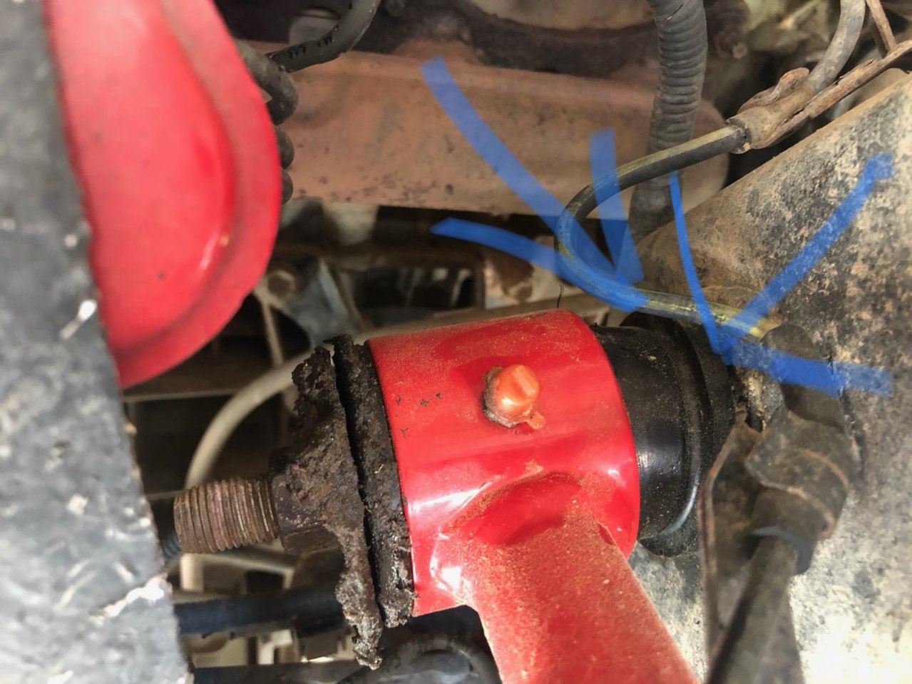

    Question...this bushing is being pushed out??? Anyone ever seen this? Before I call JBA...anyone see this before?
    This is passenger side....Second Gen.

    Looks like it's missing the spacers

    OK yikes. Was this spacer supposed to come with the kit??? Kinda confused now on how it's not there.

    OK...I guess I'll reach out to JBA to see about some new bushings and to see if I can get some new washers. Thanks for the second look.

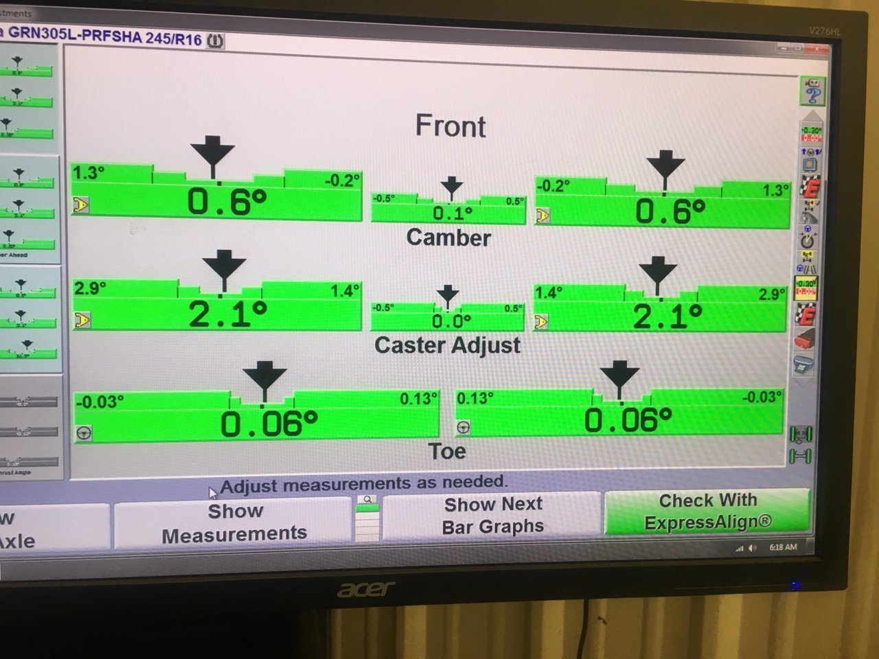

    Finally got a solid alignment, took the pic b4 toe was adjusted on that side.cam tab gussets are a SOLID investment and worth the while to install. Makes aligning a breeze

    Yeah what they said. I’m guessing there was a point where marlin didn’t include them, and people brought up this issue so he started including 4 washers. I’m guessing you recently greased your bushings? I only have two washers, but I have no zerks so my bushings never get greased. The bushing stays put though.
    My theory is zerks+2 washers leads to the inner bushings popping out.

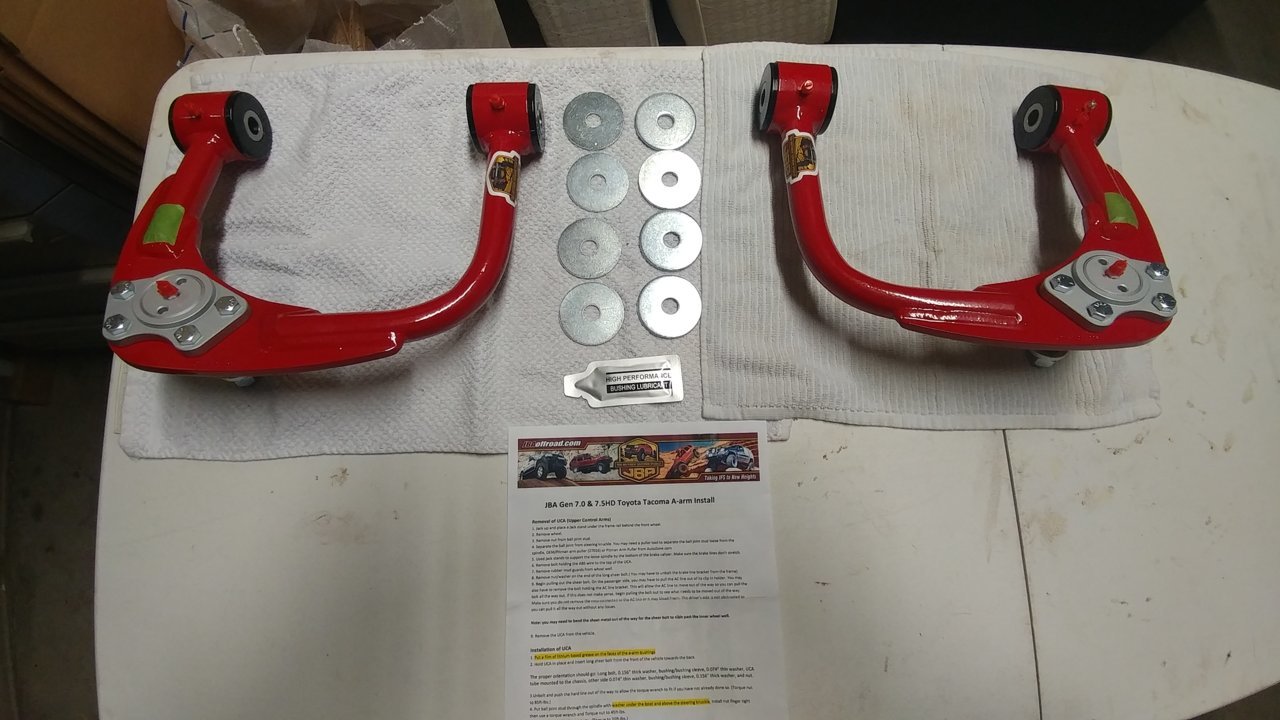

    Marlin, supplies 4 thick washers and 4 thin washers. As well as a small tube of grease.

    I'm getting everything ready for tomorrows install. Think I'm going to do the passengers side first since that seems to be the trickiest.

    On the newer sets, yeah. Mine didn't come with any washers at all. I reused OEM.
    I find both sides to be pretty equal. On each side there's a wiring harness in the engine bay right in the way of the bolt being moved. Undo a couple clips so you can slip the bolt between the sheet metal and the wiring loom. It'll slide right out.

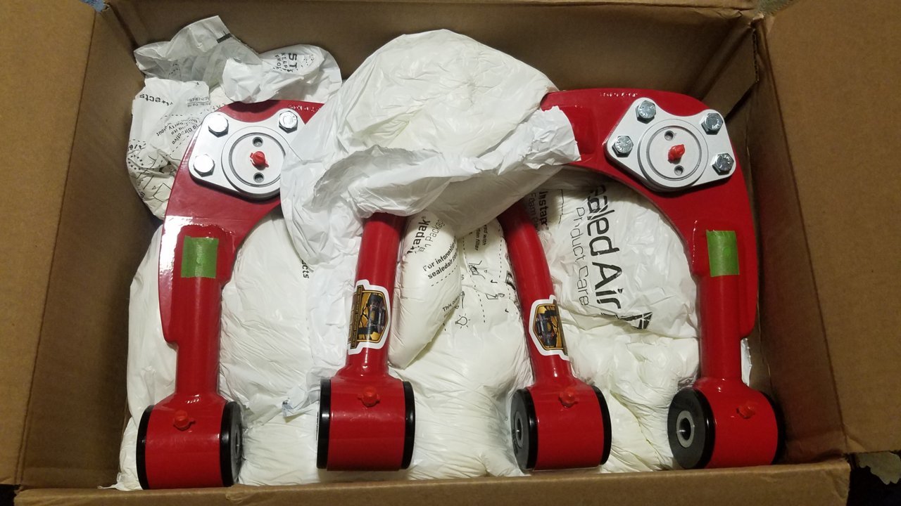

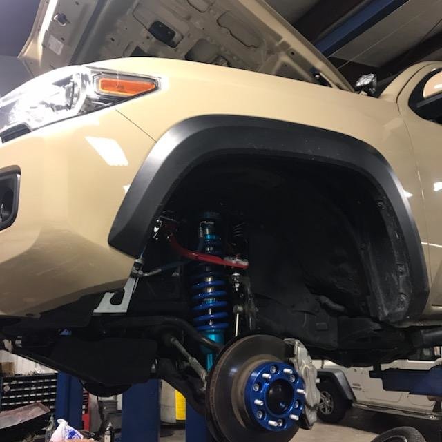

    So these came in today :broccoli:

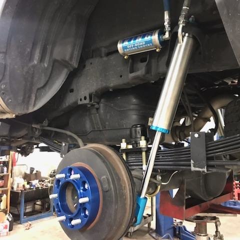

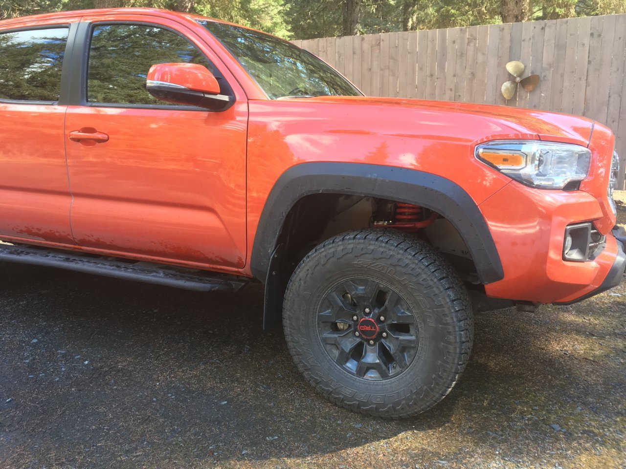

    950E44AD-A133-448B-A628-249A7BCA9E0B.jpg Got the red Dobinson coils put on last night.

    OK...so going forward...Let me know if this is right...and it seems simple enough. Get new bushings, and new washers....replace. Seems simple enough.

    DAMN!!!! I used the texting number to JBA, Marlin...I got an automatic return text saying they were out of town in Moab, returning on Wednesday. He texted me back with what I needed to fix my bushings. I literally ordered them yesterday, on my doorstep today. WTF!!!! That is CUSTOMER SERVICE!!!!!!!!!!!!

    Fn excellent! Where's this shop at. This is the first time I have ever seen all the numbers match exactly!
