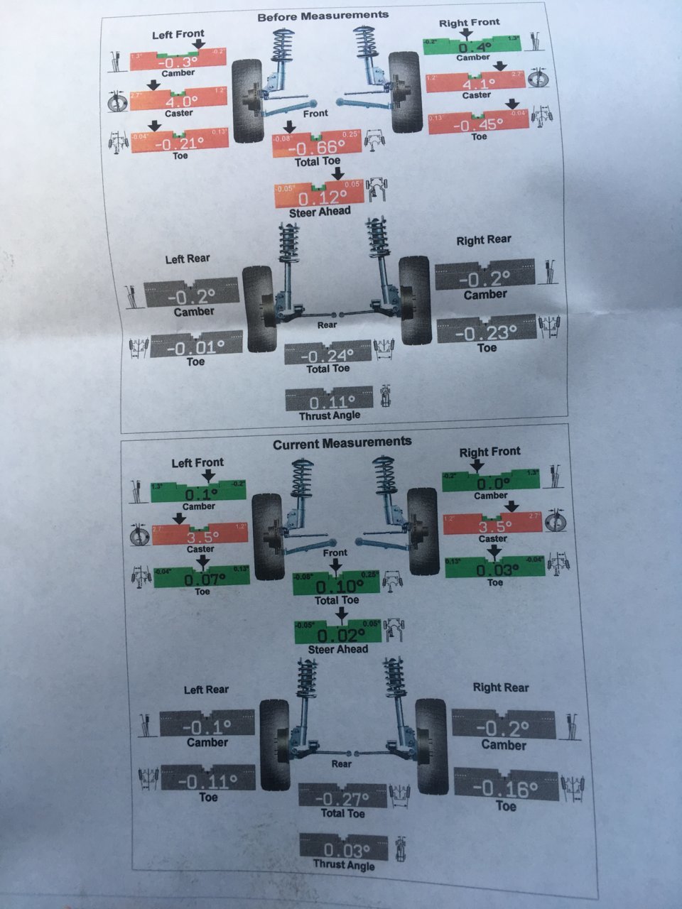

    How do these numbers look. I heard and read that 2.5-3 caster is good but what about 3.5?

    I'd say they are damn good but I am no expert. Odd though they are less than the before.

    Ya. Those before numbers are all over the place. I installed the uca’s and then the coilovers later and was so far out from messing with that lower control arms.

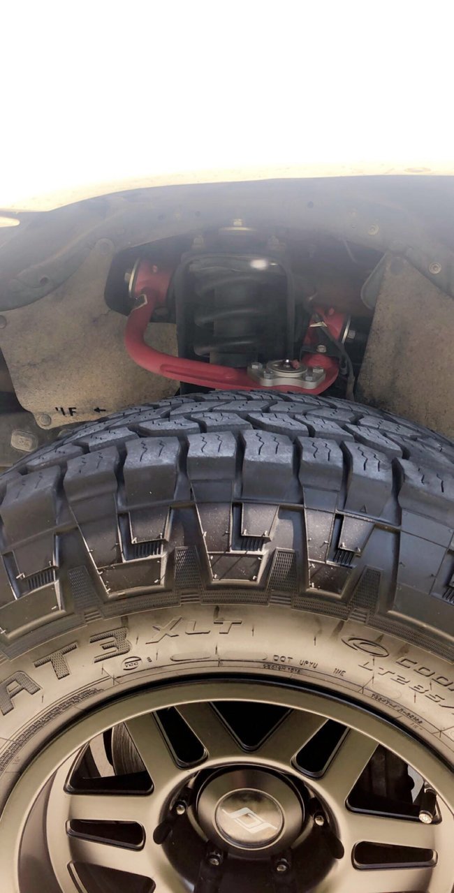

    how does one know what upper balljoint to buy for their JBA UCA's?
    I bought mine used from @Urineovrurhead back in 2016, but I don't know what generation they are. I found this LINK
    Pic from 2016 lol

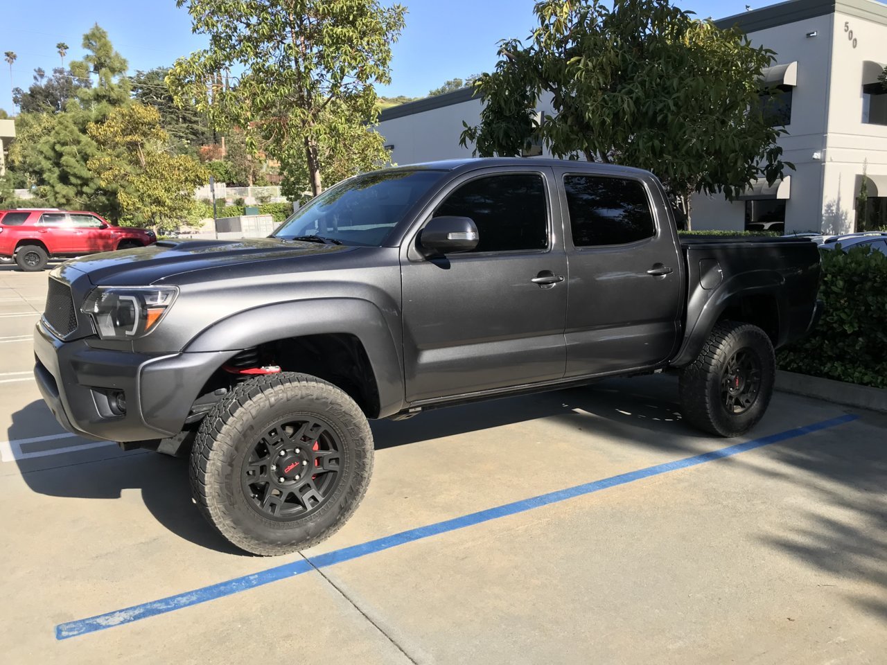

    Love these UCA’s!

    Do they clear the sema wheels without rubbing?

    Yes. No rubbing at all for me, but I only have 265’s

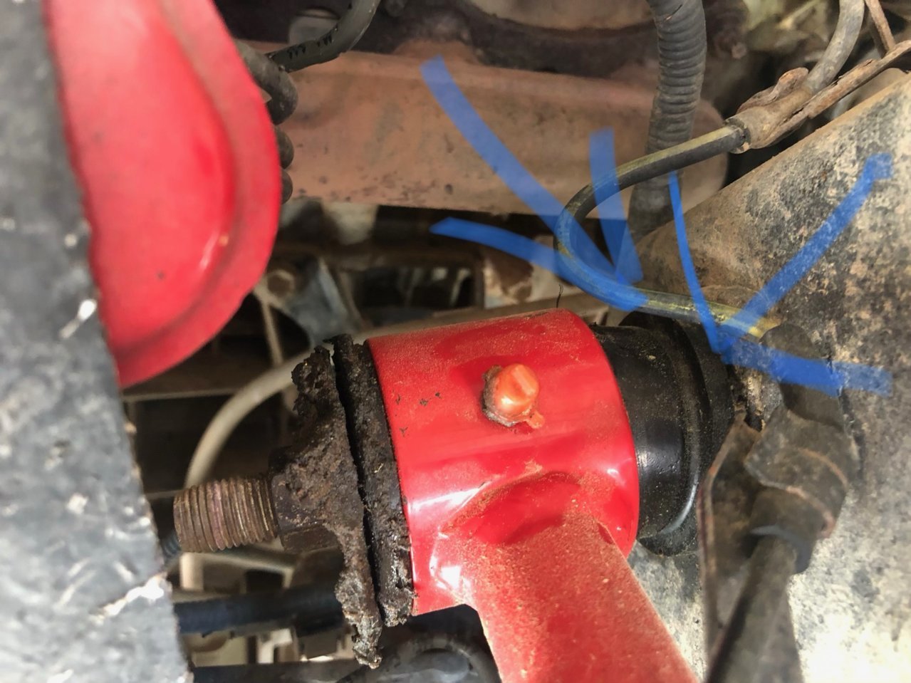

    After 6 months I went to regrease my UCA’s, and I noticed the damn shop forgot to install some washers. Now the bushings on the inside are popping out. Is this something that would ruin the bushings? I’m taking the truck back and making them put the washers in.
    They look just like this, but I have the washers on the outside.

    I gave them the instruction sheet, which specifically says the washer order. I’ll look into getting new bushings at the expense of the shop

    That's the plan
