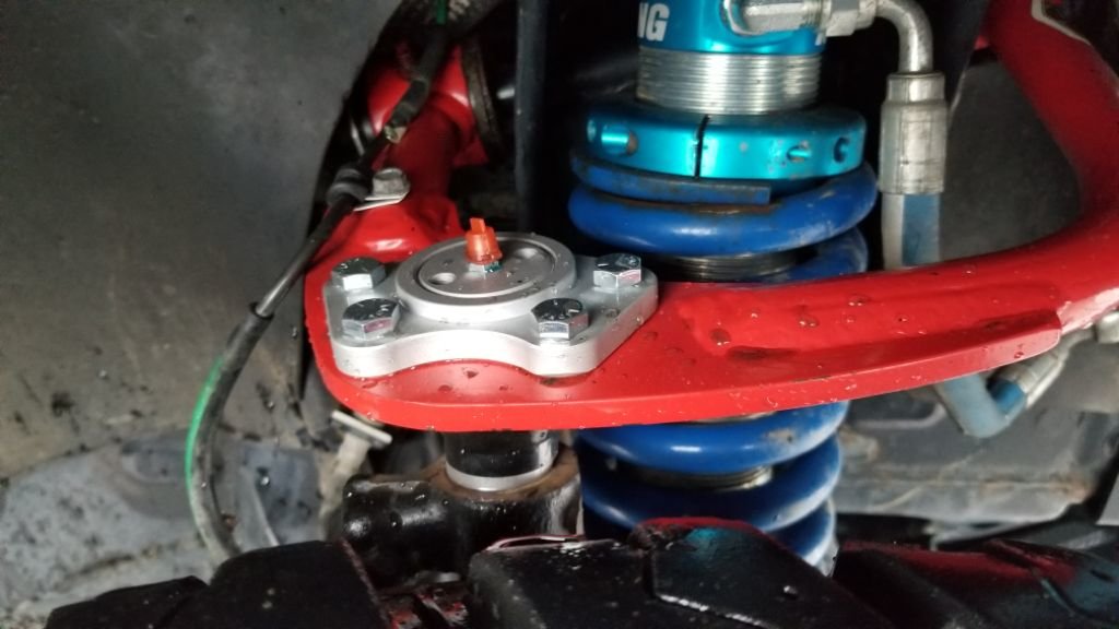

    I installed high casters on my 2019 Tacoma w/ a 2.3” lift (Bilstiens 6112’s) and 285 tires.
    I told the tech 4 caster (He’s good. He’s been doing my off rd alignment for yrs). He actually did my 4runner last yr with these same UCA’s and had zero problem getting 4 caster per side.
    The funny thing is he could easily get 4 caster on the passenger side (even more if he wanted to) but only 3.3 on the driver (he maxed out the cam-bolts and that’s the most he could get). He found that odd and couldn’t figure out why. There’s no way to install the UCA’s incorrect from what I can see or anything to adjust.
    In the end he set them both at around 3.4 caster to match which is disappointing.
    Any insight?

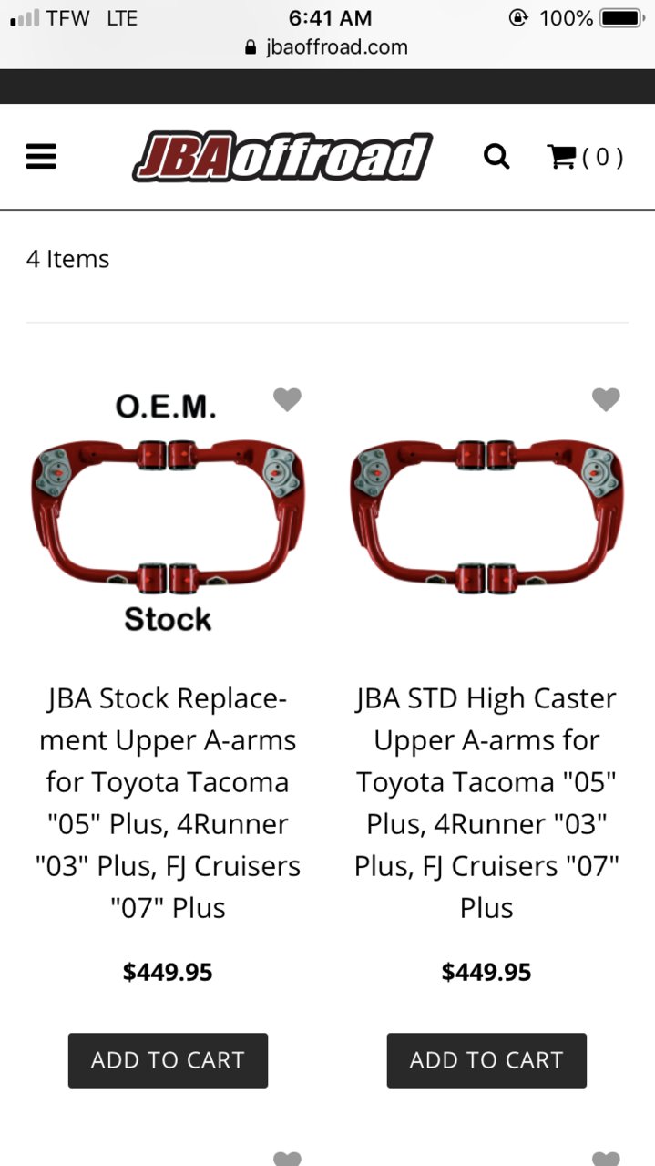

  12. Jun 14, 2019 at 4:45 AM
    #3172
    806Taco
    806Taco Mr. Worldwide
    May 6, 2019
    #292423
    112
    Texas
    2013 Double Cab Short Bed
    Bilstein 6112 (Front) Bilstein 5100 (Rear) General Spring KC - HD Leafs Poly Swaybar Bushings Braided Stainless Steel brake hose Intake Manifold Spacer Retrofitted Headlights
    I am confused now. Which one do I need to get for my 2013 with Bilsteins 6112s set on the 2nd clip with about 2”-2.5” of lift on the front and about 3” on the rear? Do I go with the OEM Replacment or high caster? If high caster I don’t think I need the Heavy Duty version.
  13. Jun 14, 2019 at 4:47 AM
    #3173
    Sandman614
    Oct 26, 2010
    #45273
    36,024
    Tim
    Garner, NC/Boone, NC
    '06 SR5 Off Road
    HD = jumping dunes
    806Taco[QUOTED] and oscolivar1 like this.
  14. Jun 14, 2019 at 4:50 AM
    #3174
    Tacotj
    Tacotj Well-Known Member
    Jan 3, 2016
    #173861
    166
    Ottawa ON
    2015 DCLB 4X4 Sport
    The one on the right, STD high caster
    806Taco[QUOTED] likes this.
  15. Jun 14, 2019 at 4:50 AM
    #3175
    oscolivar1
    oscolivar1 Well-Known Member
    Oct 30, 2013
    #115568
    2,267
    Oliver
    VA
    2017 Tacoma Limited
    Bilstein 8112/8100, JBA UCAs, Icon RXT leaf pack, work wheels 17x8.5;-10os, 285/75/17 cooper LTX AT3, Mobtown HC rear bumper and Sliders, SSO front bumper, BAMF greceased grill.
    If your not jumping then STD high caster is just fine for your off-roading needs.

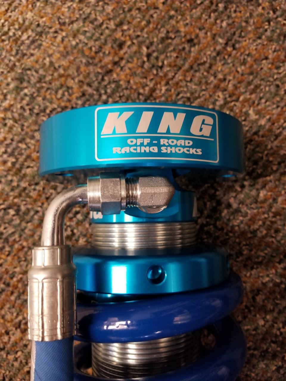

    What front Kings do you have and what are set at for height? I have extended travel not on yet set at 2.5 inches of lift. Yours look like more preload than mine.
  18. Jun 14, 2019 at 6:14 AM
    #3178
    Bastek
    Bastek Average Member
    Jun 6, 2017
    #220876
    4,304
    Seb
    SI NY
    '17 OR dcsb
    KDMaxP10, plastidip
    OK so, those are pretty much same Coil-Overs, and mine have 650 lb springs on them.
    I recently readjusted them (twice, lol. First time I overdid it, had to back off a turn) after installing a bumper with a winch. Hence the extra preload. BTW, I was aiming at 22 1/2 inches hub to fender on my 3rd Gen. I'll have to re-measure how it settled.
