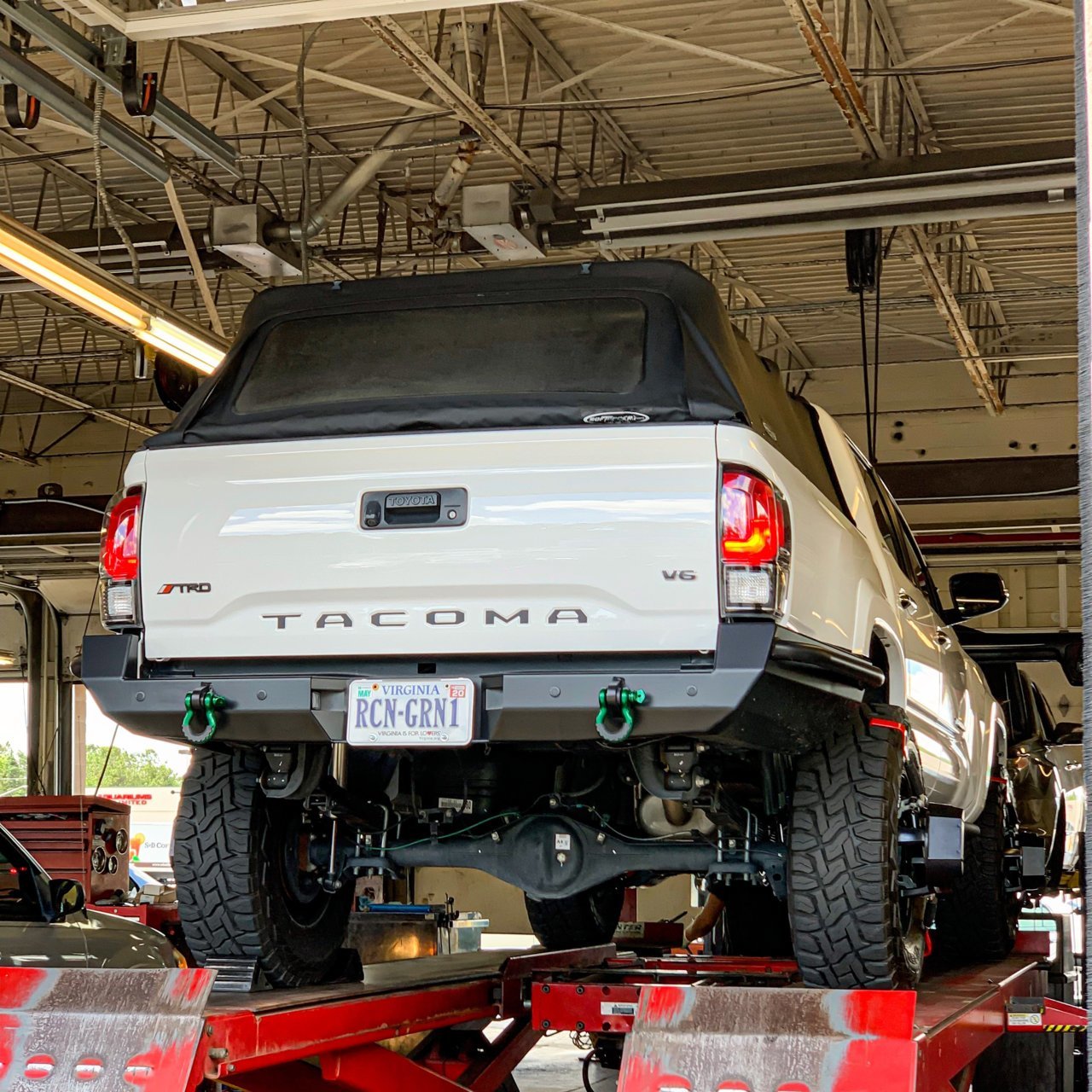

    #254789
    1,733
    Central Kentucky
    2019 TRD OR DCLB (Sold), Honda Civic TRD PRO

  3. Jul 3, 2019 at 6:48 AM
    #3243
