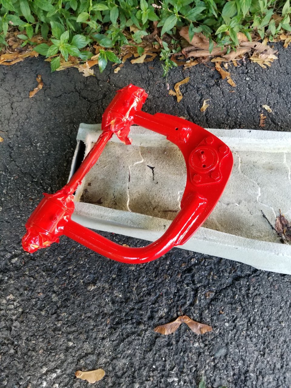

    So these are just about done, repainted in red and then Epoxy Clear Coated. This is a test to see if the Epoxy Clear holds up well in the Salt Belt. To see if the Ball Joint Top Plate doesn't corrode.
  10. Sep 3, 2019 at 1:50 PM
    #3330
    DrFunker
    DrFunker Well-Known Member
    Feb 3, 2014
    #122158
    42,918
    If we had a winter like the last one, it will be the ultimate test.
