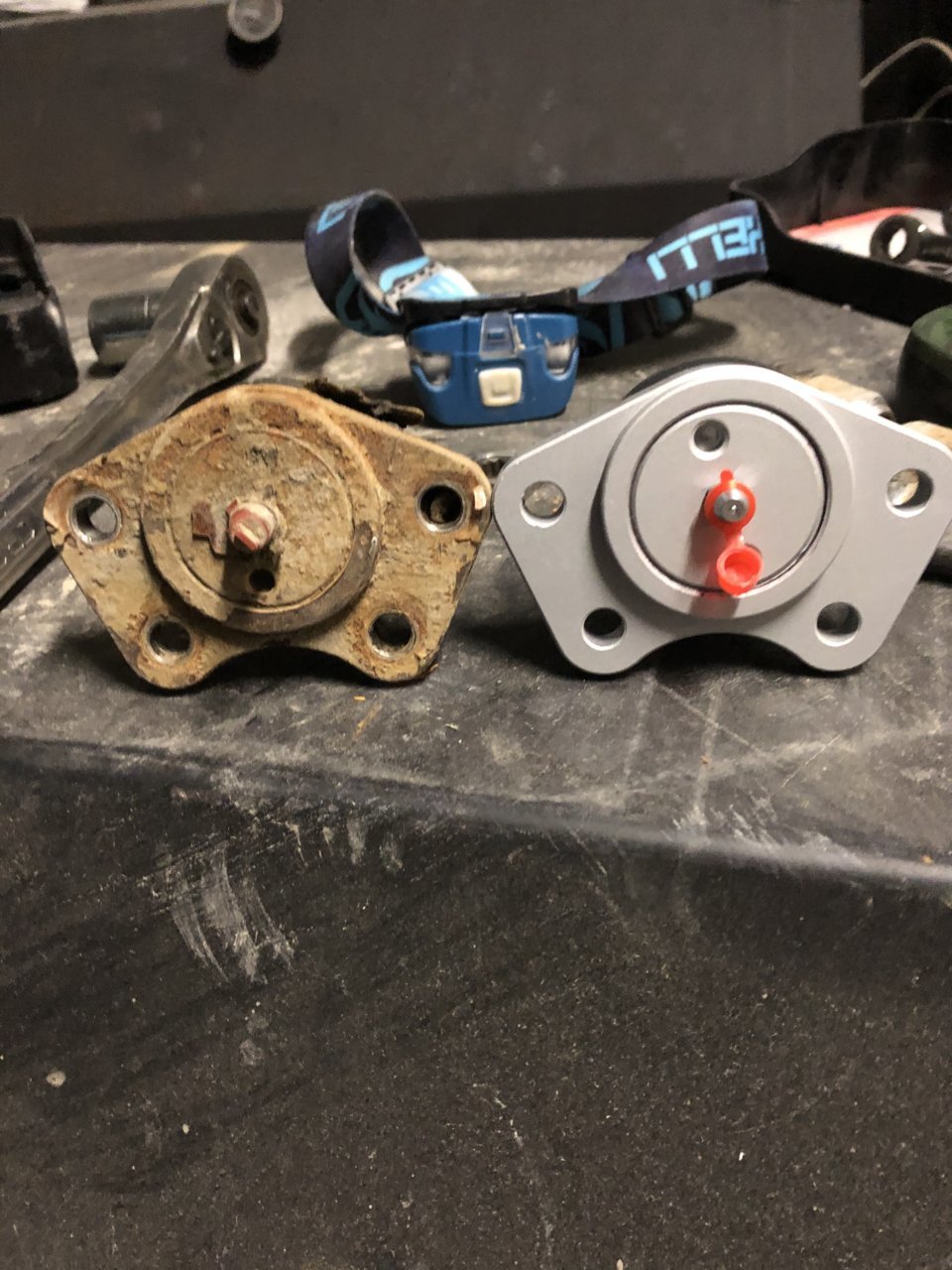

    Also for reference here’s the old and new ball joint assembly (2 years with 25k) 8CFC18F3-1EA9-457B-BC91-0C2A73E31226.jpg

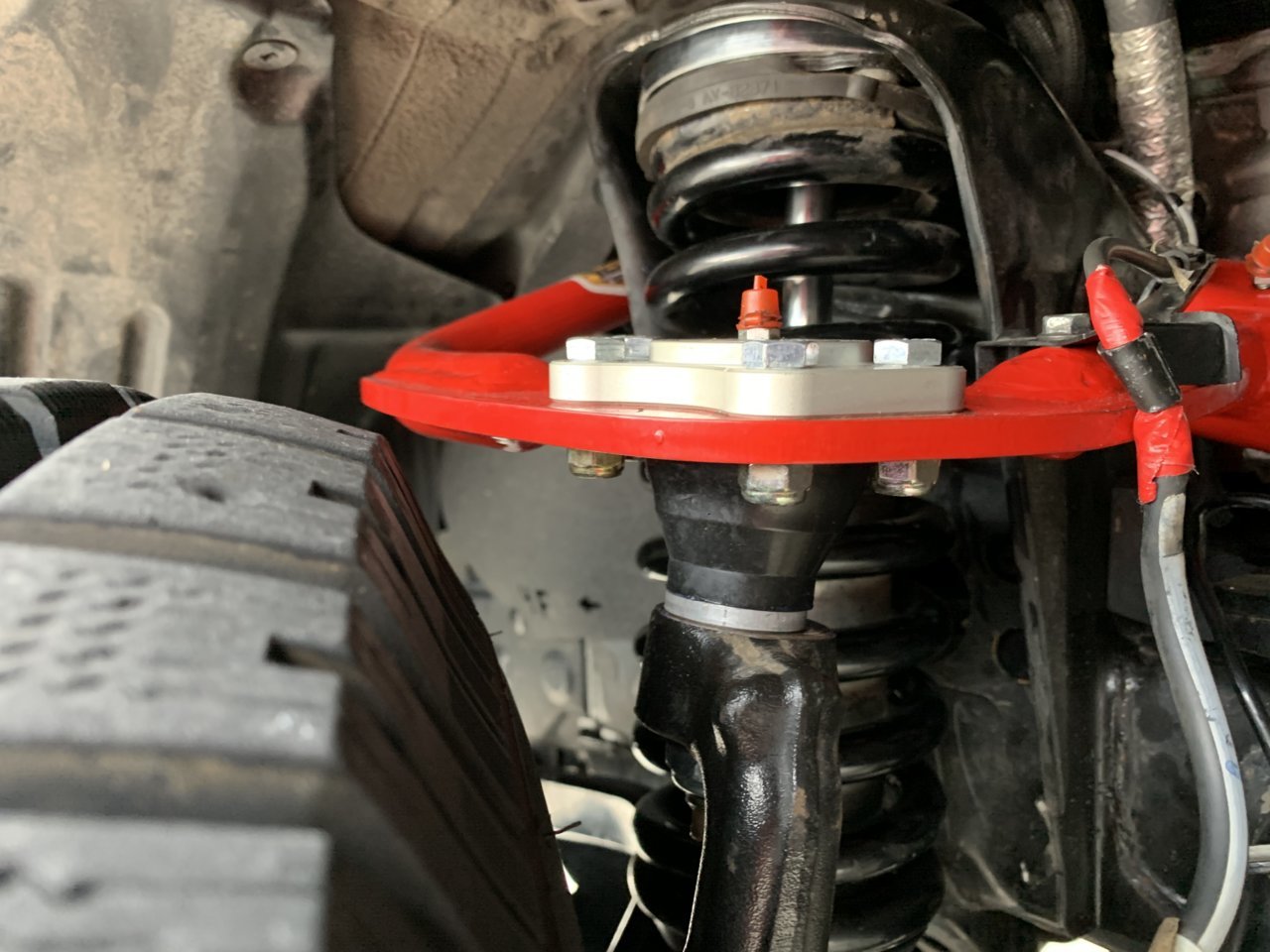

    It’s more of a height issue than width. A 31.7” tire sits below the UCA. So anything bigger on a +25 rim would hit. I’ll try and get a picture so you have a visual.

    18 TRDORDCLBCEMENT
    This is 265/75/16 on stock TRD OR wheels with a little over 2” lift.

    Ahhh. Thanks for the pic. That helps.

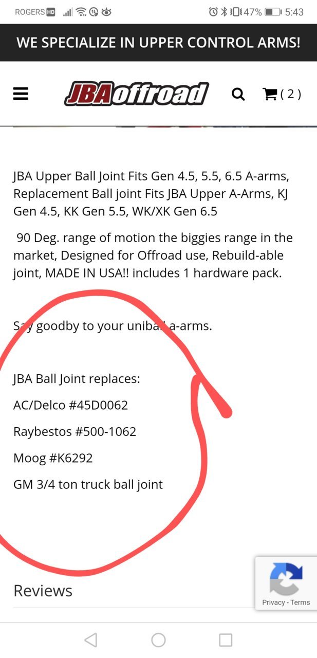

    Ccelman
    Ccelman Member
    Aug 24, 2016
    #195454
    16
    Vancouver BC
    16 tacoma dcsb trd sport blue 6spd
    Old man emu lift kit JBA UCAs 285/70/17 ko2s
    I am in need of replacing my ball joints in my JBAs do they have to be the JBA ball joints or can I use any of these ones listed in the photo.
    I have to make a trip this weekend through a snowy mountain highway and don't feel comfortable with not fixing it first but can't get the JBA ball joints in time

    Were they well greased before install? Everything else you took apart is reinstalled correctly like sway bar end links, etc?

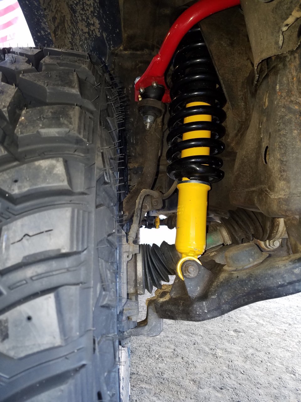

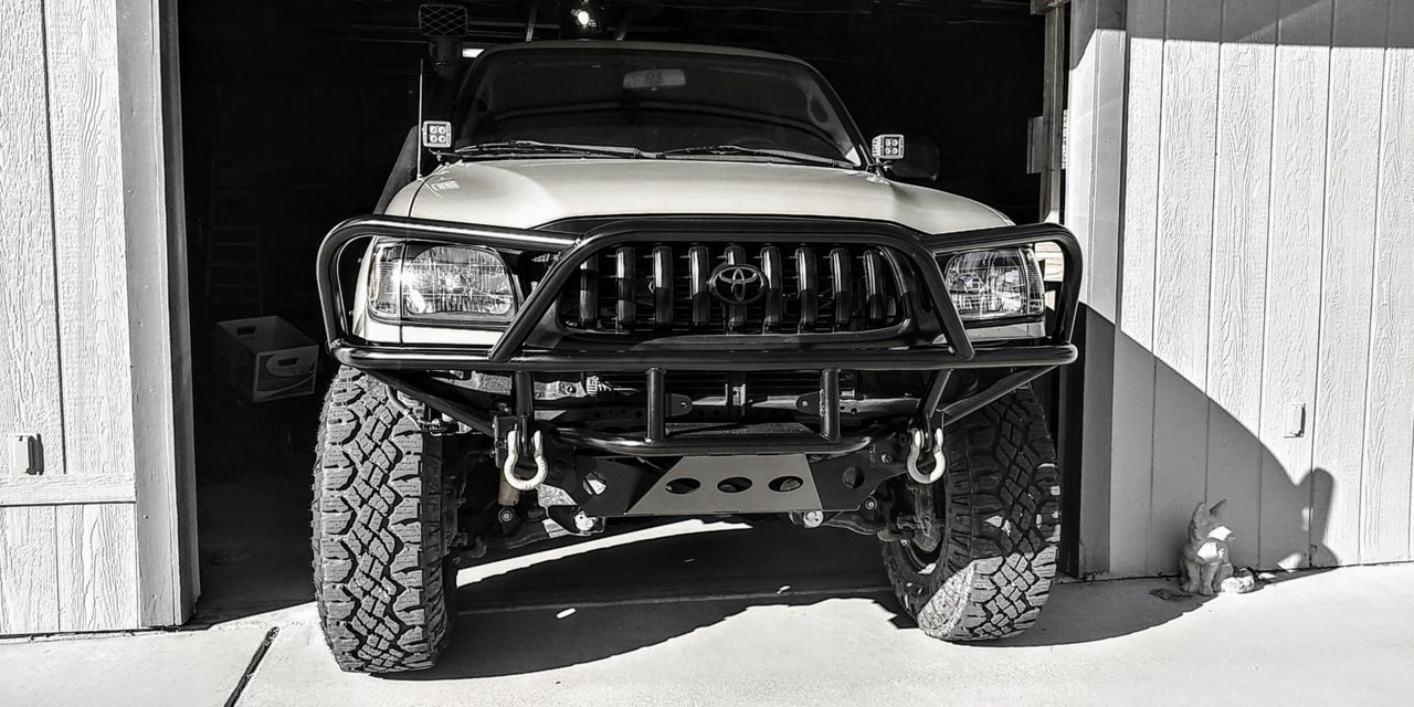

    Hope this will help anyone trying to decide or get a visual...
    The alignment shop was really impressed with how easy they were to work with.
    No clearance/fitment issues for me at all.
    No noise/clunking/binding of any sort.
    Just a smooth uca, doing its job.
    Here they are installed and I have a little over and inch between the tire and the uca, plenty of room!
    2004 Tacoma, 3" OME (882), scs 16x8 wheel 4.0 backspace -12 offset. 285/75r16 tire.
    PreTaco170 likes this.

    Awesome!
    If you have a chance can you get a picture of your clearance on the UCAs at full lock with that wheel/tire setup?

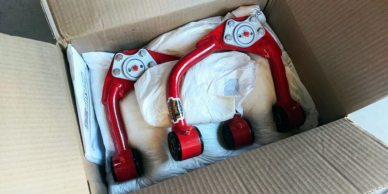

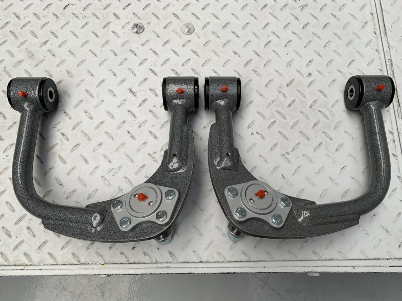

    Just came in 5mins ago! Going on my '03 in the next couple weeks. After going through this thread I learned that there was a rust issue with the older jba ball joints. After looking at some of the pictures the ones I received today look like they might be the older style. Can anybody confirm?
    I do live in Southern Arizona so salty roads won't be a problem here LOL. If they are the older ones should I contact jba asap? I don't want to run into any rust issues if I can help it.
  16. Feb 26, 2020 at 4:34 PM
    #3456
    PreTaco170
    PreTaco170 Well-Known Member
    Nov 2, 2016
    #201379
    193
    Russ
    St. John’s County
    2009 PreRunner DCSB TRD OR
    Bilstein 6112/5160, Dakars, JBA UCAs, FN f(x) Pro 17x8, 285/70R17(C) BFG KO2, Wheeler's Off-Road Bumpstops/U-bolt flip kit, CMC, Marlin Crawler HD LCA Frame Brace Kit, TRD CAI, Flowmaster exhaust, Alpine iLX-407 CarPlay receiver
    Those appear to be the newer cerakote version but I guess you could call or email Marlin at JBA and ask him. Since you just purchased them new I would be surprised if they aren’t using the latest version he has.
    SR-71A and Ak4T777[QUOTED] like this.

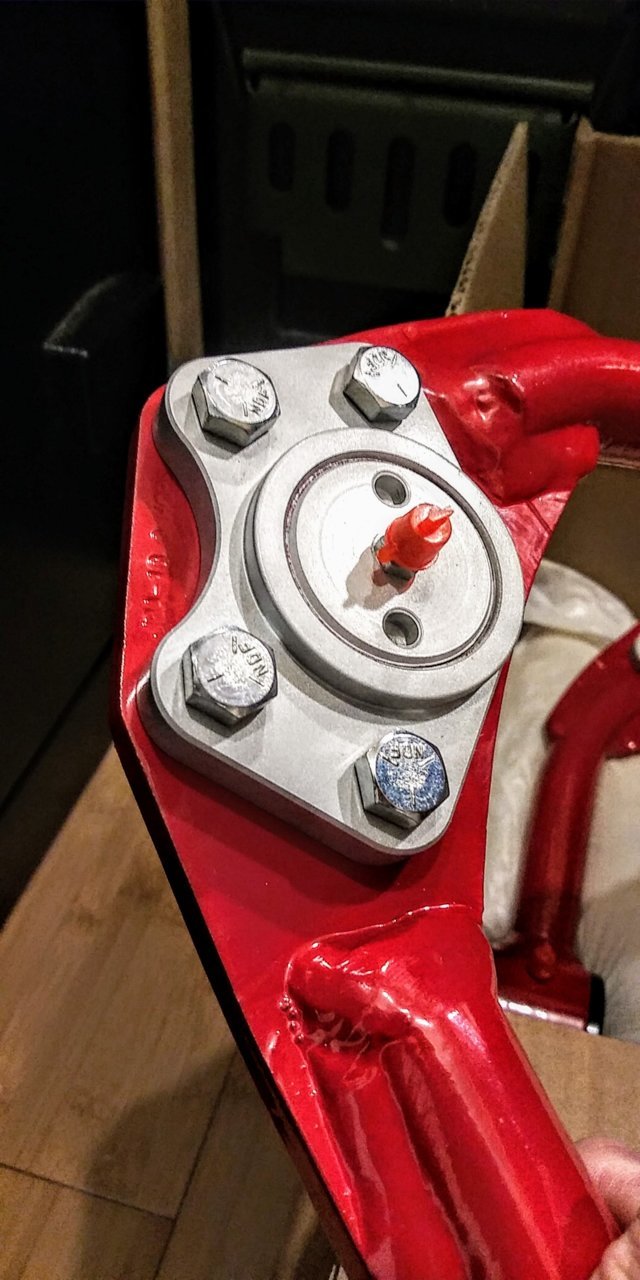

    Sorry, here's a better shot. Thought I saw somewhere in this thread where someone said they'd look yellowish. That's not the case at all with mine at all, lol. I guess they do look cerakoted.
