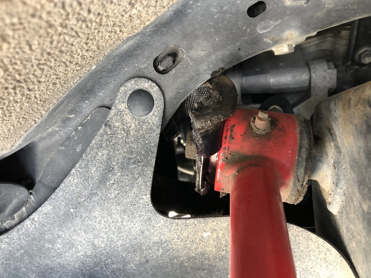

    Hey guys. Just curious about how this might play out. I have a Bushing that has almost completely walked out. The kicker is I am 6 hrs from home in Moab Utah. So will it be road worthy to get home? Or do I get to work and fix it in the parking lot?

    Yep. Youve got to loosen the bolt before you grease them.
    Is the back half still in there?

    So...I am the idiot here. This problem really doesn’t reflect JBA. I have had no issues with this until I got crazy with the grease gun. I put so much in that I pushed the bushings out. On JBAs website it says one or two pumps depending on if your just starting out or doing maintenance on the truck.
    I did get the bushing back in by backing the bolt out a bit and the help of a friend, a zip tie and a few laughs in the condos parking lot it went back in. I had to take the zerk out so the excess grease had somewhere to push out of.

    Glad to hear you got it back together. Yeah I have red 1 to 2 pumps is all you need. What I didn't know was that the bolt has to be loosened every time you grease them.?.?.

    Hmm.. good idea seeing I was able to push one out with a grease gun. I don’t think I will loosen the bolts every time I grease though. And just watch them instead. I used way to much grease and used a bit of force as well. I know better but just got dumb. I’m glad I didn’t loose the bushing all together.
