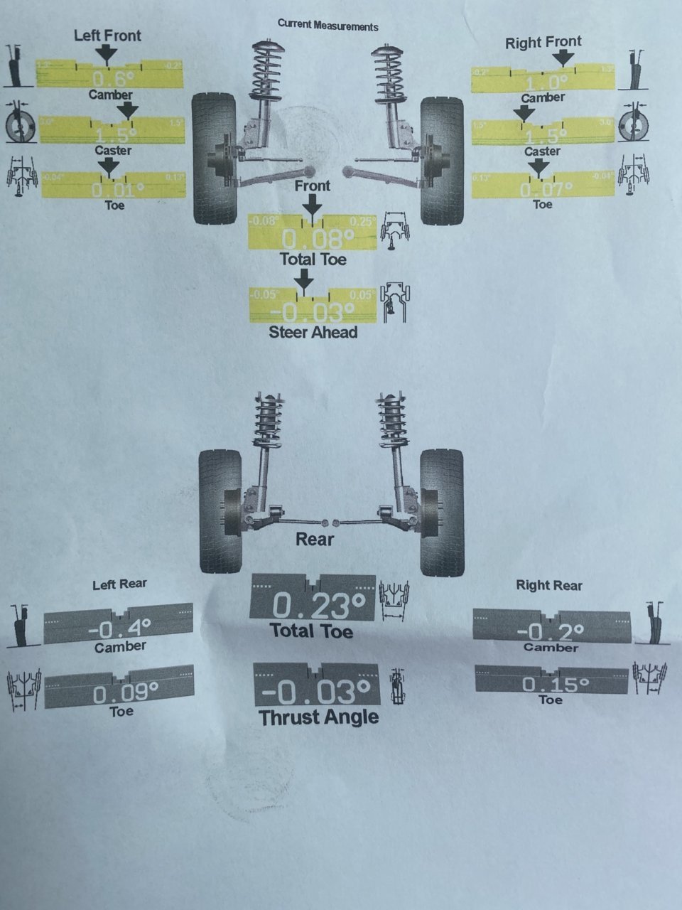

    I’ve got a pair of high caster jba’s running 2-2.5 lift
    These are the specs I got without them, obviously shops are generally morons. I’m assuming they maxed out and ima need to toss these in to get better specs? 1.5 caster seems low..

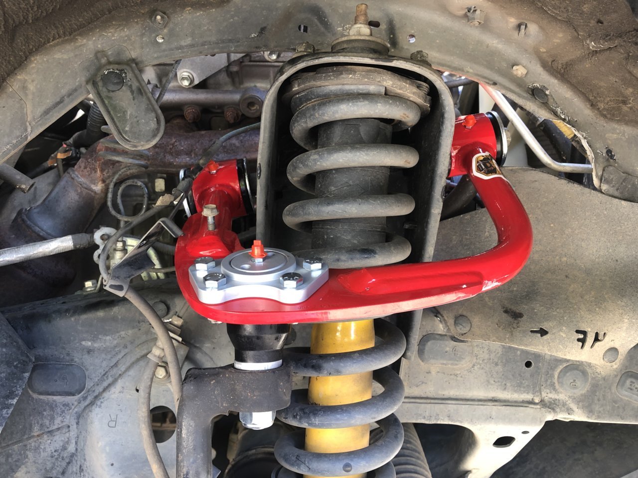

    4D821EAA-A849-4B9B-8A5D-35EBA80C9981.jpg B403218F-67A2-4BC8-9F55-856DC5B2A0DF.jpg I installed my jbas yesterday, first off every installation i’ve read and watched there isn’t a washer between the nut and the spindle, only between the ball joint and the spindle. Where does the extra washer go? Also the passenger side boot seems to be at a steeper angle than the driver side, i feel like if i pump full of grease it might leak, first pic is driver and second passenger. should i worry?

    Did you ever find an answer for this? I didn’t put that second washer on the bottom since I don’t think there are enough threads.

    I did not, i figured the washer wouldn’t make that much of a difference so i left it. Got it aligned the day after that post and it aligned fine and what not. 400 or so miles since install and everything seems fine.

    I don't think I had enough threads to fully engage the nylon on the lock nut, so I left it off. Nut seems big enough to spread over the hole just fine.
