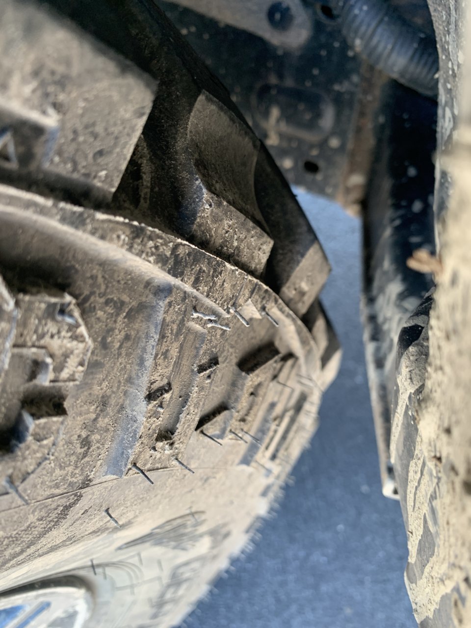

    So for anyone wondering. I have 255 skinnies installed on my stock OR rims (16x7 + 25mm), and I was rubbing on the JBA UCAs. Now, JBA states this will happen right in their description so it's my fault for not seeing this before buying them. To remedy this I installed 1.25" Spidertrax spacers. These seem to solve fitment issues. No rubbing on the UCA, and I should have enough room to clear my cab mount.
    EDIT: I am rubbing slightly on my cab mount. Going to try and get my caster a little higher, otherwise I will probably have to CMC.

    Quoting myself here. With 255 85R16s, stock OR rims (16x7 +25) and 1.25" spacers, I am clear of the UCAs, but slightly rubbing on my cab mount. I reached out Marlin about going to a different wheel (without the spacer) and he sent me this chart for that tire size:
    BFG K02s at 255/85 R16 (33.10" x 10") 10.0" wide tire:
    10.0" wide tire, if the factory wheel is 7.0" wide, you need a 4.50" backspace or smaller to clear the JBA ucas.
    10.0" wide tire, if the factory wheel is 7.5" wide, you need a 4.75" backspace or smaller to clear the JBA ucas.
    10.0" wide tire, if the factory wheel is 8.0" wide, you need a 5.00" backspace or smaller to clear the JBA ucas.
    10.0" wide tire, if the factory wheel is 8.5" wide, you need a 5.25" backspace or smaller to clear the JBA ucas.
    10.0" wide tire, if the wheel is 9" wide, you need a 5.5" backspace or smaller to clear the JBA ucas.
    10.0" wide tire, the above will have .225” tire clearance to the JBA arms at full lock of the steering wheel, with that wheel and tire setup.
    I am looking at a 16x8 wheel with 4.5" of BS. According to this chart, I should clear the UCAs, correct? A 16x8 wheel (0 offset / 4.5" of BS) is only going to move my tire .27" closer to the UCA from where it is now (16x7 +25 with 1.25" spacer), compared to moving it .78" closer to the UCA by going with the 16x8 5" BS wheel Marlin recommends. I think that quarter inch is going to be enough for me to clear my cab mount. I just want to make sure I am thinking this through correctly. Of course, I might just CMC and save a ton of money but just trying to think through all my options first.
