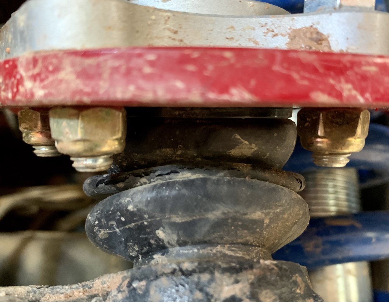

    Thats shitty

    That's not acceptable at all!
    Which grease were you using?

    I’m using red and tacky. The other sides boot looks normal. Not sure what the deal is...

    Ace hardware had washers that I could use for under the balljoint boot worked good and now its closed pretty good.

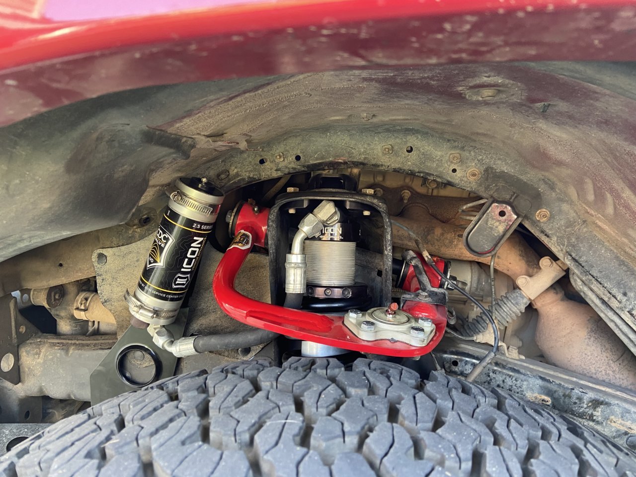

    Here’s my front setup.

    Looks like the new style boot. Maybe came with a defect of some sort?:confused: I would contact Marlin from JBA Offroad. Great customer service. I’m sure he will help you get it fixed.
    As regards to grease, I know he recommended lithium based grease. He recommended this brand to me Mobilux EP 2 Moly.
    Lucas oil Red and Tacky seems like a good grease equivalent also. So I don’t think that’s the problem.

    that’s what I was thinking. Probably just a manufacturer defect. I’m sure he will get back in touch. He sure knows how to bombard with emails and texts when you buy something. Maybe he will bombard with a solution.

    So I heard back from JBA. They’re saying there has been a bad batch from their boot manufacturer, just a few out of the lot. They gave me the option of getting a replacement boot from the same batch or waiting until they resolve the issue. I’d rather wait unless this one completely gives before then. The fact that the other side’s boot looks fine seems to confirm their suspicion.

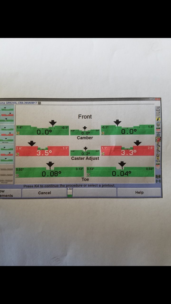

    Got mine all buttoned up last week with JBA uppers, new outer tie rod ends, and new lower control arms with all new cam bolt hardware. Headed to the alignment shop today at noon, hoping to have good numbers for the first time in 80k miles since I lifted!

    It's getting torqued down now, excited to see how it drives.
