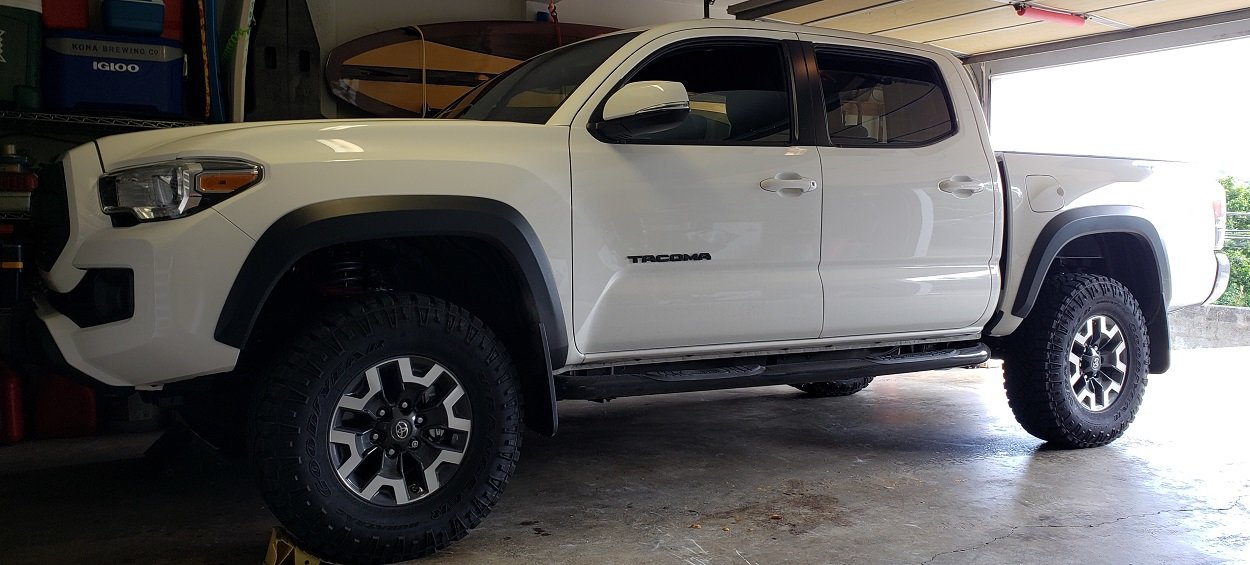

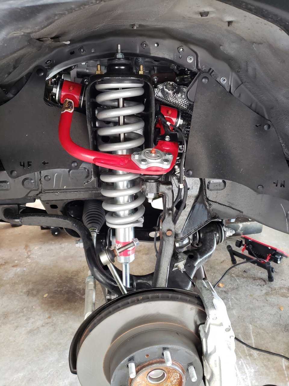

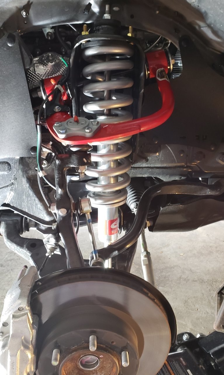

    Just finished up installing JBA UCA's and the Eibach Kit F/R with 1" block. Took me just a little under 4 hrs for the install from wheels up to wheels down.
    The UCA bolts suck big time but with a little persuasion it all went together.
    Happy to report no codes, no malfunction lights in dash for VSS, TSS, or LDS.
    Alignment scheduled for Tues.
    After a quick shake down ride
    hub to fender #'s
    DF 22 1/2 PF 22 7/8
    DR 23 3/8 PR 23 3/4
    Pretty happy with it so far.
    I now have a Pro Comp 2.25" top spacer lift avail if anyone looking for 1! Hardly used! lol

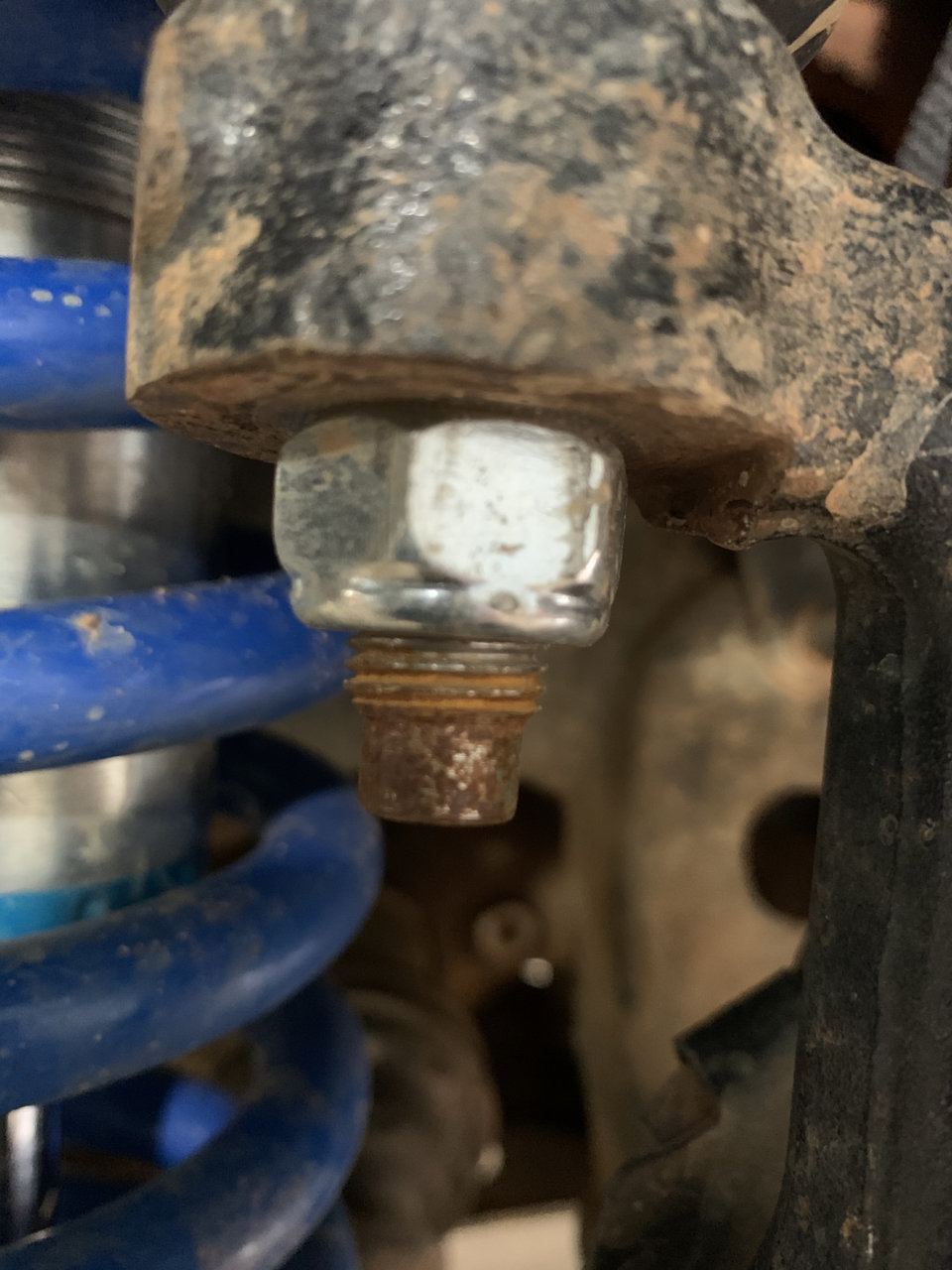

    Anyone else’s look like this? Two months old and rusty. Between that and the failing boot, I must have really gotten a bad/cheap batch of joints...anxious to hear from them on a solution.097DE7F0-A1C7-4453-9BE5-4F0A6AE35447.jpg

    wow- hope mine doesn't look like that in 2 months. Definitely hoping not normal.

    Keep an eye on your boots. I posted a picture a couple pages back. They know it’s an issue and are sorting it out from what they told me.

    So I emailed about the rust and to get an update on the boots-
    "High strength, high carbon steel rusts, it is what it is. We could make them of a more rust resistant alloy but they wouldn`t be as strong or last as long. We choose the higher strength option for it`s durability. Spray a little WD-40 etc. on it if the rust bothers you. We`re still working with the manufacturer and other companies on the boot issue. We`ve got some new prototypes in testing but no "final solution" yet. We`ll do a press release when we have a solution we`re 100% happy with."

    Its just surface rust... Not an issue. If you dont want to look at it, then youll have to look into something like fluid film

    Yeah I’m not worried about it, just surprised seeing it so fast on something new and wanted to make sure it was normal.
