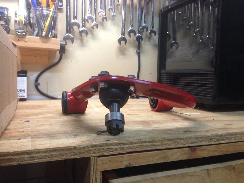

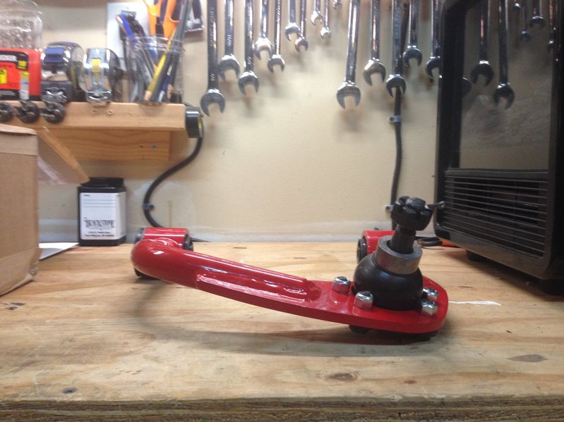

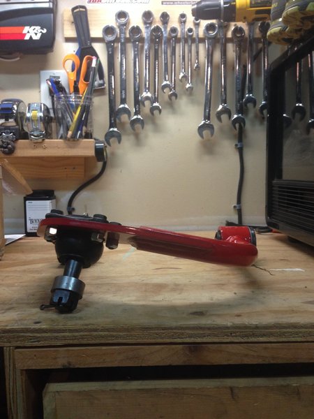

    FedEx claims arms will be delivered today so once I get home I'll snap pics of the new ones. Plan to install on Saturday so I'll snap some side by side pics of the old ones versus the new designed ones.

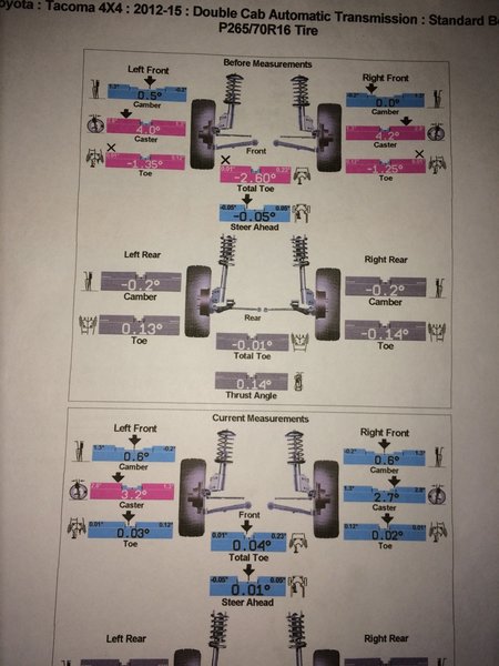

    Got a set of high caster non HD arms installed on Sunday night. Haven't got an alignment yet as I'm getting wheels and tires installed tomorrow. Going directly from Discount to Firestone to get the alignment. I will say, the truck drives like sh!t right now without the alignment. I know my caster with the stock UCAs was around 1.5. Now it just feels really loose. When I turn to the right and let go, truck does not straighten back out. Not jumping to conclusions before the alignment gets done though. Just simply stating that I have not experienced what other have of these making the truck drive great pre alignment.

    tdcampbe may have been referencing one of my earlier posts in that I said after installing the non-HD (non high caster ones too) arms that my truck drove better than it did with the OEM arms, prior to an alignment. I wouldn't say it drove great, but I immediately noticed less twitchiness in the steering.
    Anyhow, got the new non-HD, high caster arms today and as promised, here's some pics of them. Looking to install maybe on Friday as I have other plans on Sat/Sun that my wife reminded me of tonight...ugh. Anyhow, here's the pics:

    That's weird you only got 2.2° of caster from the camburgs. I went with them instead of JBA since they still hadn't worked out the caster issues when I ordered mine. My alignment tech struggled to get the caster LOW enough with my camburg ball joint arms, I ended up with 2.8°

    Mine are at 2.7 caster and 0.5 camber which after talking to Marlin he said my Camburg UCA's were fine

    Got the alignment last night. Obviously my caster could be all the way up to 4 if needed. I asked for caster to be 3 and toe and camber to be 0. I'm happy with the way the truck drives now. Would highly recommend these UCAs.

    But your Camber isn't at 0.0 it is at Positive 0.6 which from what I am told is good for lifted trucks for turning purposes. I talked to Marlin personally on the phone as I was going to buy one of his Standard High Caster sets of arms because when I just lifted my truck the full 3 inches with Camburg Ball Joint type UCA's and only got 2.7 of Caster and 0.5 Positive Camber. People told me that was a shit alignment and I'm gonna wear out my tires, and to bring it back and have him do it again. I would have went with these if all the kinks were worked out but instead I got stuck paying 600.00 for my arms, good numbers man and good for you. Even though I paid more I am comfortable now to know that my numbers are fine as well.

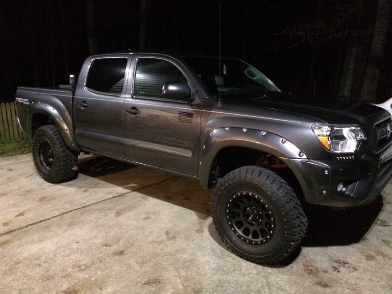

    I had to take the little front fenders off and I'm not running any other plastic even at full lock forward and reverse. BUT, this is a big one, I rub my UCAs when I'm at full lock in reverse... Idk how I feel about this or how in going to go about solving it. I really hate rubbing. It's the flat metal that the ball joint is mounted in that rubs. My wheels are a 0 offset with 4.25" backspacing.

    Actually my wheels are 4.75" backspacing so I'm a 1/4" further back than you. But these NVs are a decently common wheel ran on tacos and I've never heard of anyone having issues before.

    Regarding tdcampbe's rubbing issue: If nothing is out of whack you could always put some spacers on. I didn't want to deal with that possibility so I got my st maxx's in 255/85s bc I wanted - ~33" tire but didn't want spacers or rubbing.
