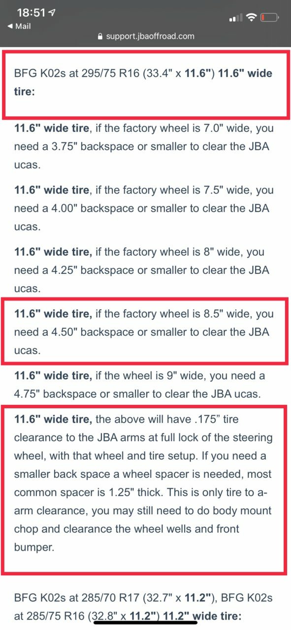

    Anybody have issues with their tires rubbing the jba arms? I’m on 35’s with 7.5 wide wheels 4.5 backspacing but I have 1.25 inch spacers. Anyway I’m pretty positive I’m rubbing the arms at full lock, any body have advice?

    Different wheels or different UCAs. I'd go with different wheel, if your 35 is a 12.5 wide, it's on the wrong rim. Go with at least an 8.5" wide wheel.

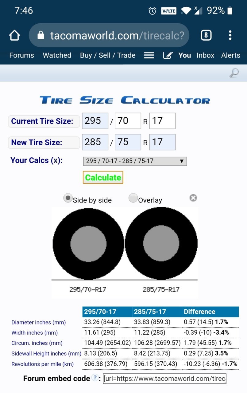

    The way this reads, my UCA will not clear the tires?
    295/70/17 on 17x8.5 0 offset 4.75bs
    I haven't mounted the tires on the wheels yet. I am also lightly debating 285/75/17.
    If it comes to it i won't object adding 1" spacers.
    Edit: i originally thought my wheels were 4.5bs but it is really 4.75bs.

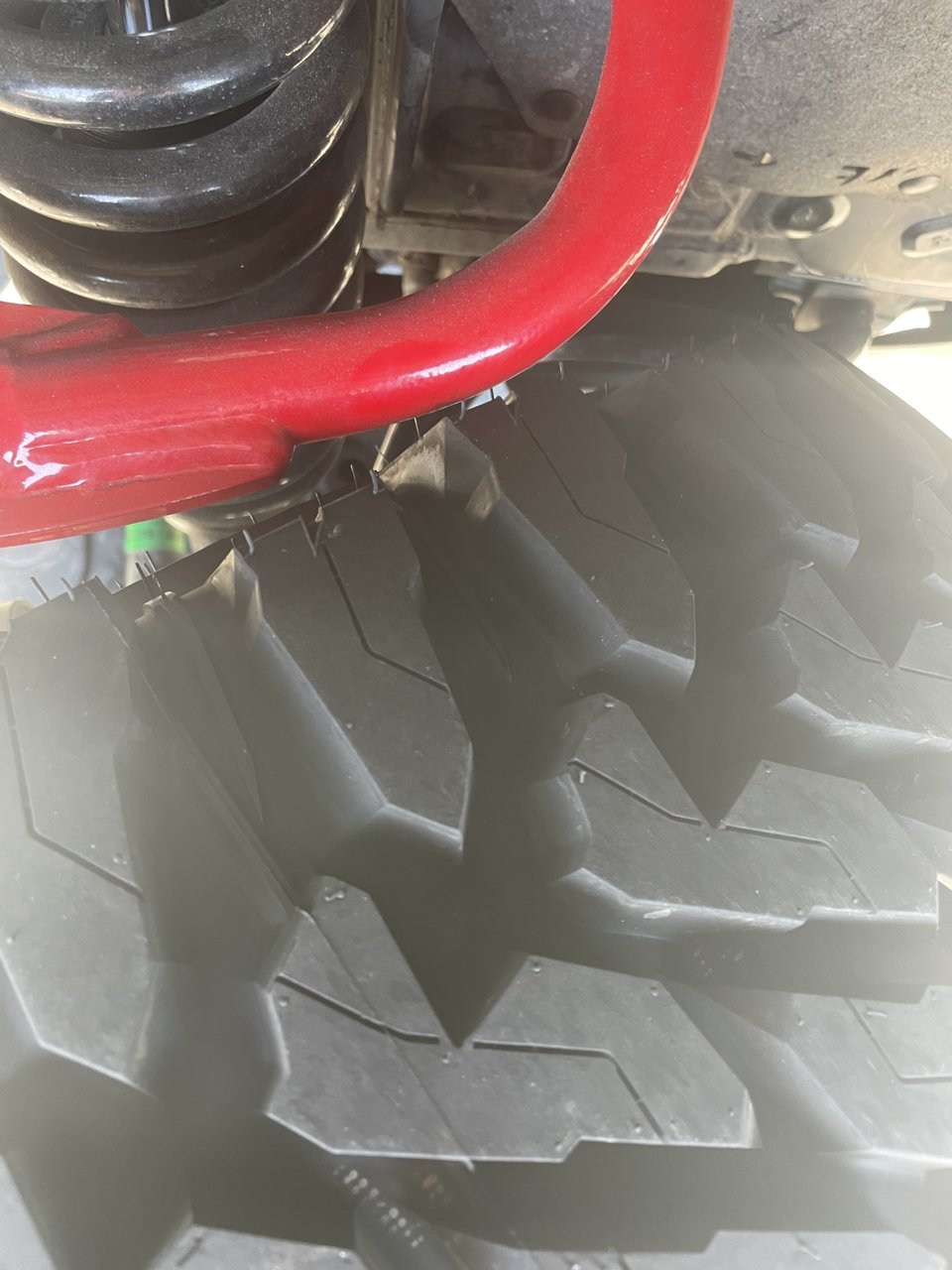

    Ya it’s definitely rubbing here

    Tire size and wheel specs?

    I’m on 35/12.5r17 with 7.5 wide wheels, 4.5 backspacing. I have 1.25 inch spacers

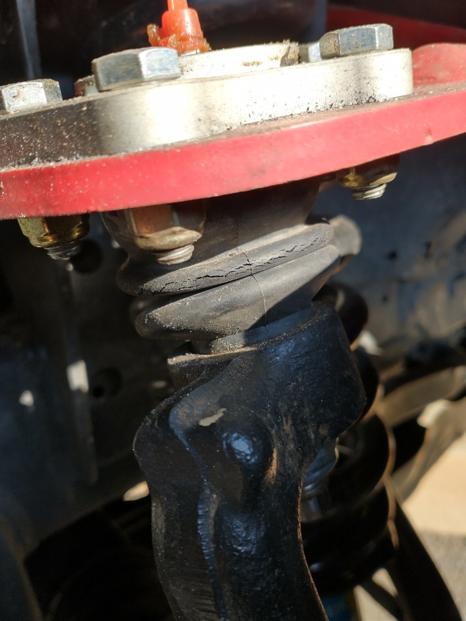

    Does anyone have any issues with boots cracking? I bought some JBA arms off here and installed them a month ago. They came with new boots b/c the others had already had holes in them from only after 4 months of use. I installed the new boots JBA sent the seller prior to me purchasing them.
    It's only been a month and my new boot is already cracking. Anyone else have this issue?
    Edit: contacted JBA and they are aware of the issue. They have a new boot design coming out in a couple weeks and will place these under warranty when they release them. Again Marlin and his team have shown they care about the people who use their products and will make sure we are taken care of.
    These are the boots i installed:
    My boot:

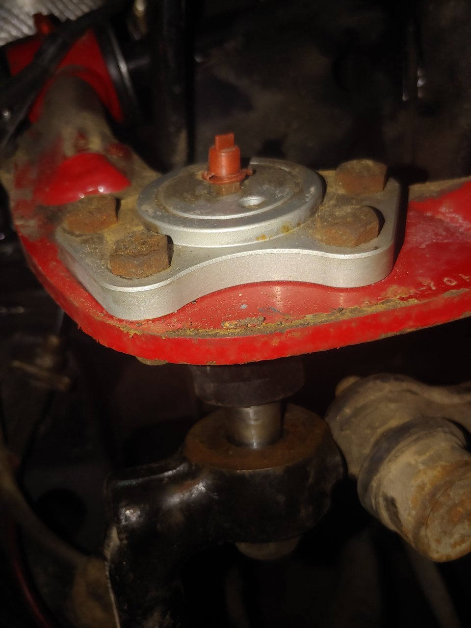

    Started a disassembly tonight of my front suspension and found my JBA UCAs to be a little bit uglier than when they went in two years ago. :oops:
    I've got powder coat flaking off on the laser cut front edges, but I don't want to take them off to fix it.
    Something I am a little bothered by, and can hopefully fix, are the rusted bolts holding the ball joint plate. All eight are completely rust covered and looking pretty gnarly.
    Anyone else replace these for a similar reason? Can I get them in something a little more resistant to corrosion, or would that compromise the strength?

    You live in Michigan, even stainless steel will rust there. If you can find grade 8 hardware in that size, that would be best. 316 stainless hardware would be 2nd best. I'd def suggest nyloc nuts and anti sieze on the threads in both applications.

    I messaged Thursday about the boots again to follow up since I was last told late February.
    “There have been some production delays with the manufacturer. We expected to have them about 2 weeks ago. As it sits now we`re expecting them in a few weeks.”
    Mine still haven’t completely failed, so I’m not too worried about it getting here any sooner.
