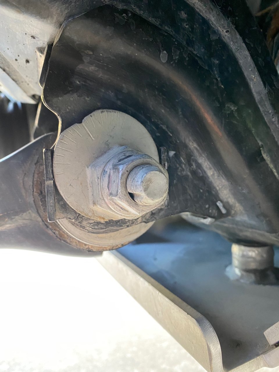

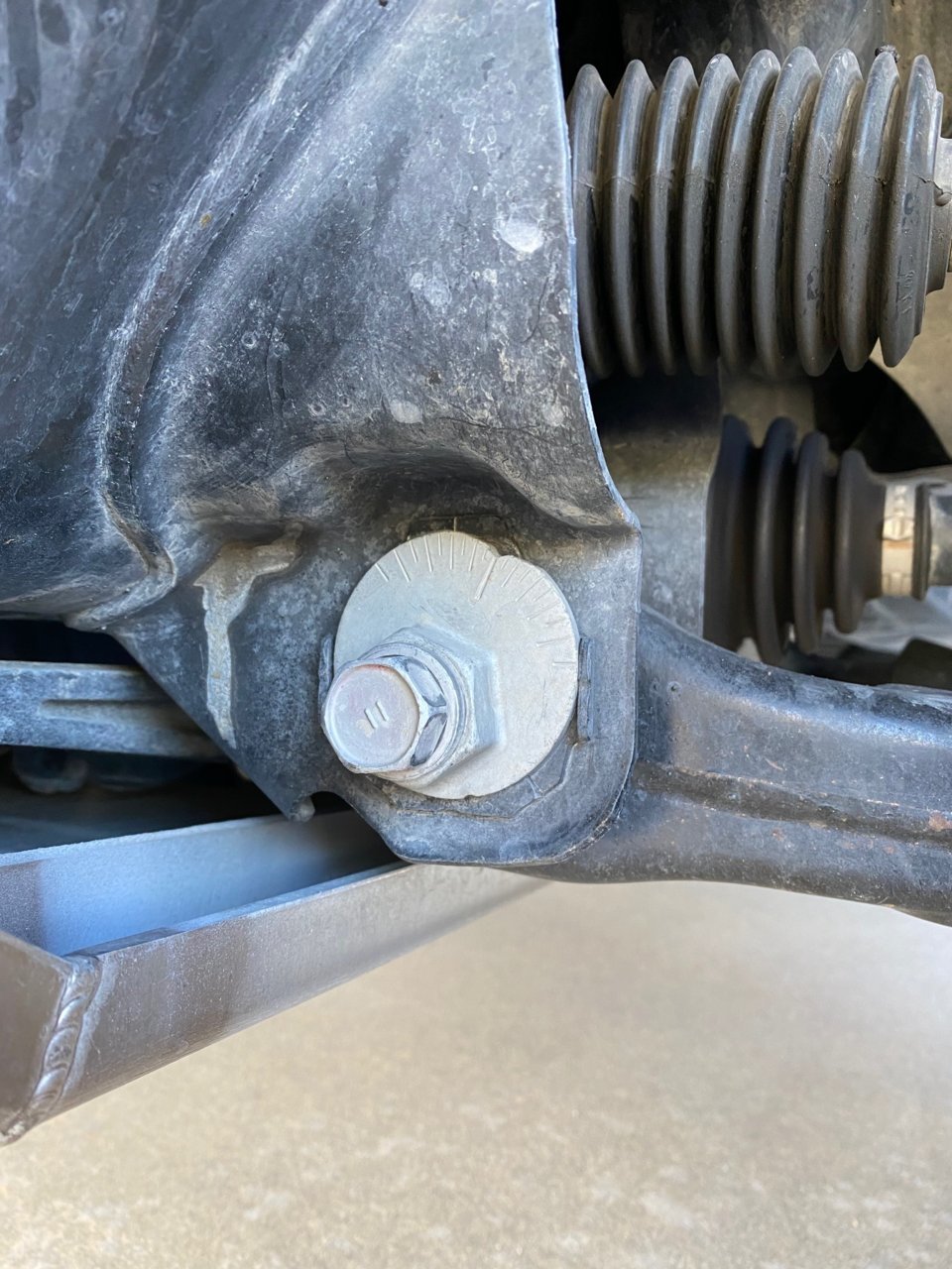

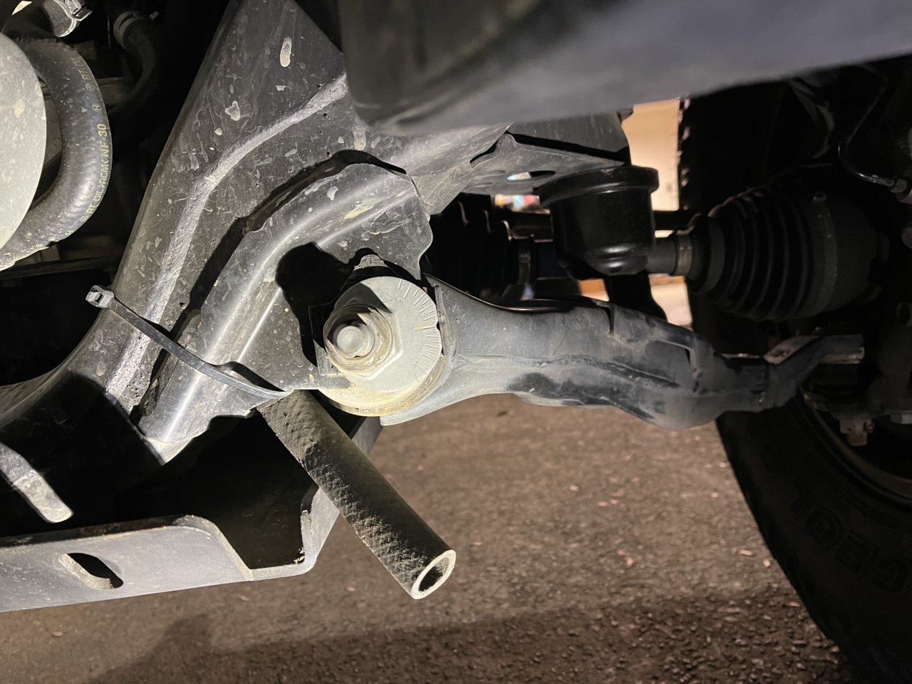

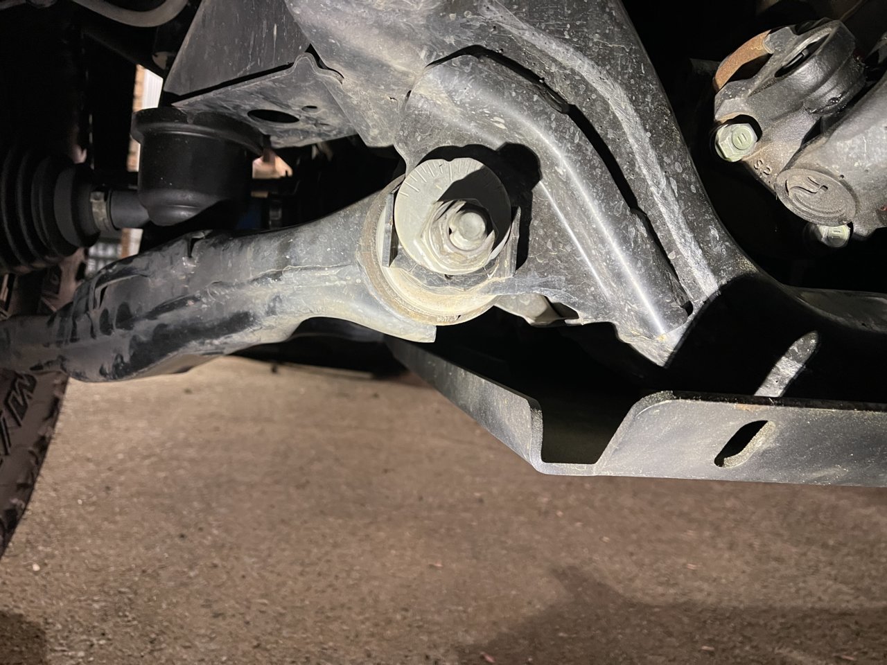

    Maybe y’all can’t help me out... I’ve been to 2 reputable alignment shops that say I’m maxed out on caster. I have the high caster jbas. According to the shop I’m set at these numbers. 5ECA27A6-6EDC-49A0-BF31-58ECD5158177.jpg
  10. Apr 2, 2021 at 8:11 PM
    #3830
    UncleRick
    UncleRick Well-Known Member
    Jun 11, 2020
    #331155
    126
    Rick
    2012 Tacoma Prerunner
    From what I understand, you have more adjustment there. Sound like your alignment shop maybe meant your caster was maxed out like, they were trying to get factory numbers and couldn't bring it down more
    I ALWAYS tell them, 0 camber, 0 toe and 3+ caster. The arms are +2 degrees built in.
    But
    Here's from DIY ALIGNMENT topic
    In a nutshell, if you want to add more camber, you would rotate both front and rear cam tabs “longer.” If you want to remove camber, you would rotate both front and rear cam tabs “shorter.”
    If you want to add more positive caster, you would rotate the front cam “shorter” and the rear cam “longer.” Ifyou want to reduce caster (not sure why anyone would do that…but whatever), you would rotate the front cam “longer” and the rear cam “shorter.”
    Toyotico likes this.

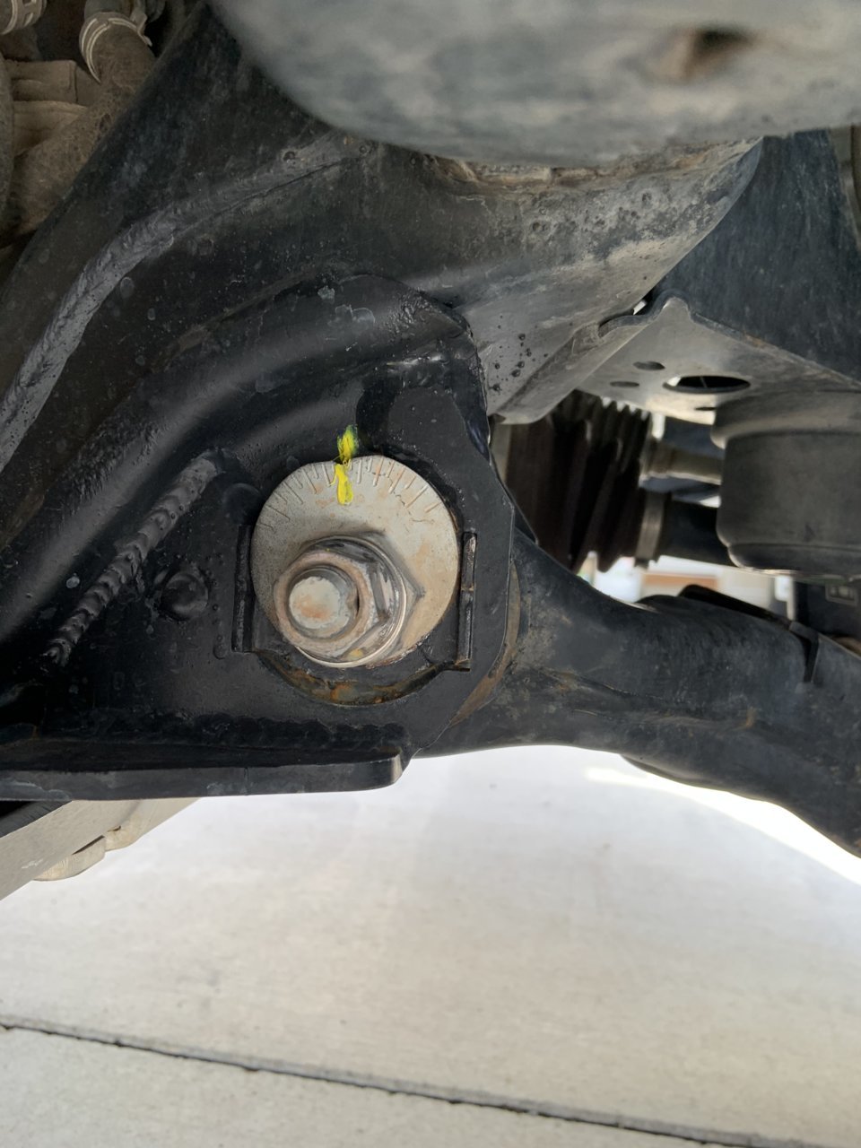

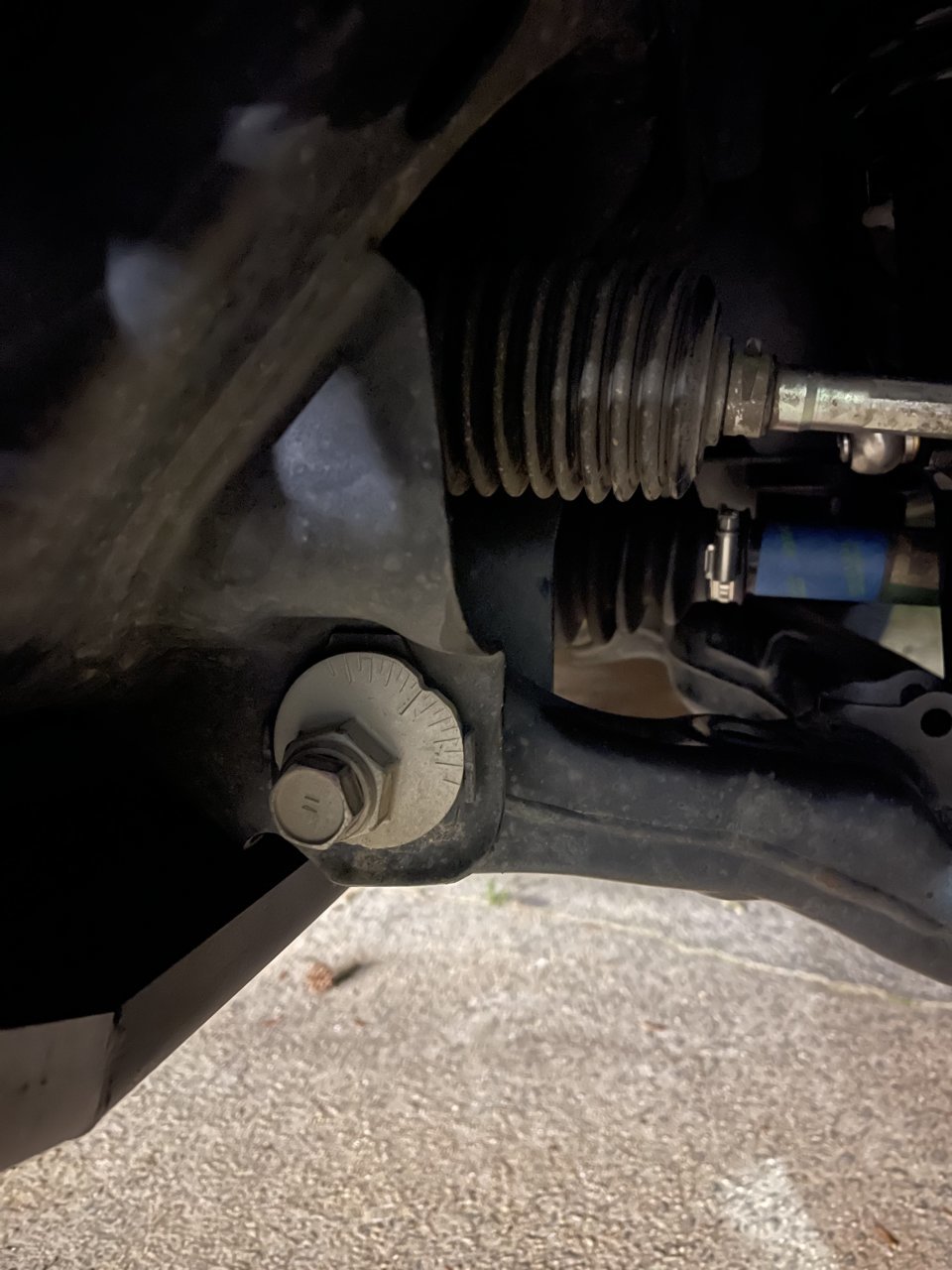

    I was slightly rubbing the CMC at fulllock, and other spots at fulllock stuffed prior to my alignment. Went to a shop that specializes in alignments in my area who has been around for 30yrs. They do old school manual alignments, so no spec sheet.
    He said caster is 4.4/4.5 Tracks straight and no rubbing. Easily clears CMC. 285/75/17s

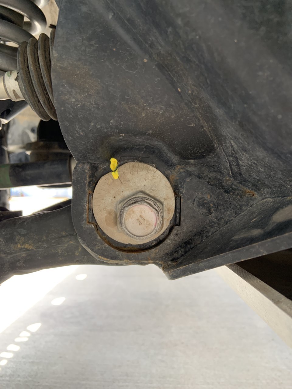

    For a baseline to actually max out caster have the rear cams pointed inboard at each other and the front cams pointed strait up.
  13. Apr 6, 2021 at 3:53 AM
    #3833
    Toyotico
    Toyotico Well-Known Member
    Nov 9, 2017
    #235532
    563
    Jonny
    Cartersville, Georgia
    2017 Silver Tacoma 4x4 dclb
    Thanks for that info. I’m going to get a third opinion this weekend and see if I can get forward off the firewall.
    Texoma[QUOTED] likes this.

    Take note that if any of the alignmnet cams are pointed down, you'll get a shit alignment

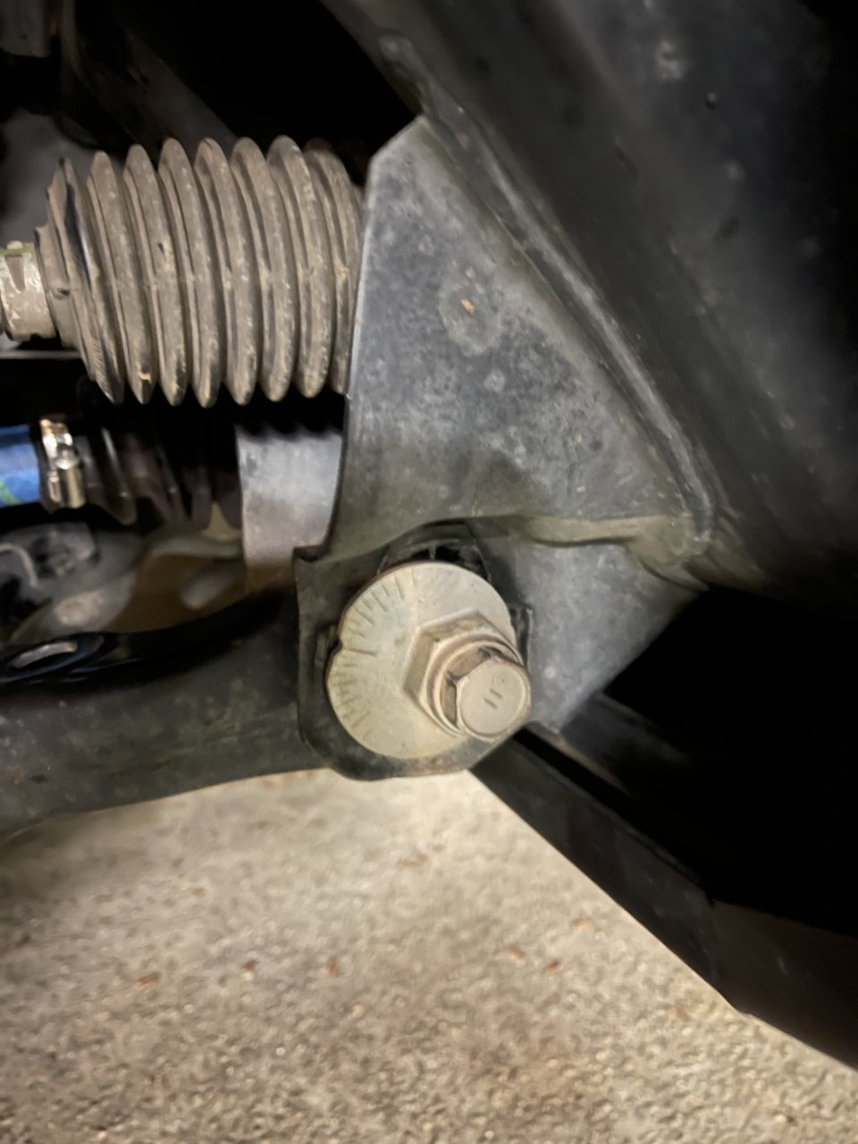

    Got them installed. I painted mine black. And JBA sent out new boots super quick.
    2inch lift
    Caster 4.1/4.0
    Camber 0.0/0.0
    Toe 0.0/0.0
    I put them on in under 2 hours after work. The passenger side (side with AC line) was a booger, but I got the bolt out and back in with help of a pry bar. Other than that getting the secound inside washer on was a pain. I centered all my alignment cams and when I brought it in, the passenger one was 0.4 off on the camber. He brought that to zero and fixed the toe.
