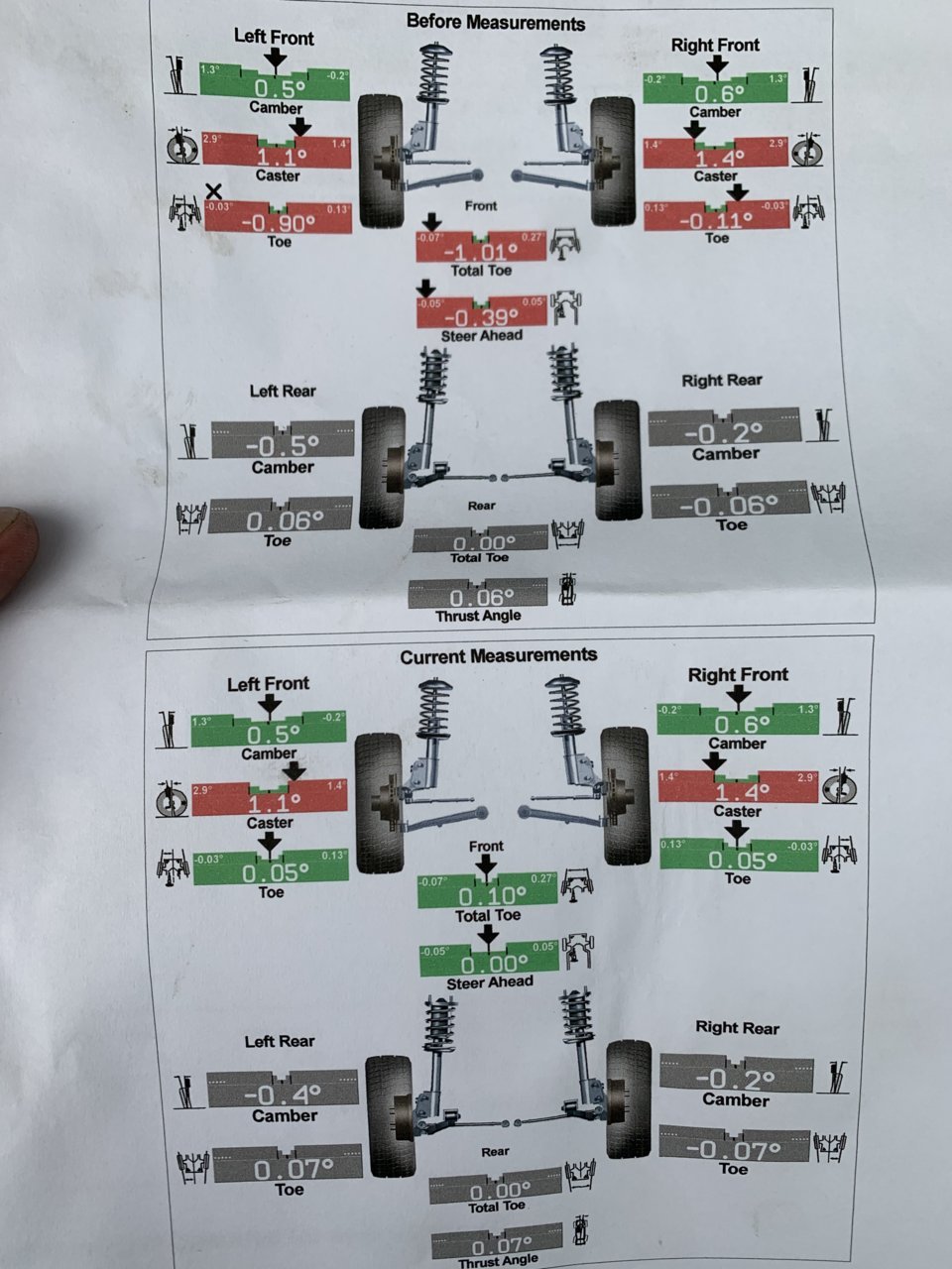

    I’m also highly considering the JBAs for my 2.5” lift with bilstein 5100 and 888 springs and will soon be with 255/80/17 nitto ridge grapplers. I too would like to know if I’ll have any clearance issues and really want my alignment to be optimal for daily driving and some off road from time to time.. here is a picture of my alignment about a month ago and literally all they fixed was toe pretty much from what I can see 3C87B849-DD4B-4626-B1C1-314EC2EB525A.jpg
