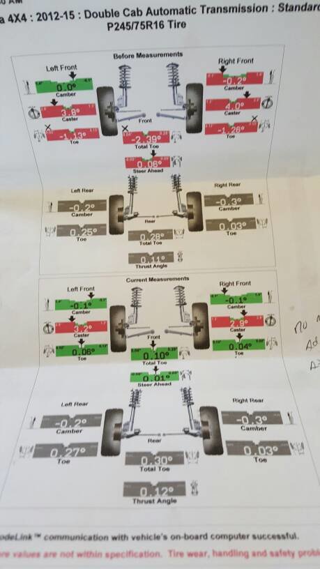

  10. Dec 6, 2015 at 10:10 AM
    #390
    Big Tea
    Big Tea WOOOOOOO!!!
    Feb 28, 2012
    #73801
    198
    Chesterfield, VA
    08 TRD Sport DCSB 4x4
    Put the new arms on yesterday and went and got an alignment this morning. Results were what I was hoping for and other than a slight pull to the right, I'm extremely happy with the results. Was told that the caster was maxed out at these numbers but I would have been happy with numbers in the 2.5 degree range. Truck will get a decent work out today and this week so if anything changes I'll post it up. Will likely take it back to get the slight pull dialed out but don't expect it to change the caster numbers dramatically, if at all.
    Crom and Blackout14 like this.

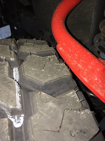

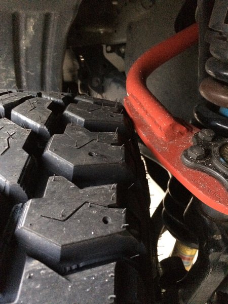

  11. Dec 6, 2015 at 10:27 AM
    #391
    tdcampbe
    tdcampbe Well-Known Member
    Sep 9, 2014
    #137900
    69
    Pics of the rub. It's really now bad at all. I'm contributing it to the beefiness of the ST Maxx's. You can see it's not actually touching here. It only touches when it is at full lock where the steeling wheel will not turn any further. When you let go of the steering wheel, they then back slightly and do not touch anymore. I believe I am going to let it ride. I have not off-roaded anything serious yet when the new wheels and tires. If it gets worse when off-roading, I will have to go a different route but I really don't think it's going to be a big enough problem to worry about.

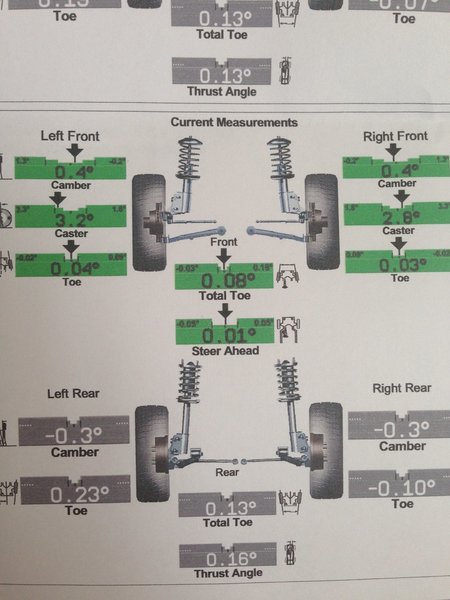

  18. Dec 13, 2015 at 8:07 AM
    #398
    EODwick
    EODwick Fire In The Hole!
    Apr 22, 2014
    #128253
    908
    Ed
    Box Elder, SD
    2013 TRD Sport
    Stuff I Think Makes it Better
    Whelp installed the new arms. Here's my numbers: edf7871949c33c649fc070be7ae55f3c_3c7ea268c099e0f4cf00717b5a37325802b4a42b.jpg
    I'm finally happy with my alignment! Truck drives so much better, there's no drift to the right or left, slight wheel wobble, though...but I'll figure that out later. These new arms are the real deal, which is great since it's the 3rd time I put JBA UCAs on my truck in the last year. Glad Marlin got the product right!
    scocar, scottalot, Crom and 3 others like this.
