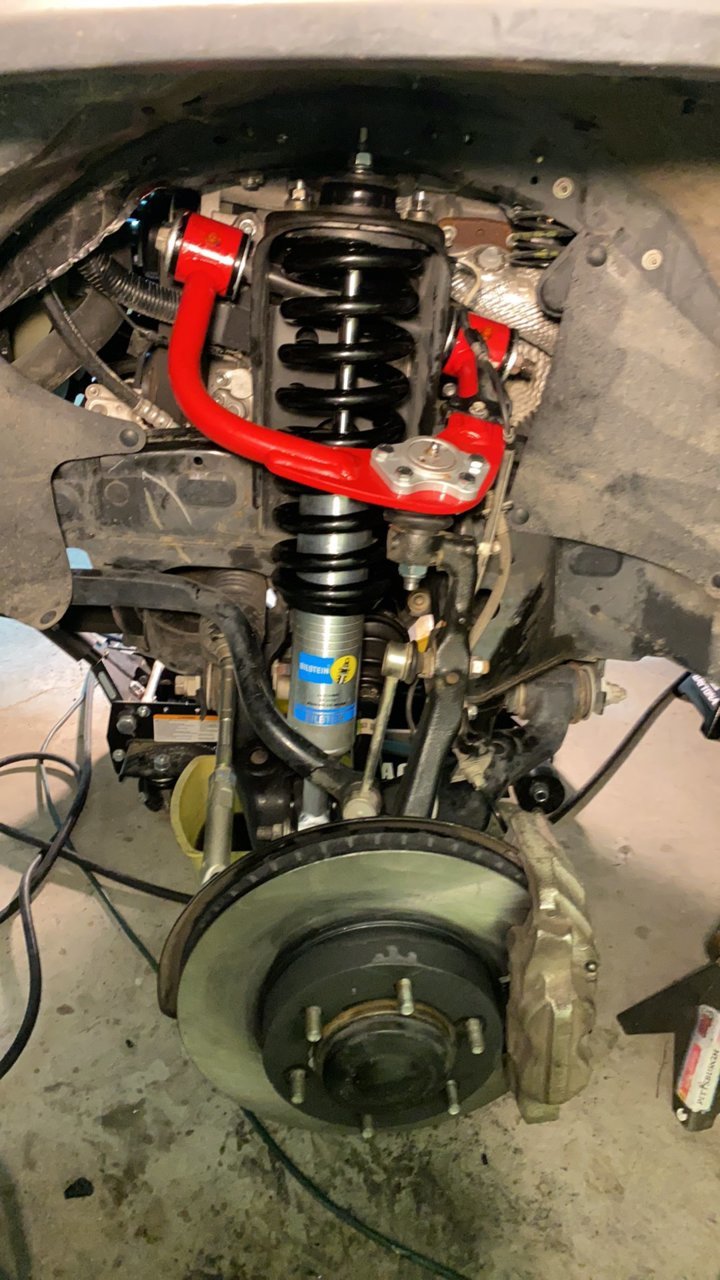

    Getting my UCA's in weren't bad at all. The hardest part was the fender mod getting the bolts out. When in doubt, AIR HAMMER!!!! Installing them I put the front washers on the bolt as I inserted it through the uca, not worrying about the back washers yet. Then with the bolt about half way through I took my pry bar and gently made space for the inside rear washer then tapped it in place. Then the bolt slides right on in and finish off with last thick washer and nut. The only real issue I had was the passenger side ABS line was extremely tight so I gathered some slack from either end and made another sleeve out of small fuel line and re-crimped it to the mounting bracket.

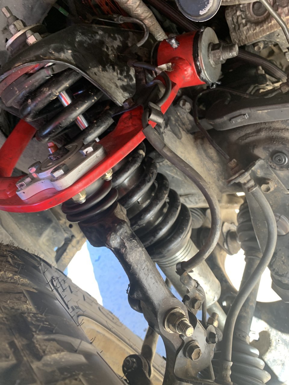

    C01C57A0-BADD-47F0-8E1B-CAC06B770D95.jpg 2808D3CC-23F2-4F0D-8197-9019C5C3A233.jpg Got mine installed today and hoping alignment tomorrow will fix my rub issue.

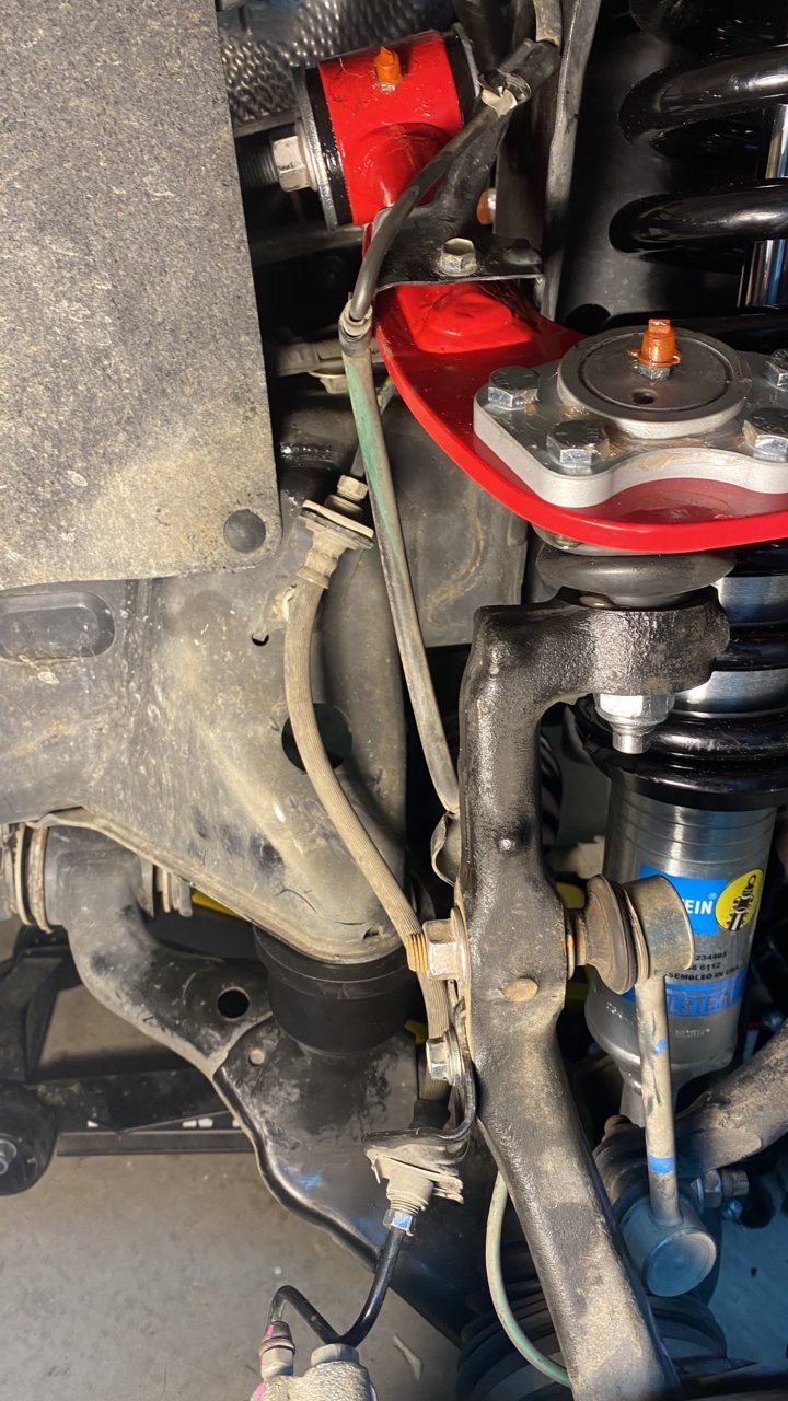

    I had my JBA UCAs installed sometime last year by a professional since I don't have the skill set or time to do it myself. I don't drive my truck much so I recently had my first oil change since having these installed. I decided I would run my first grease through it and noticed an issue that you can see below. I highlighted in red that one of the bushings popped out. I then noticed, after looking at pictures of other JBA UCA installs, that it was installed without washers on the inside of the bushing (yellow circle). Could this have been the cause of the bushing being pushed out? Also, I don't know how long this has been pushed out like this so I don't know what kind of damage it might have caused. Can anyone give me some advice on this?

    That really stinks. It needs to be done correctly or it will continue to happen. Thin washers in the middle. Big on the outside. Personally I would purchase new bushings and have them installed.

    At the very least, that shop owes you a new set of bushings. Honestly, you should get your money back AND new bushings, so you can pay a different shop to install them properly.

    Go get your money back from the jackass who charged you to install those. That's the first thing you need to do.
