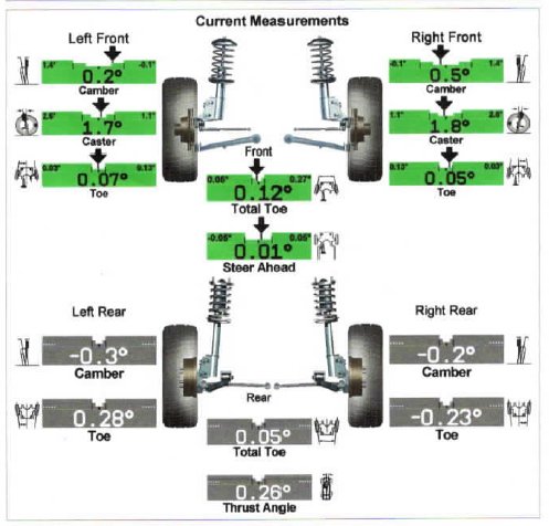

    Seeing if I could get some advice for a possible JBA control arm upgrade. I'm currently running OME 884 with Bilstien 5100 up front and Dakars with an overload removed in the rear. I've posted my latest alignment specs below.
    Would JBA UCAS be necessary to get me closer to the often recommended 3/0/0 alignment specs, or would these give too much caster for my 2-inch lift up front?

    Don't touch it and take it back to that so called "Professional" and make them correct their mistake! Make them pay every penny of the repair!

    I just got my alignment specs back after installing JBAs with a 2.5” lift. I know JBA suggests 3* of caster. Is is bad to have more than that and is the disparity between the left and right sides indicative of any issues. I am currently sitting at 5.1/6.1.

    Indirect answer: Caster is also a product of frame angle, if the truck has a rake forward/backwards caster can be different, just as it changes when you have a load in the bed or a trailer causing squat.
    More direct answer: are you noticing any pulling? Caster pulls to the lower #. Unless you are noticing any front end shimmy on the highway, it really shouldn't be an issue. I usually try for the 4.5° mark on our trucks when I align them. Your return to center at low speeds must be amazing though lol.

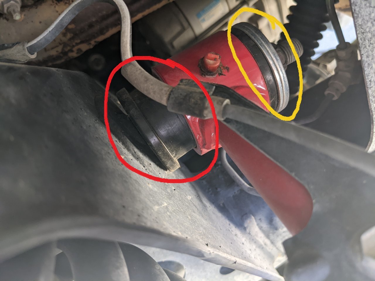

    They did not install these correctly. They should have put the thinner washers on the inside of the bushings and the thicker on the outside, not stacked. These kinds of errors are why I try to do everything myself.
    Somehow just found this thread and I've had my JBA HD's for about a year and love them. My truck is sitting @ 4.2° caster with -0.5° camber up front on both sides and I've never had a vehicle easier to drive or track straighter.
