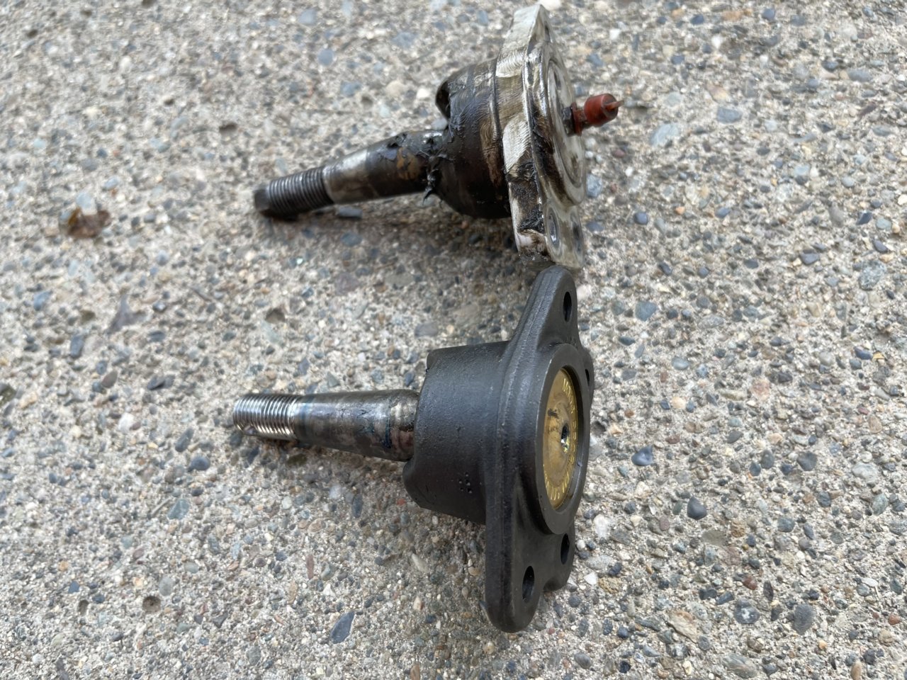

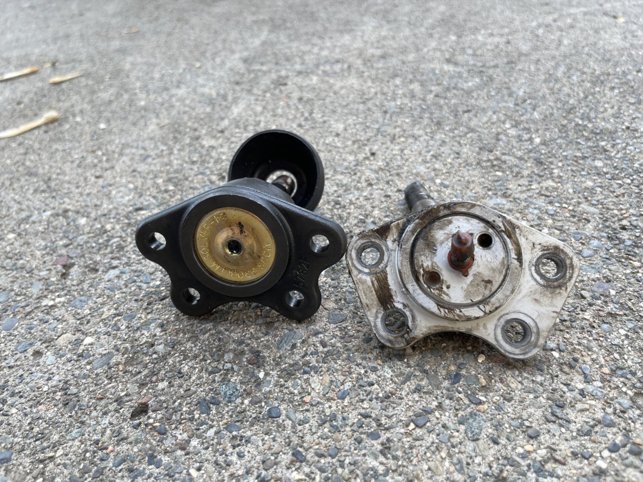

    I just thought I would share this info if someone wants to save some money….or if they break their ball joint….they can just run to autozone or whatever other auto parts store and buy a replacement right away. Instead of waiting for jba to ship you one of theirs

    @pahaf I see it's cross referenced to. A GM pickup. I wonder what an OEM GM costs compared to a JBA one.
