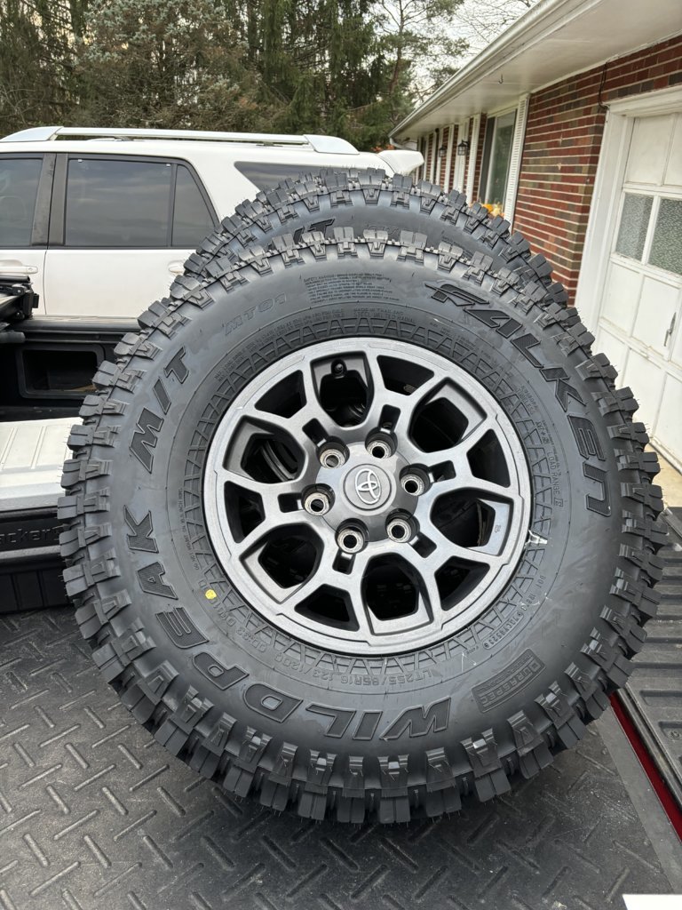

    After ordering (of course it was after) I read on their site that these UCA will not work with 255/85/16 on stock BS for a 16x7 rim. Can anyone confirm if they do or do not rub?
    I added a pic of my tire/wheel combo. I searched some other threads and found nothing concrete. TIA!

    It will work as long as you go ahead and put 1 1 /4" spider tracks Spacers on.

    Does it rub the ball joint protrusion or further up on the arm when turning?

    From what I found on TW its "TRD Dark Anthracite
    Part# PT946-35160
    Dimensions: 16x7 +25"

    From what I can tell and what's on JBA's website, its 5" backspacing?

    2013 MGM TRD 4x4 DCLB Trail Limo
    No, not with the spacers and your oem backspacing. Iran, the same type of spacers on my oem rims before I upgraded two different backspacing wheels. Works absolutely fine.

    Sorry, I meant to ask that question in this way; Without the wheel spacer, but with the JBAs installed, will it rub the ball joint or the or the arm tubing when turning? My apologies.

    Ok so 3.5" to centre of wheel (half of 7"), plus 25mm (1") offset = 4.5" backspacing. Your good.

    Without the spacer, the tire is going to hit the uca when it turns inward.

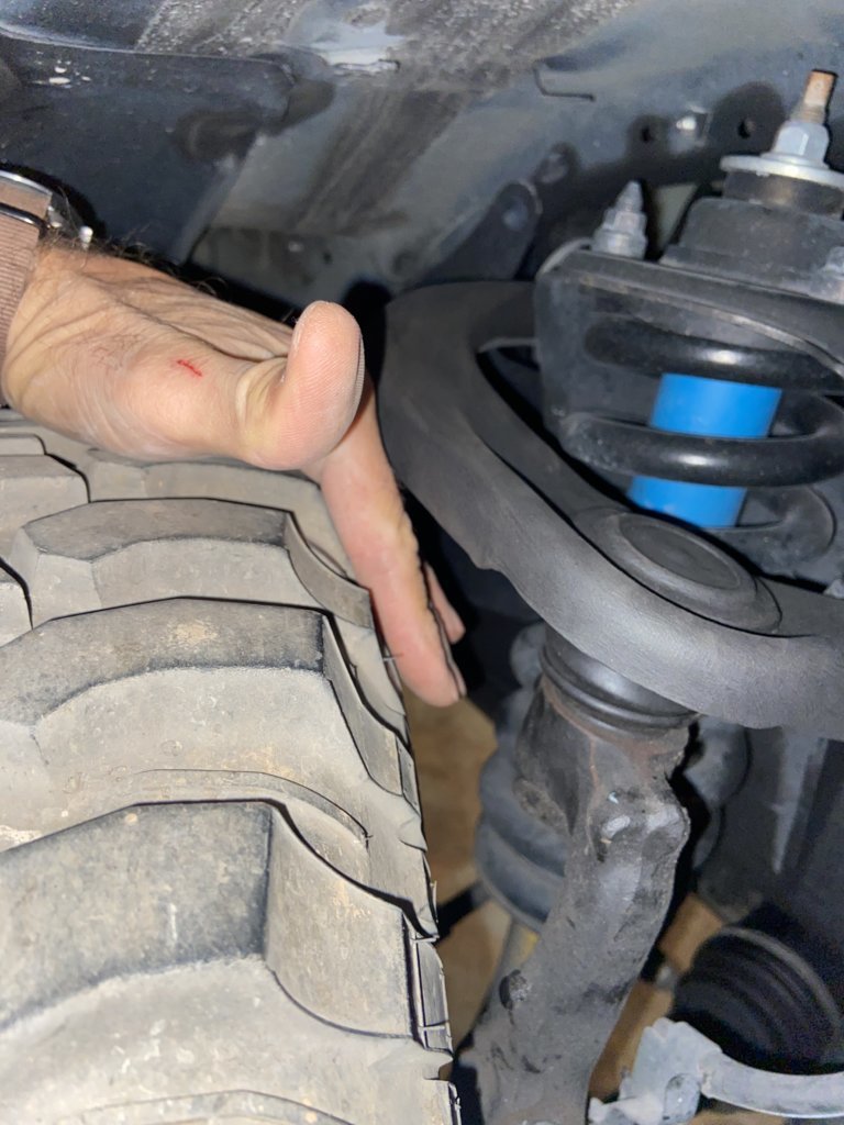

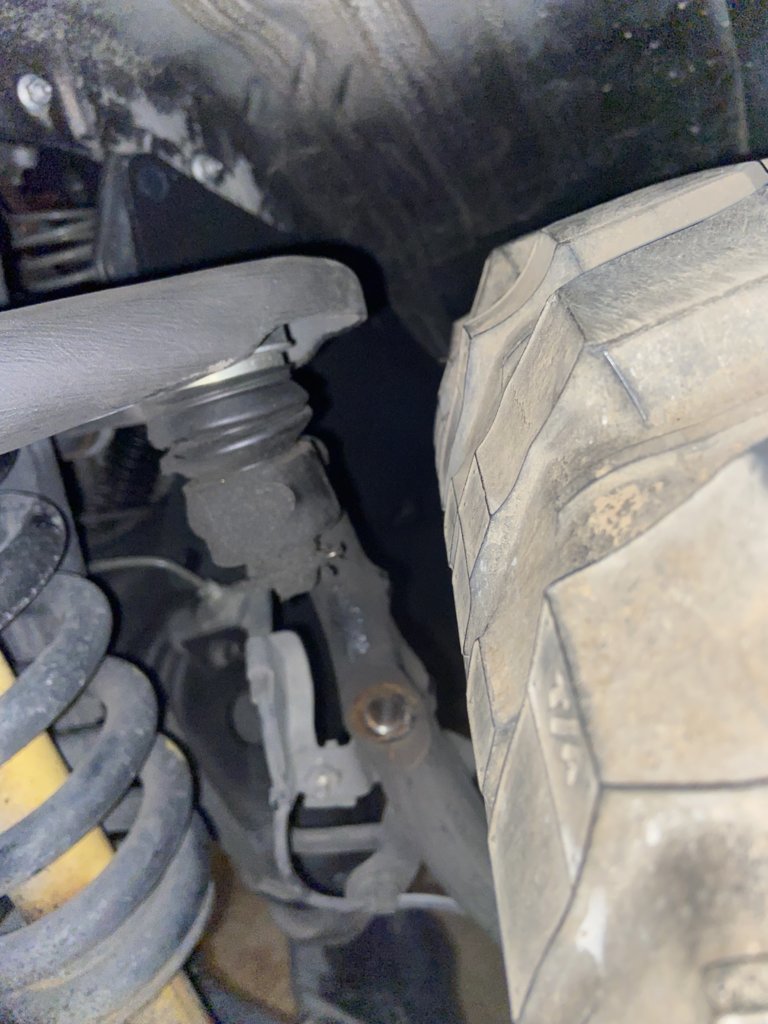

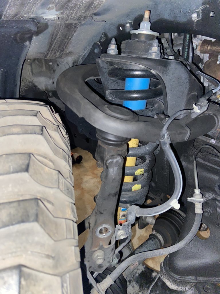

    Does the standard jba protrude more than the factory uca?
    I’m going to put front lift and new jba’s on this weekend but for reference i have an old 255/75/17 and fj 17x7.5 steelie I threw on real quick and snapped a few photos.
    I plan to run a 255/80/17 with the steelie.
    Here’s a pic stright and turned each way.
